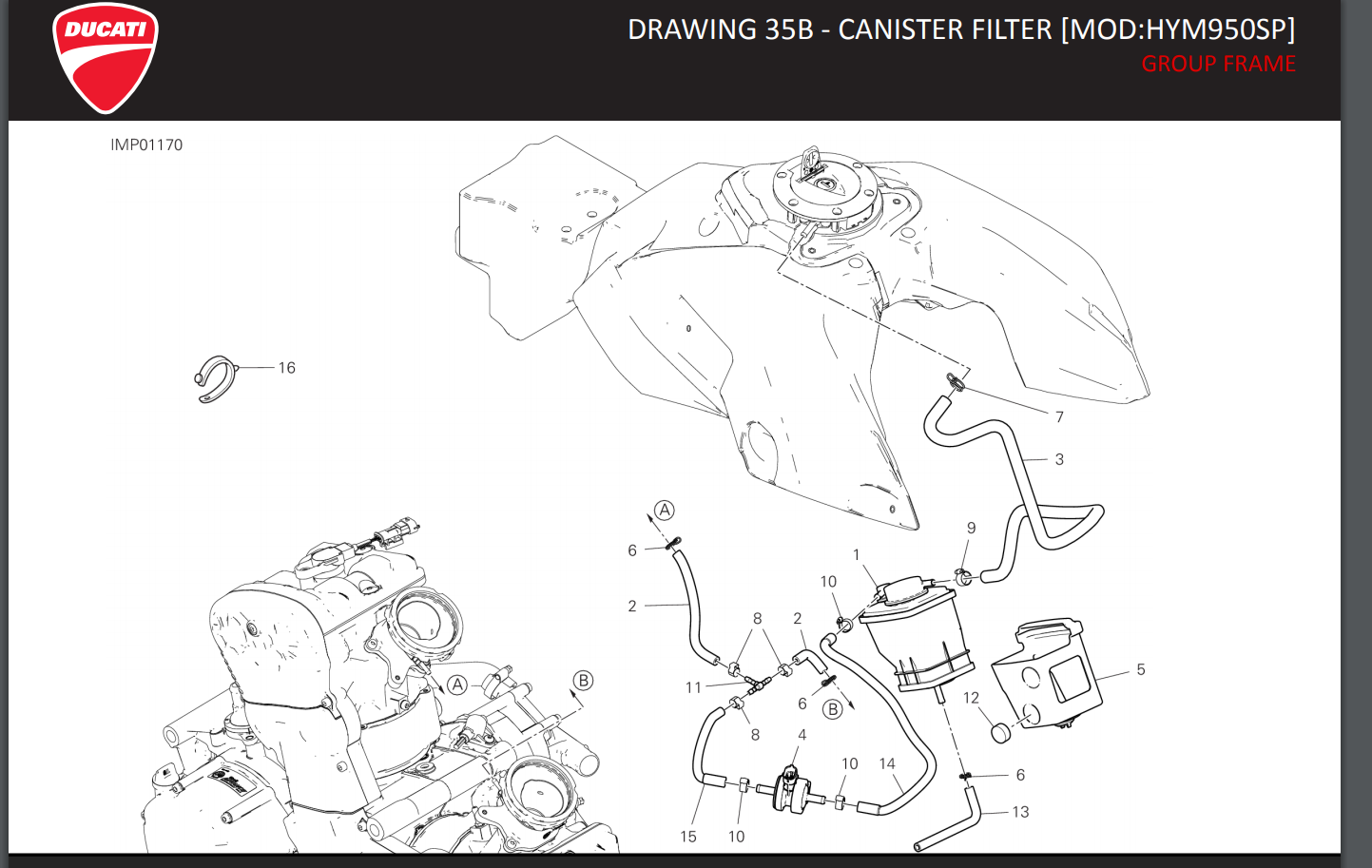

  1. Has anyone removed the charcoal evap canister on the 950?
    How do you reach it?
    It is tucked up on the left side near the tank.

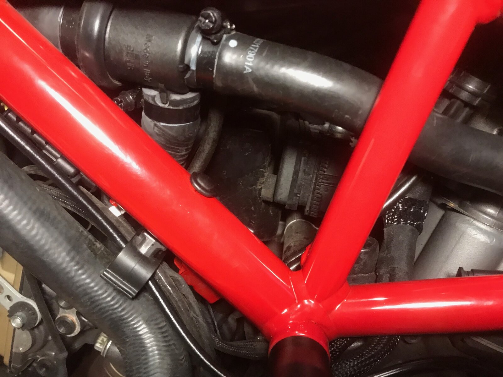

  2. Mission accomplished, sort of.
    I removed the electronic purge valve on the right side of the bike which controls the flow of fuel vapors from the evap canister.
    I cut the hose upstream of the sensor and plugged it with a screw.
    Now the throttle body ports from the evap system are sealed.
    The canister itself cannot be removed without removing the entire airbox or slicing up the actual canister. I decided to leave it where it is and cut all the hoses leading into and out of it. It is along for the ride but has nothing going in or out of it now. Will remove it someday.
    The vent/evap hose from the tank (right side) is 1/4 inch ID so I ordered some additional thin walled (stock is heavy and thick walled) rubber tubing which I will connect with a Y junction to the overflow hose (left side of the tank) and run out the bottom of the bike.
    Final piece of the job is to attach the smartmoto purge valve eliminator plug to avoid any error codes.

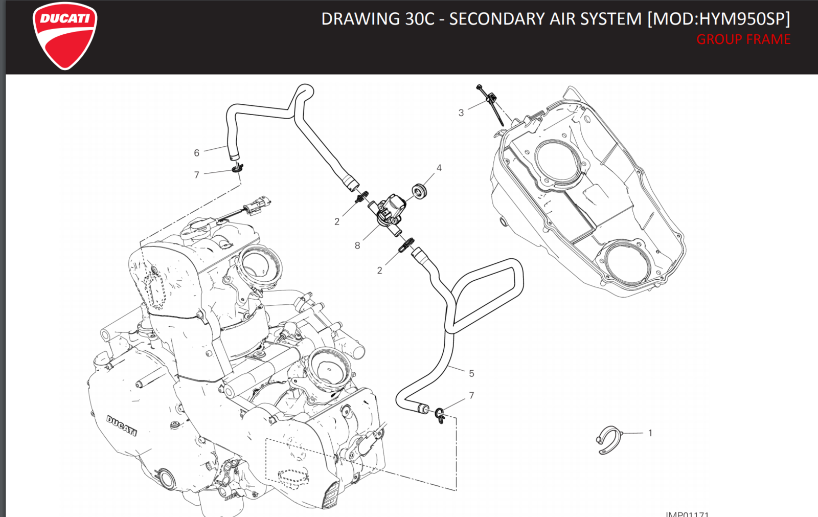

  11. FWIW, I emailed Giuseppe to ask him if he recommends bypassing the secondary air system on the Hyper when using his airbox mod and T800 map.
    His answer:
    "Keep the secondary air system"
    I suppose if I go down the dyno tune route instead of the T800 map, I will revisit removal.
  12. Good video about SAS/PAIR system effects.
