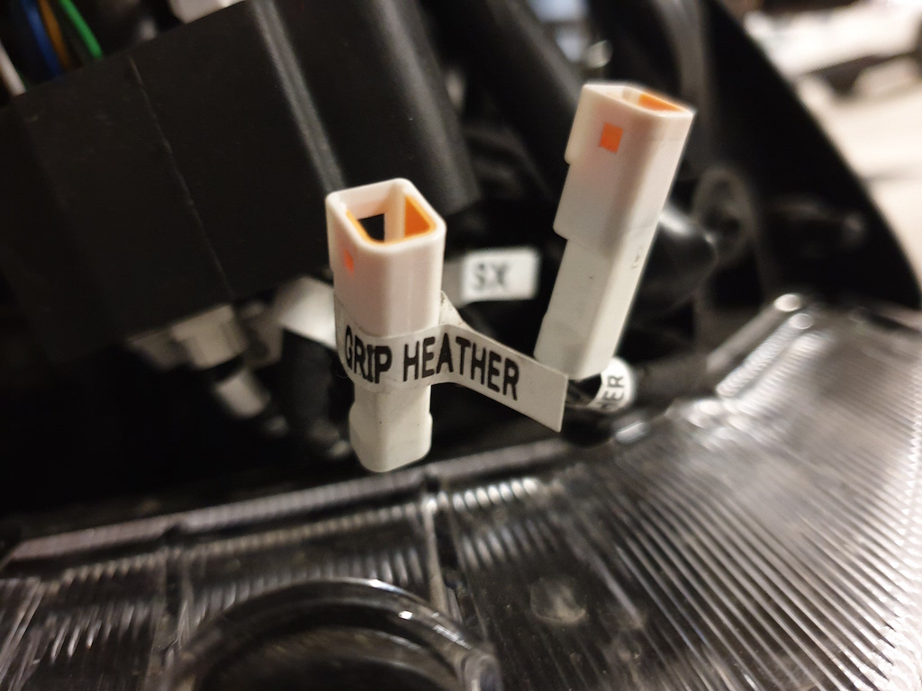

  1. Hi all. Does anyone with the Ducati Performance Heated Grip kit know where I can dig out the connectors for the grips? I spent like an hour looking around under the gas tank and all over for them but no luck. Any help would be very much appreciated!

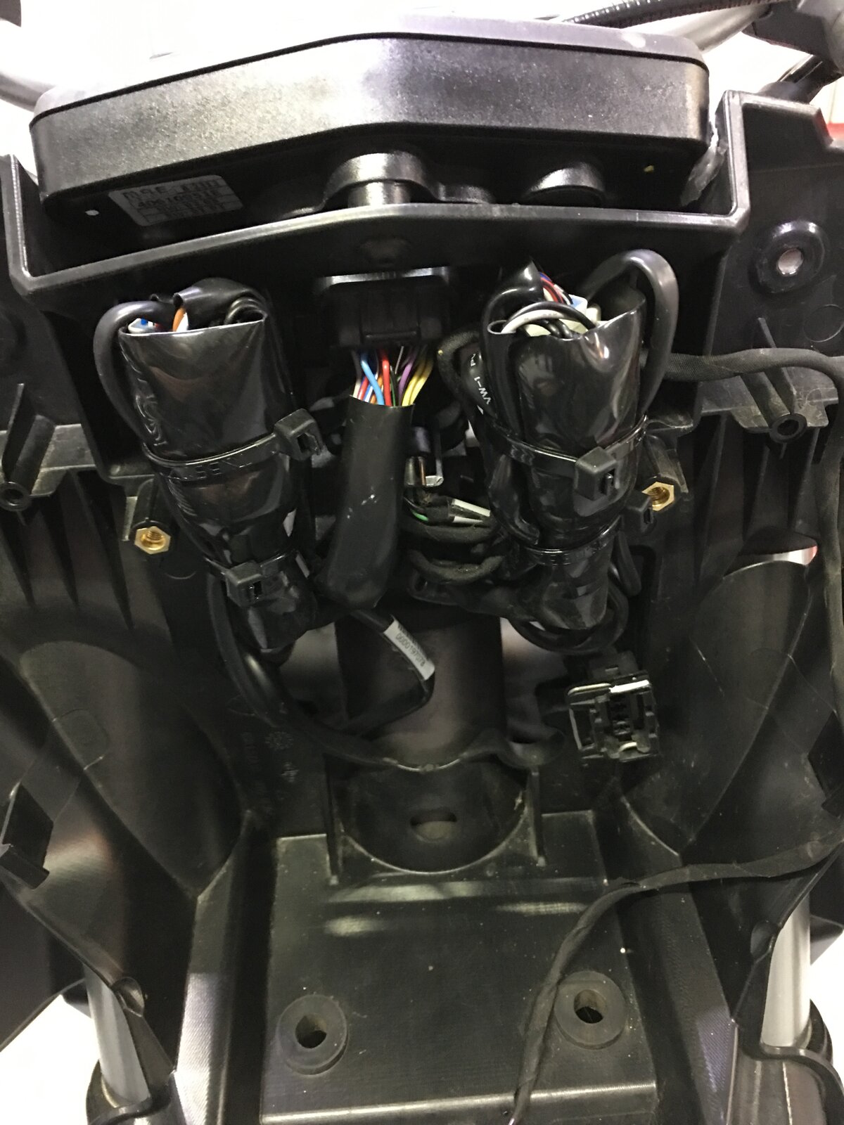

  2. I have an 821, wired them in myself and the connectors were behind the headlight, in two cable tied up bundles of wires. (Mudguard off, headlight out). The dealer had to enable them to work through the dash with their diagnostic equipment (for a pack of biscuits). :yum
    Not sure if your model is the same, but hard to think that it could be much different.
  3. I hope you paid in Chocolate Hob Nobs..
  4. Thanks for that. I was thinking it may be back there too but the wires on the grips themselves are so long i figured they made them just long enough to reach the plugs but who knows with Ducati....
  5. Thanks Robarano!!
    Also it seems someone at Ducati doesn't know how to spell.

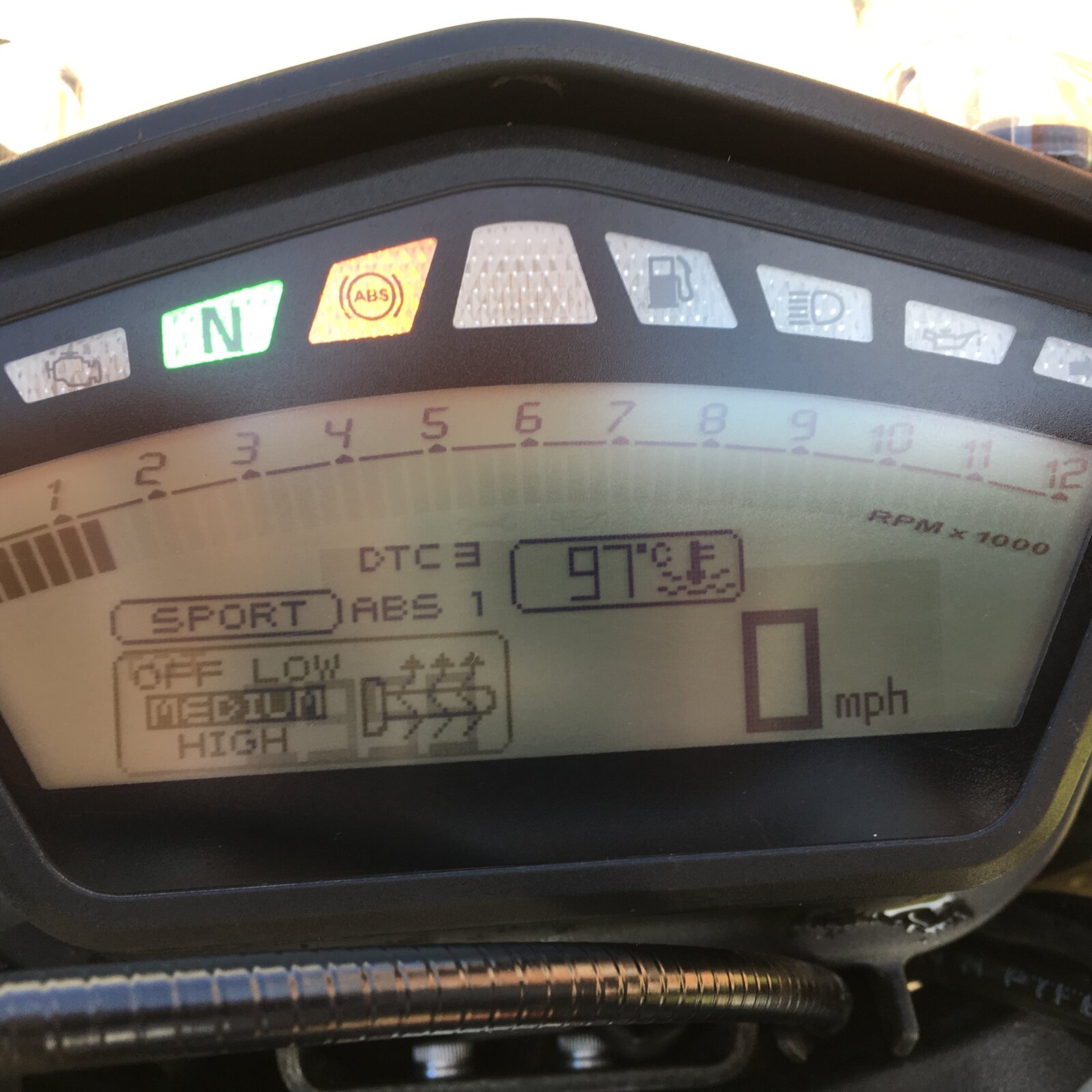

  6. Did they need enabling for the 950 as I’ve just got in from a chilly ride and hands are white so thinking this might be needed for me to ride through the winter
  7. They need fitting and enabling
    But not sure how strong they are... maybe better with Keis Heated Gloves or similar
  8. I got mine with the heated grips. They work fantastic. Id get dealer to fit them as they need the laptop on the bike to activate them on the dash. And ita not juat a bit of rubber They change the whole throttle tube & mechanism
