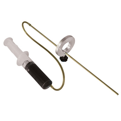

    One of the best tools I bought was for getting the right air gap at the top of the fork after refilling....
  6. What tool is that then?
    Sent from my SM-P900 using Tapatalk
  7. Set the ring to tip at the desired air gap size....overfill fork with oil....pull the syringe and when the oil gets lower and reaches the tip of the tube it won't suck no more out.....perfect size air gap

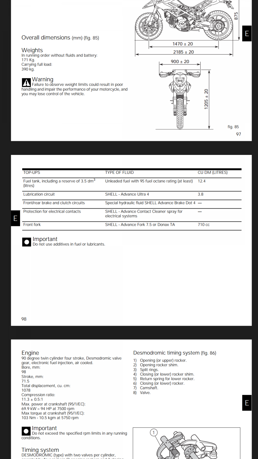

  13. It should say in the workshop manual which fork oil they recommend.....
    Edit....Just found this page in the Evo SP user manual........
