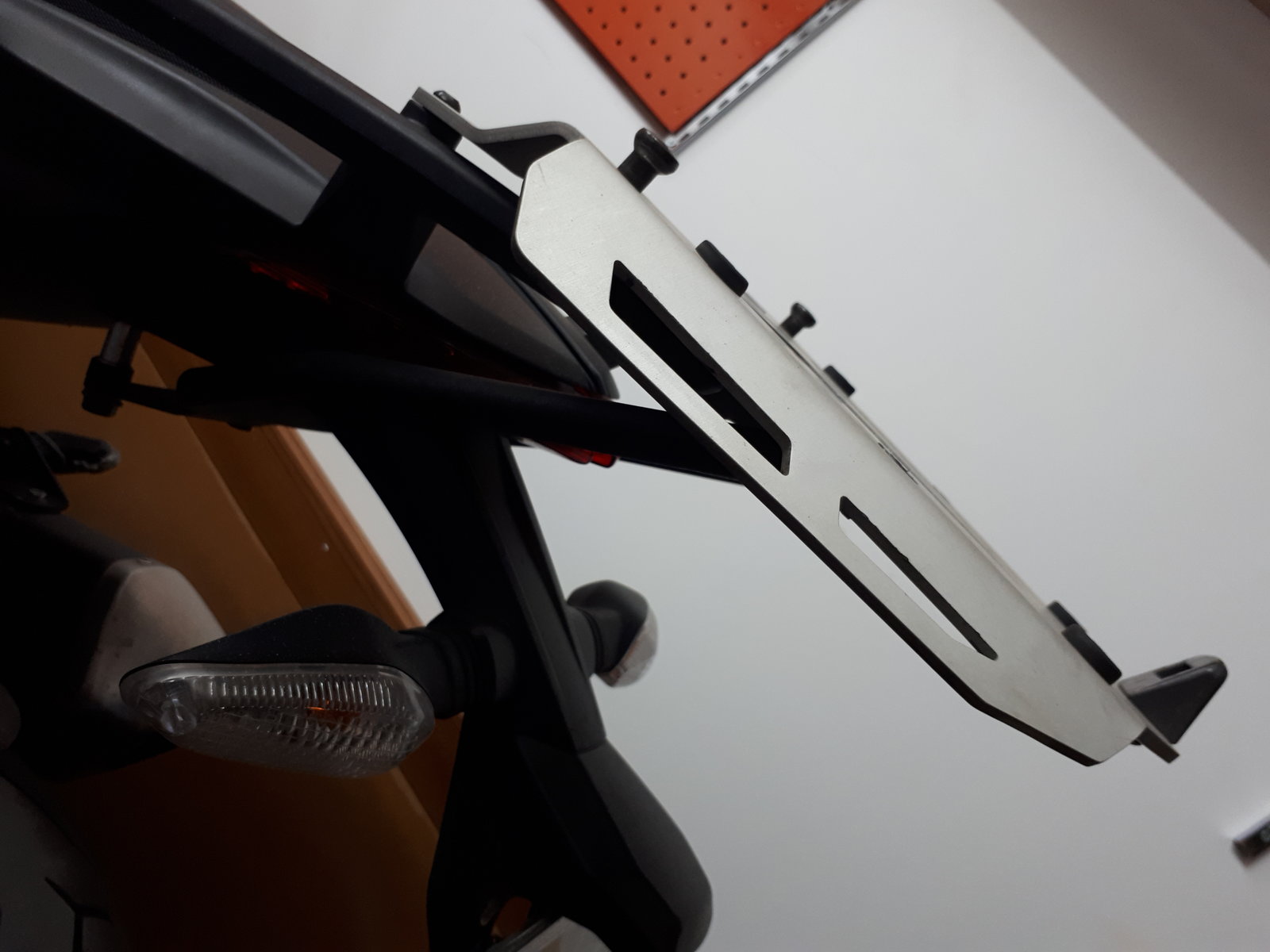

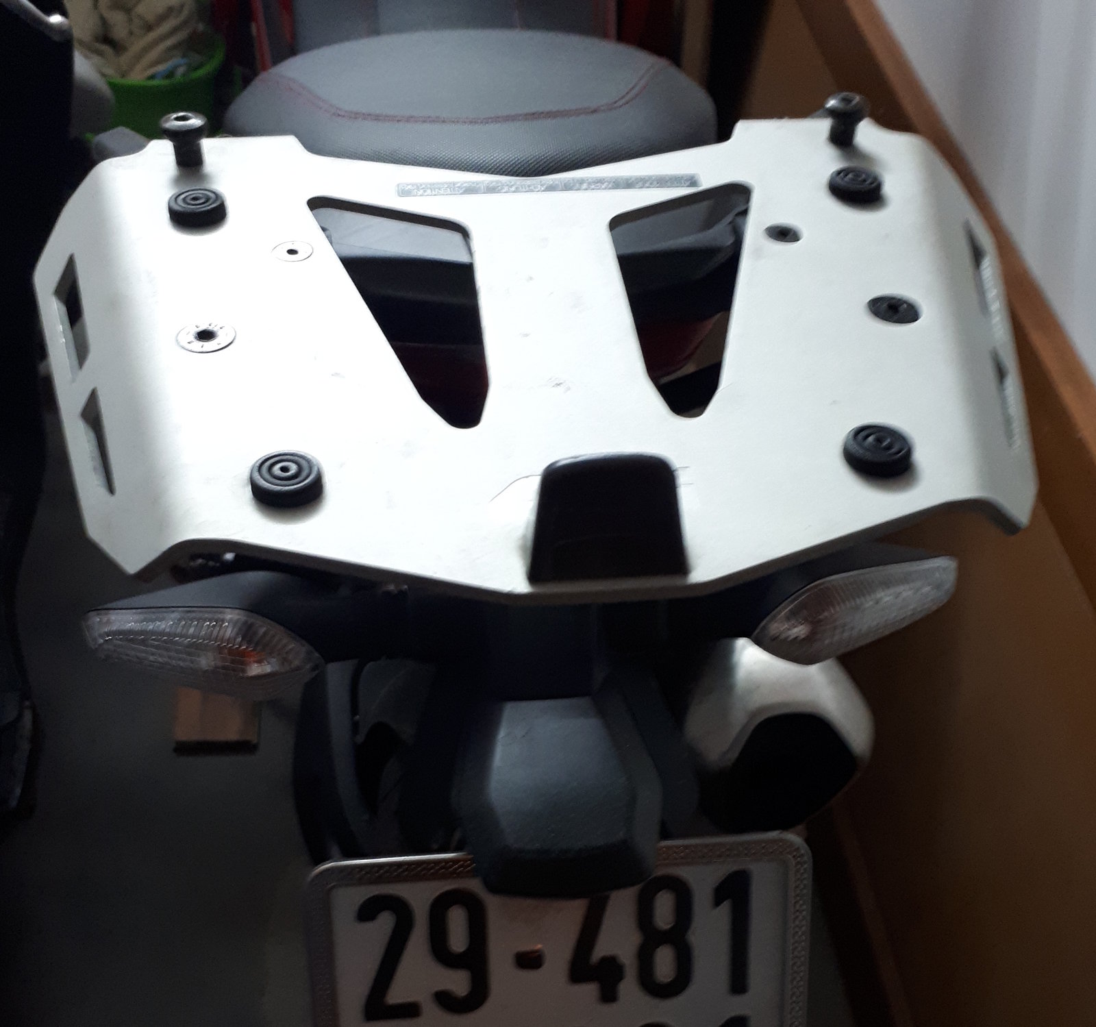

  6. Hi polyniki,
    As I said, I am not sure that this helps as you have the earlier generation machine and the tail is quite different, but it shows what is typically available.

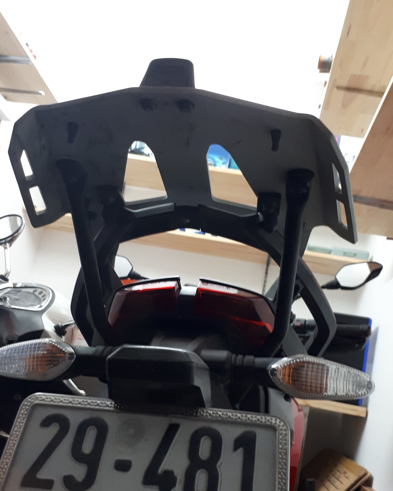

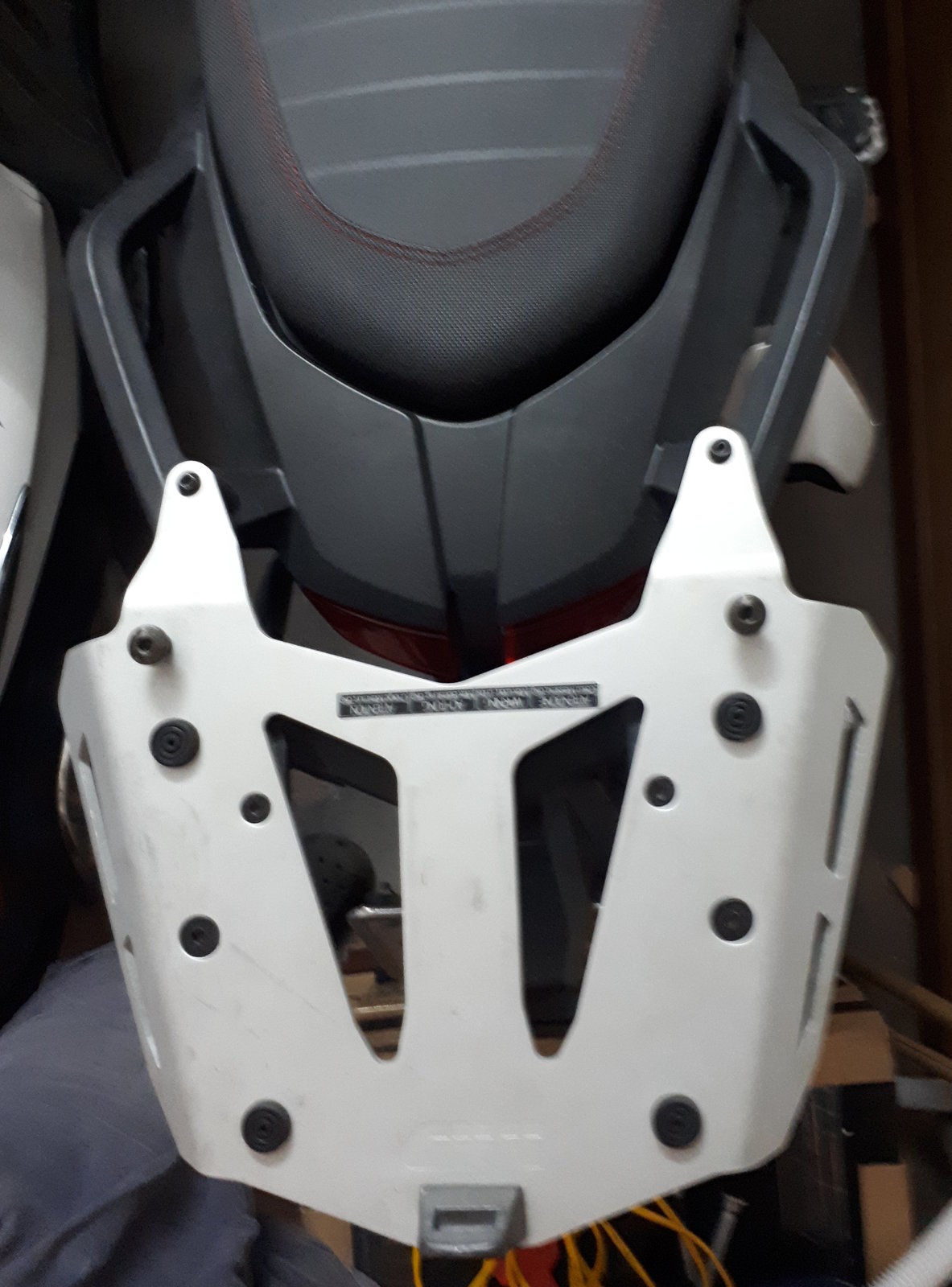

    Above you can see the passenger grab rail installed on the tail and the plate goes on top of that.
    What is important is the support that goes under the bracket and bolts to the subframe. The two pictures above. I had to make up two spacers as the geometry on the Hyperstrada and the Hpermotard is slightly different and I did not want to bend the support arms and damage the paintwork.

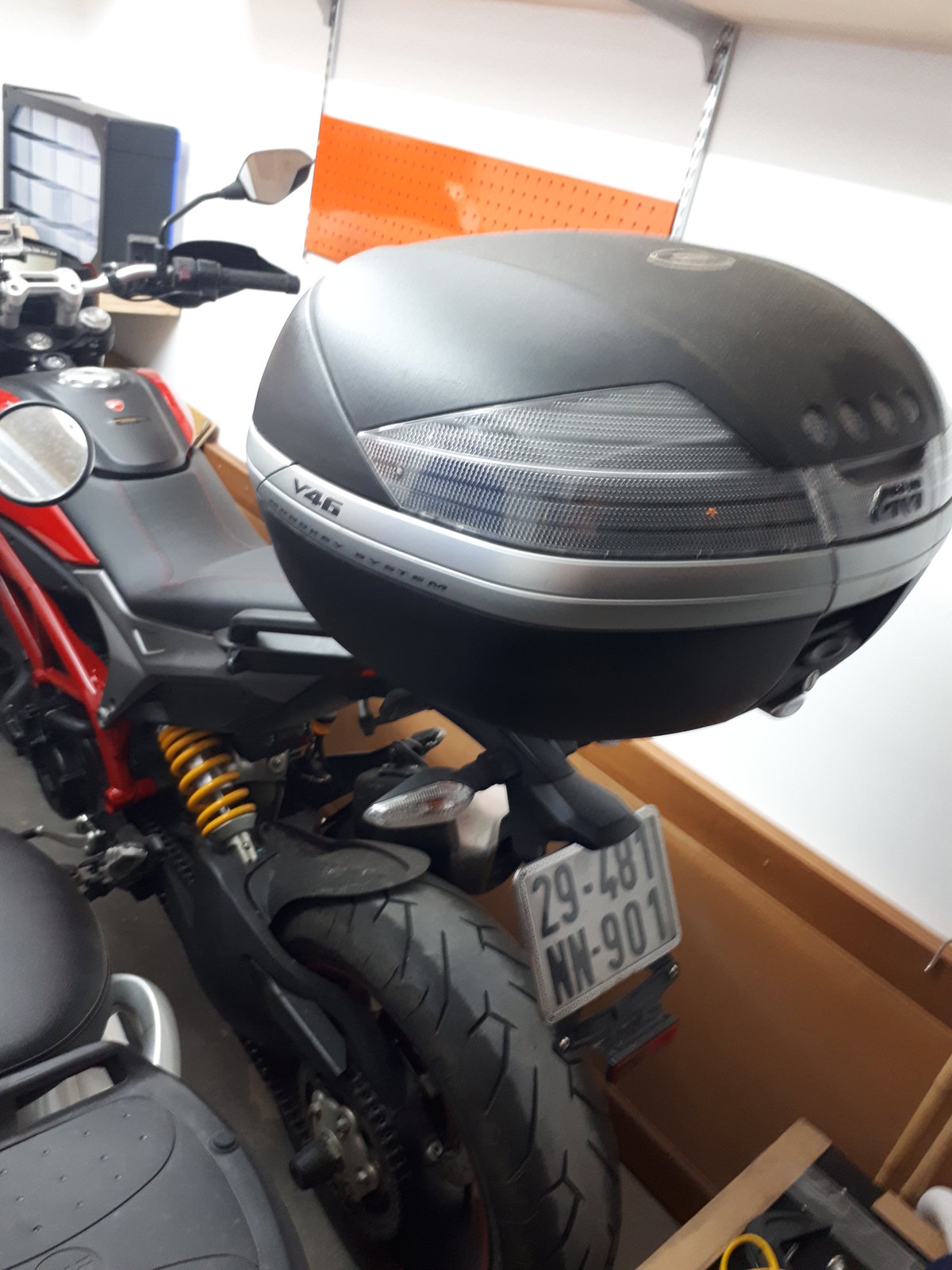

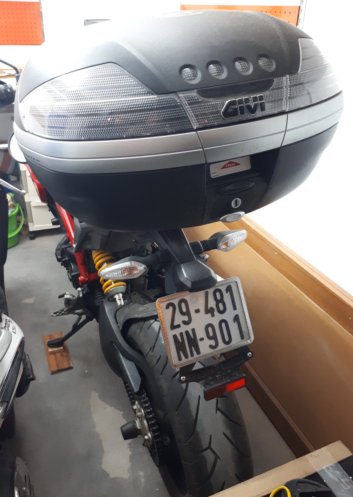

    ...and with the box fitted. It works well for me for my daily commute to work and back and weekend trips. For shorter trips I will sometimes leave the box off the bike and use some luggage straps to strap a wet pack to the back of the bike.
    I got the plate from Motostorm in Itlay. It is the Givi SRA7403. This may not work on the 796 because of the way it uses the passenger grab rails for mounting. The one below is what I believe Ducati sold for the Hyper, but it has not bottom support and there are lots of stories on other forums of these things snapping off.
