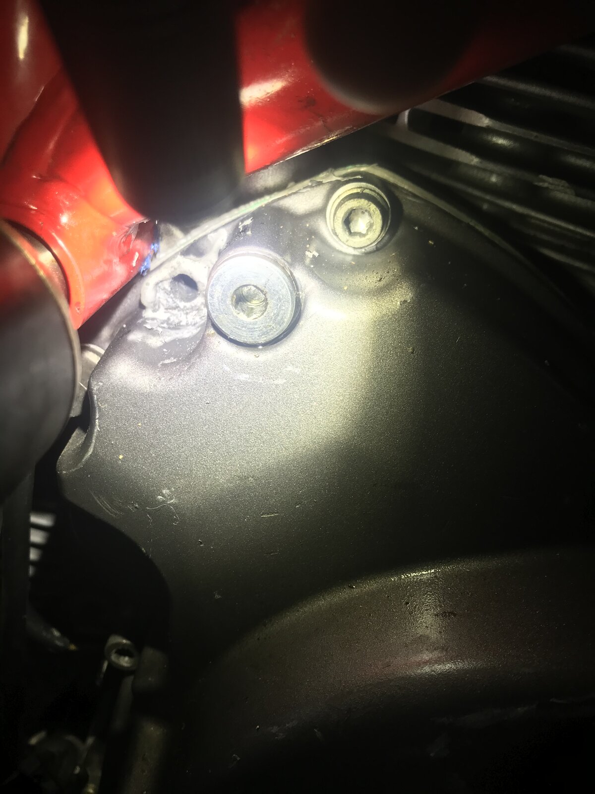

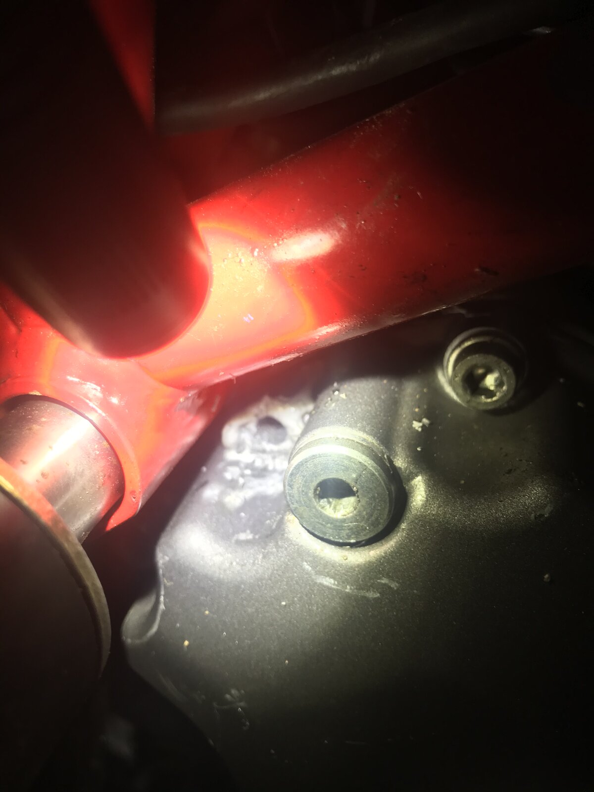

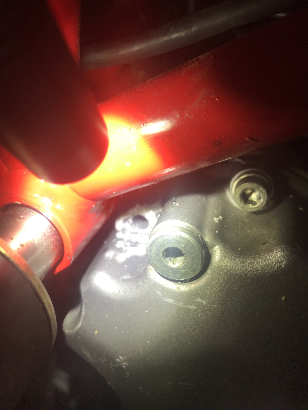

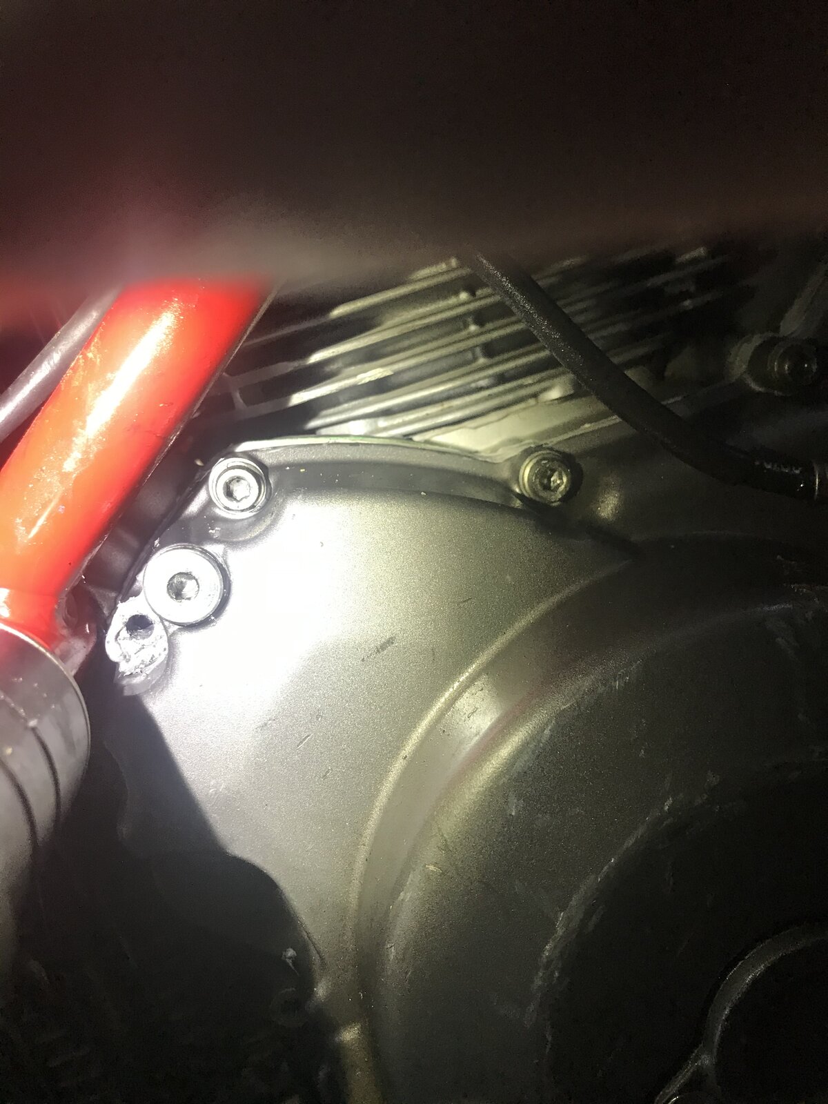

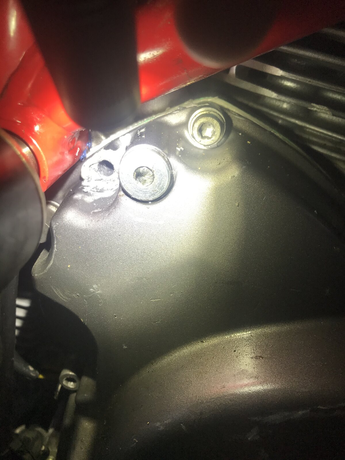

  1. I bought a 2010 hypermotard 1100 evo with 16k miles that I noticed was leaking a tiny bit of oil on the left engine cover. Further inspection revealed that while running I felt air pressure coming out of a hole that looks like a cover bolt goes there. I tried putting a cover bolt on there and cannot get it to start threading. This hole is located (looking from left side of the bike) at the top left of the cover almost right behind the frame slider. Also there’s a lot of gasket maker someone put in when putting the cover on and that may be keeping me from starting that bolt but I don’t know. Is there something I’m missing or should know?

  4. It’s the hole on left. While running I can put my finger in the hole and feel suction.

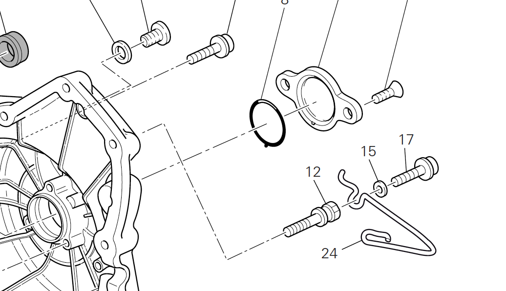

  5. The parts diagram shows a 'special screw' (item 12) which another screw (17) screws into securing the 'fairlead' (24) with a washer (15). The fairlead is just a wire clip to secure wires or maybe breather tubes.
