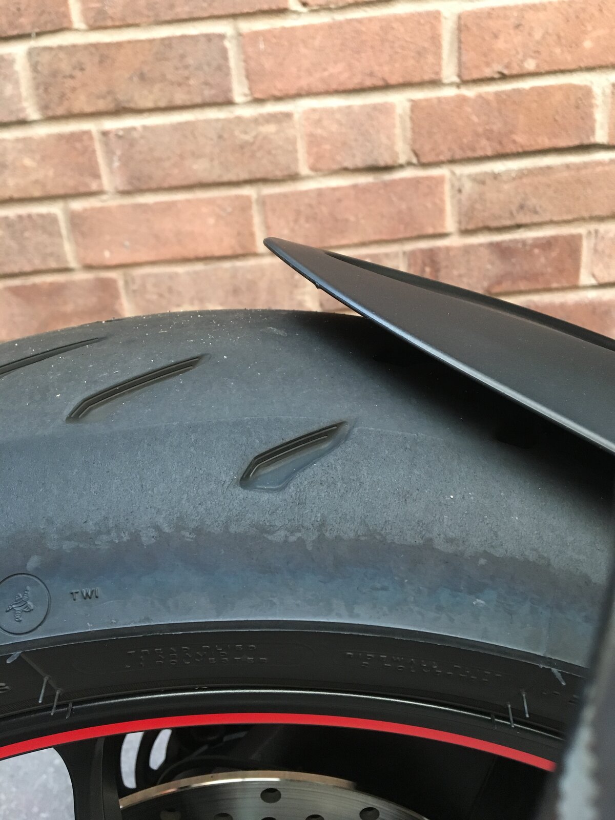

  1. Hello,
    I'm currently running Pilot Powers on my Hypermotard 821.
    After approximately 4k miles, the rear has become square and the thread in the center is down to 1.6mm. The thread on the center of the front tyre is 2.7mm (>3mm on the sides).
    My questions are:
    • Can I get away with replacing just the rear? Or should I replace both?
    • Has anyone gone from Pilot Powers to Pilot Powers 2CT? If so, is it worth it? (haven't tracked it yet, but would like to at some point).
    Thanks
