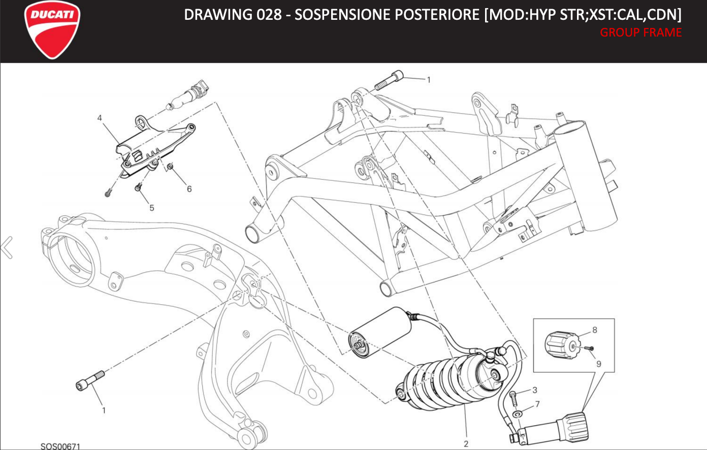

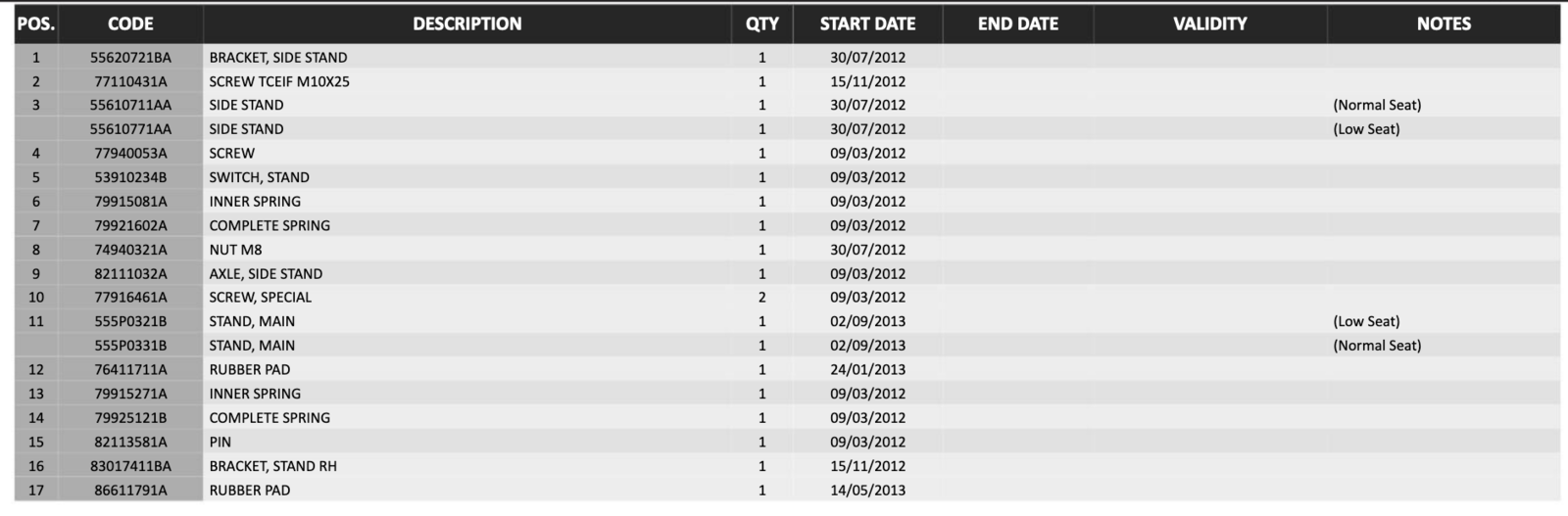

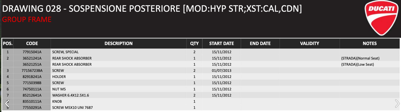

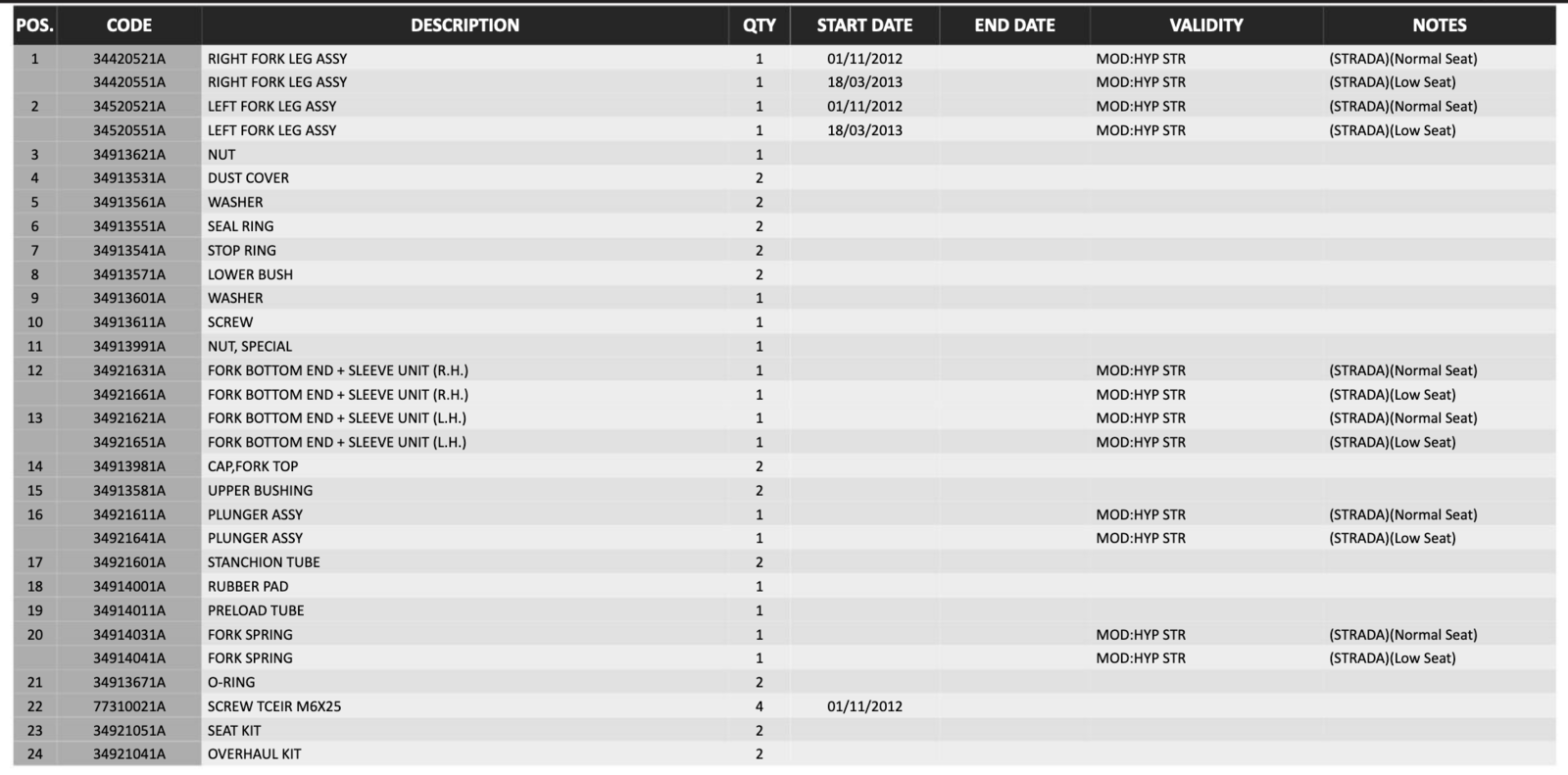

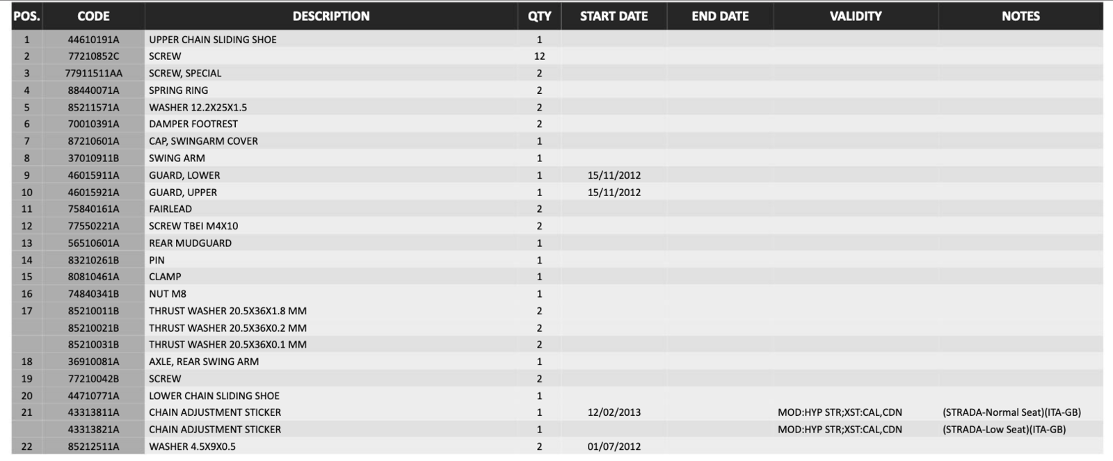

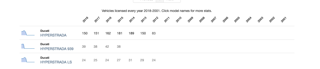

  15. There are 2 different variants of the Strada and the parts catologue lists parts for both. Even the chain adjustment sticker is different on them.
    The catalogue shows one part for both bikes, but there is a seperate part number depending on the variant.
    The seat is the same on both models btw. The full bike is lowered and the LS is very prone to grounding out the foot pegs.
