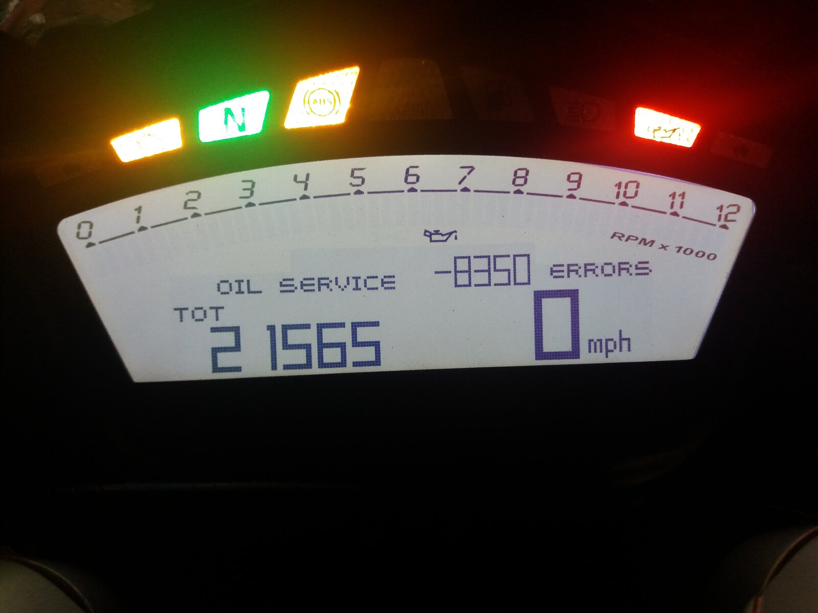

    I own a 2013 Hyperstrada 821, sometimes when I try to start it the dash shows a error code and the start button doesn't work! If i turn the ignition on and off a few times the error code doesn't illuminate and the bike starts and runs perfectly all day until you stop for a while and it happens again. The dash does show the bike needs a oil change but this has been done so it seems to be just counting down until the next service is due, any advise would be appreciated.
  2. What is the error code?
    Did you do the oil change or a dealer? If the latter they should have reset the countdown and removed the oil service indicator.
  3. The oil change was done by a dealer before I purchased the bike which was back in January.
    Thanks
  4. I believe, but stand to be corrected, that some service indicators cannot be extinguished unless they have appeared. eg if the service light is set to appear at 7500km and a service is done at 7400km it will still appear 100km later, it can only be extinguished once it has become present on the dash. A simple visit back to the supplying/servicing dealer and they should clear the service indicator FOC.
    If you only purchased the bike in Jan is it still under warranty? If so I’d get the supplying dealer to look at the error code and fix whatever is causing that as well.
    Out of curiosity what is the error code?

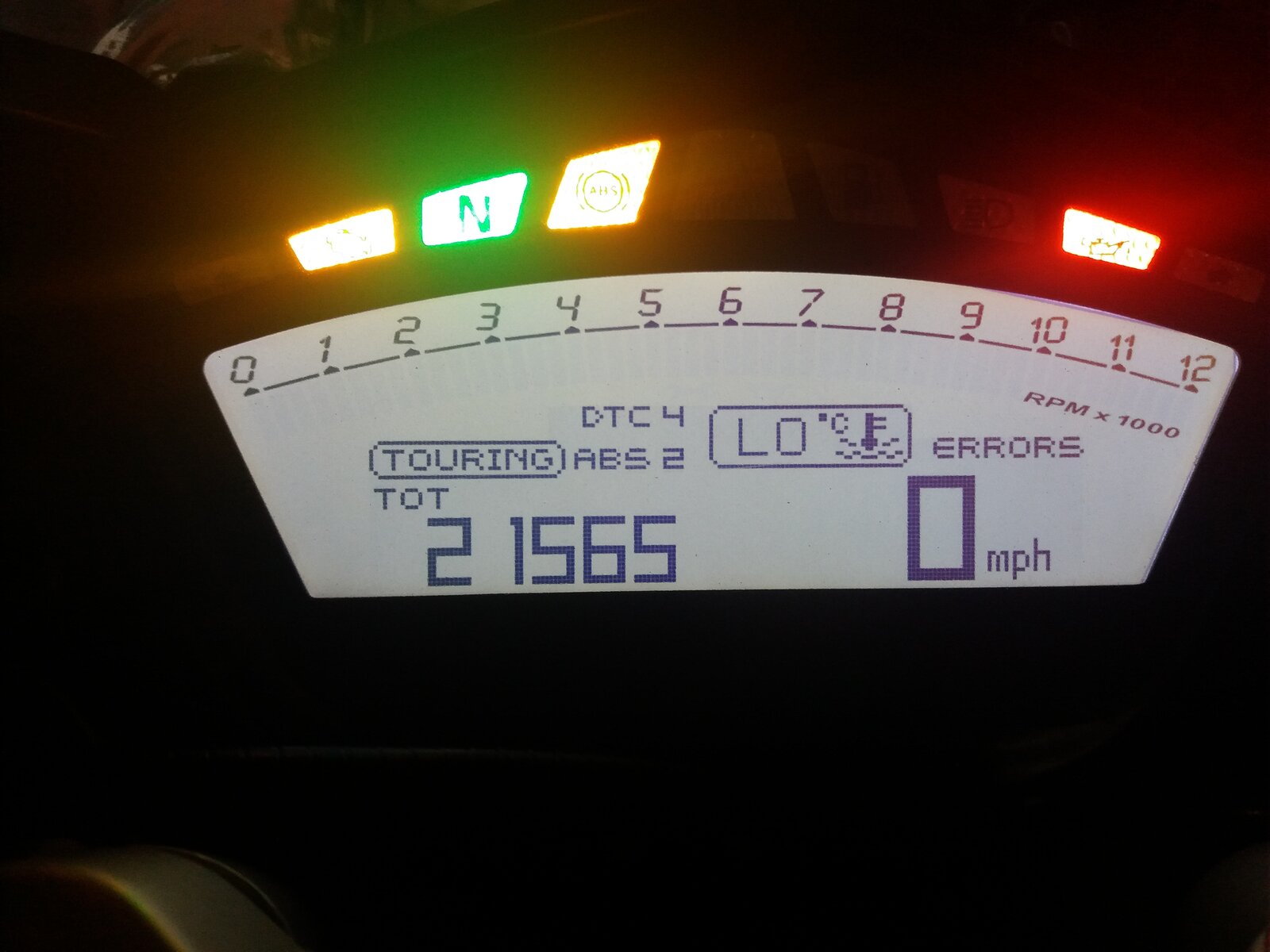

  8. Hi.
    I've managed to access the dashboard error display and it states immobiliser hence I guess why sometimes it doesn't start but either way it looks like a trip to louigimoto who incidentally carried out the major 18000 service back in 2018

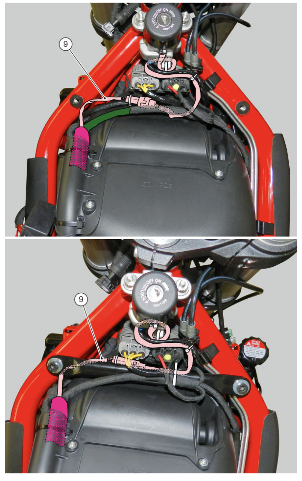

  11. Yes, antenna slipped down in lock surround or possibly corrosion at the terminals of it's connector.
  12. Thank you. Is this something I can fix myself or is it a expensive trip to a main dealer ?
  13. I'd certainly look at myself before going to a dealer. The antenna is under the sleeve around the ignition lock. For this bike I don't know how easy it is to access. The cable from it is coloured pink and marked '9' in this diagram. Check the connector is fully home and with no corrosion. Screenshot 2020-09-28 at 10.36.44.png
  14. Thank you. I'll give it a go.
