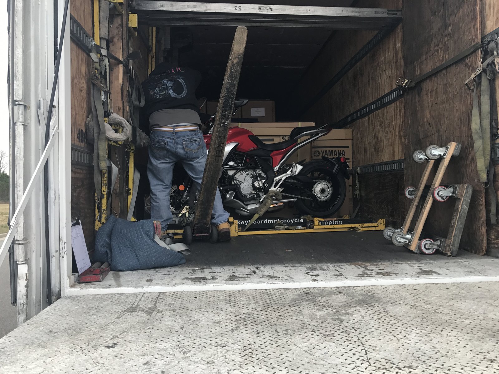

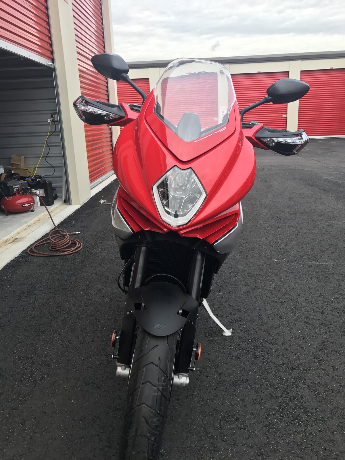

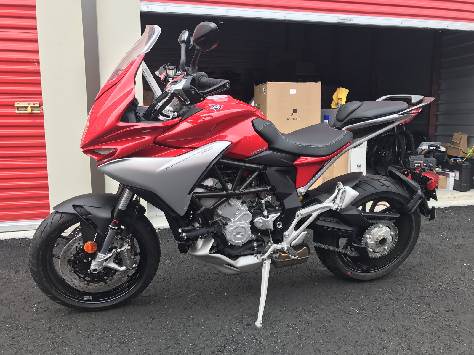

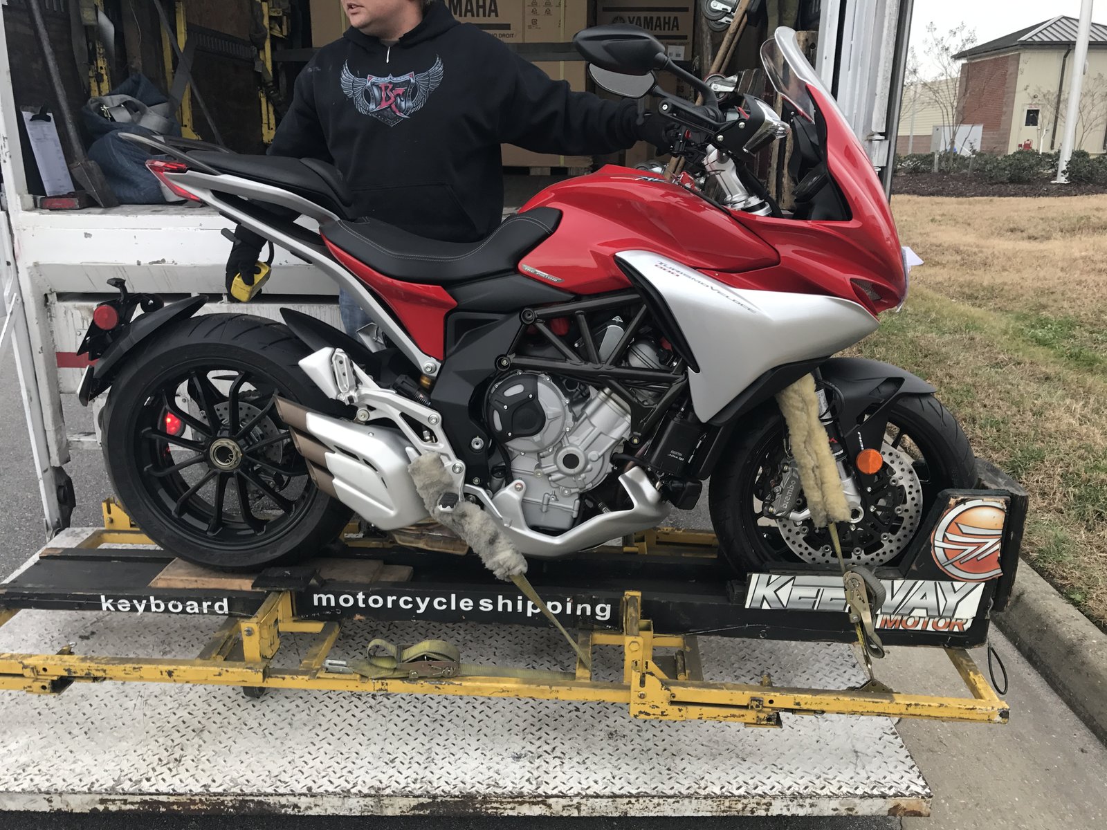

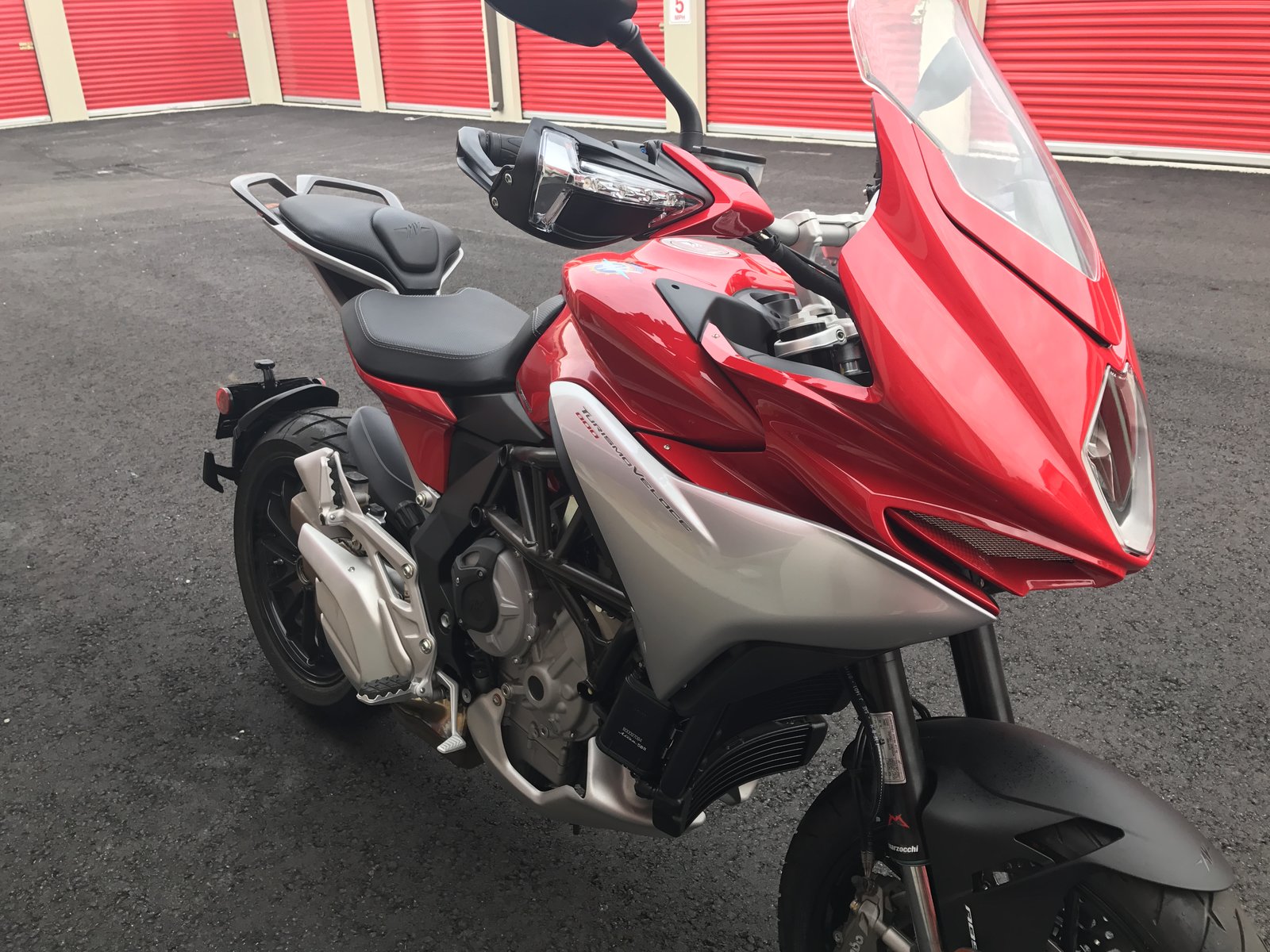

  1. The MV I purchased a little more than a month ago finally showed up... Of course now its really cold so I was limited to a quick run around the block. Seems promising definitely different than either of my Multistradas.
    A Beautiful machine without a doubt.

  6. The pillion seat must have a f/c limit? first word is fat. It looks like a "big boned", "I have a thyroid condition", "it's genetic" pillion may struggle ?
    I do like the look of it though, I'm sure a few have said they tried one of these also. Nice chrimbo pressie.

  19. My thoughts too. God that thing looks ugly. First thought was the fairing looks awful from the side, but from the front it's even worse. Pity, since MV have made some really gorgeous bikes in their time.
  20. I find that pictures don't do it proper justice... Yet I always thought the original MTS was kinda funky good looking.
