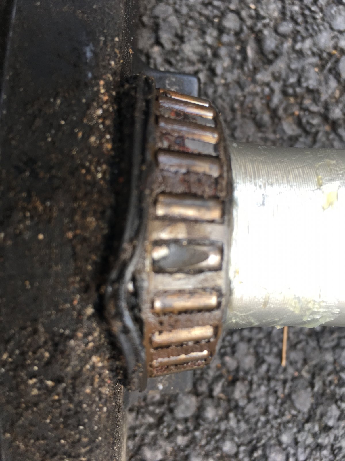

I Thought My Head Bearings Felt Weird
    This eas a good quality Koyo bearing only did 12000 miles, strange I would have thought it lasted longer than that!!
  2. The top of the headstock is clearly not watertight as that bearing looks as though it has been very damp for a while. We had a similar issue with the Diavel headstock bearings, MoT failure identified our problem. Andy
  3. O.M.G...
    Problem is, the race will be corroded as well... :/
  4. Just passed an MOT last week!
    I think the roller punched through the seal and caused water ingress as the other side is rust free
