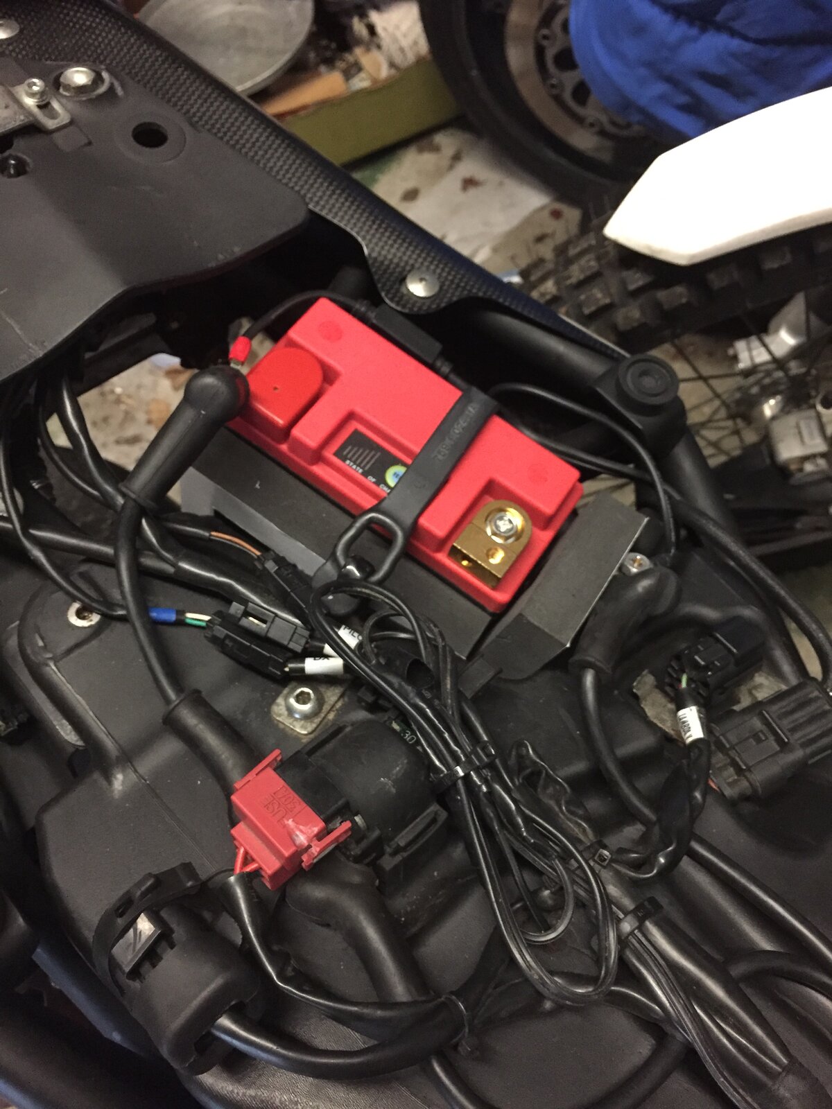

  17. Fitted a lithium battery today, weighing just 890g. Weighed the original battery and it was a lardy 3.9kg. Another 3kg pared off the SP, so wet weight now just 169kg!
    Original (stock engine, stock weight) power to weight ratio: 459hp per ton.
    New power to weight ratio post remap and diet: 566hp per ton.
    Long live the diet
    Matt

  19. I done the same couple of mods to my 796 last summer (Alloy subframe + LiPo battery), I was actually really surprised at how much of an effect it had on the handling. I feel as if the alloy subframe gives much better rear-end feel due to the decreased stiffness (although this might be more significant on the 796 due to the shite suspension). Also the forwards shift of weight distribution seemed to help with the front-end feel too!
  20. Very interesting. I guess due to the weight being high up, the effect would be very noticeable. Did you have any issues with the battery at all? Does it maintain its charge well etc?
