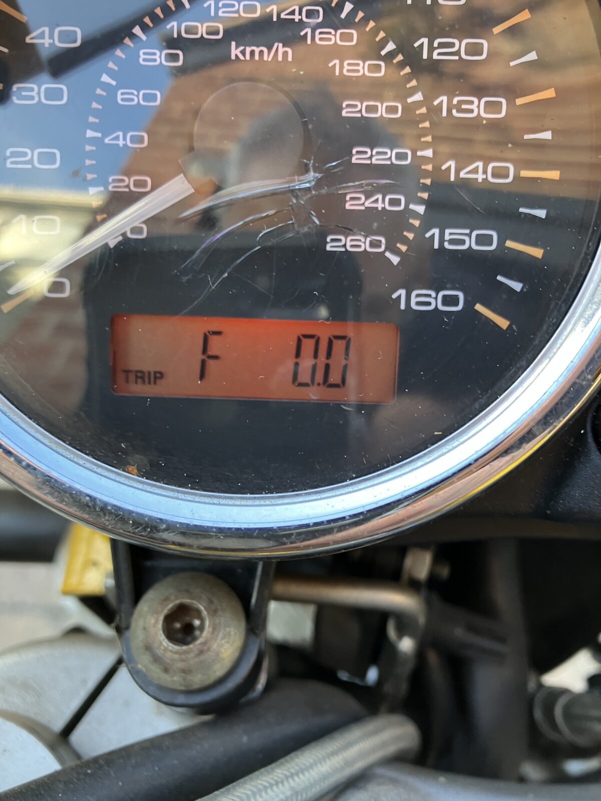

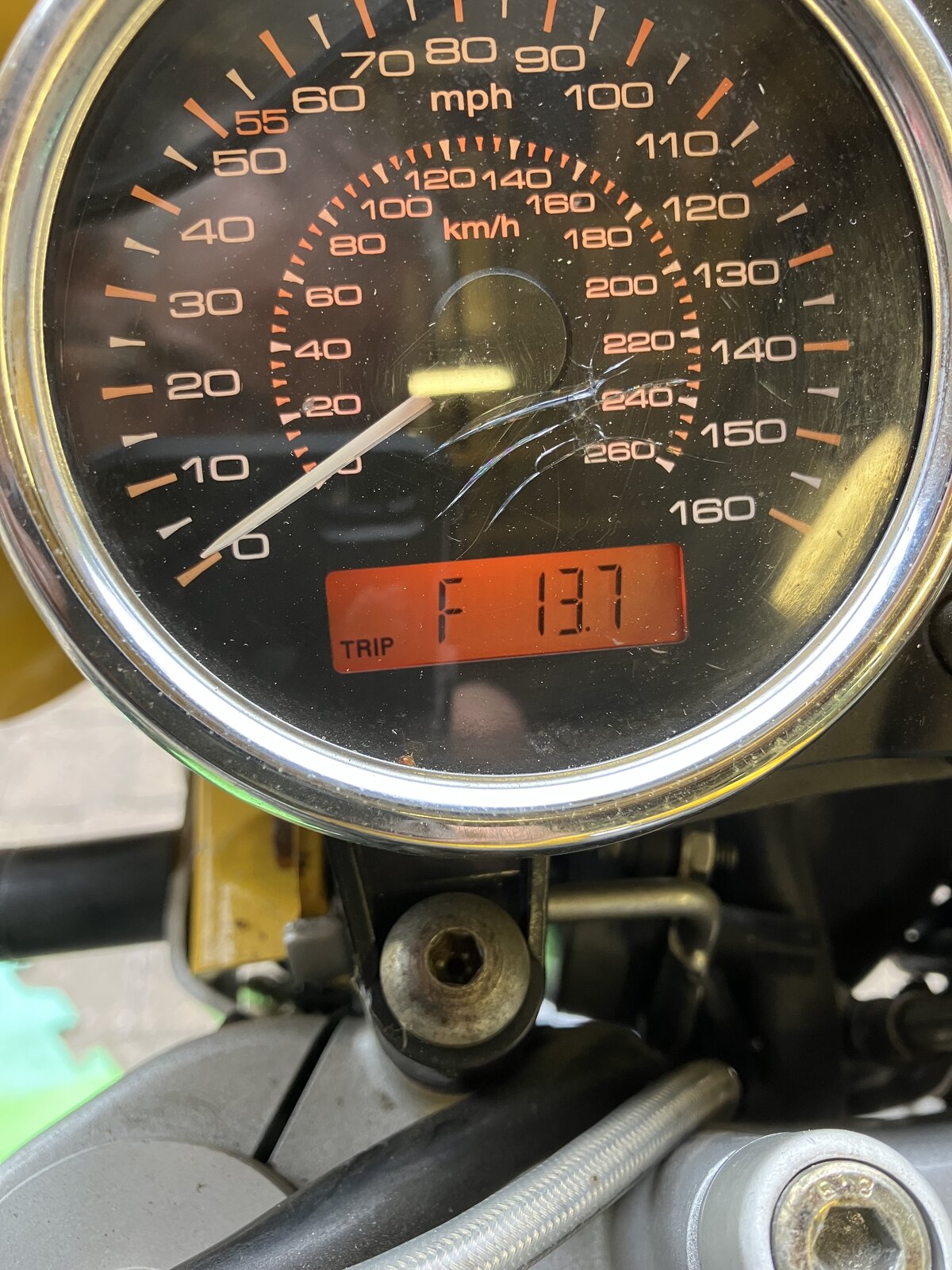

  1. I haven’t seen this before, and wondered what and why!
    Started the bike up (been about a year gap sadly!) all ok for a minute, then it threw this message on the mileometer.
    upload_2025-8-24_10-28-45.jpeg I took
    took it for a short ride and the numbers increased incrementally by 0.1 every time through to this upload_2025-8-24_10-32-21.jpeg
    Wondered if it was a fuel light count up of some sort that I hadn’t seen before but it was only a 5 mile run, so it doesn’t add up in miles or km, and the bike started missing and popping increasingly as the ride went on. Tickover fine but worse as the revs rose.
    Anyone got knowledge here that could help me head in the right direction first time?
    Thanks all! Jon

  3. Hi Chris, thanks, I will try a 30 min pole short-out but to be clear, it has not stopped at 13.7; I just happen to have stopped riding when it got to 13.7. If I continued to ride I’m pretty sure it will continue to increment on the readout by 0.1 every x seconds.
    I looked at google and AI before I posted. The battery is new, the odometer is not flashing, and in fact, when I turn the ignition on, the miles are shown as normal, then after about half a minute, it starts the “F” count-up from where it left off.
    Strange one ! I will probably have to dig out JP diag, but I unfortunately have no real skills with that tool, so will be reliant on something jumping out at me!
