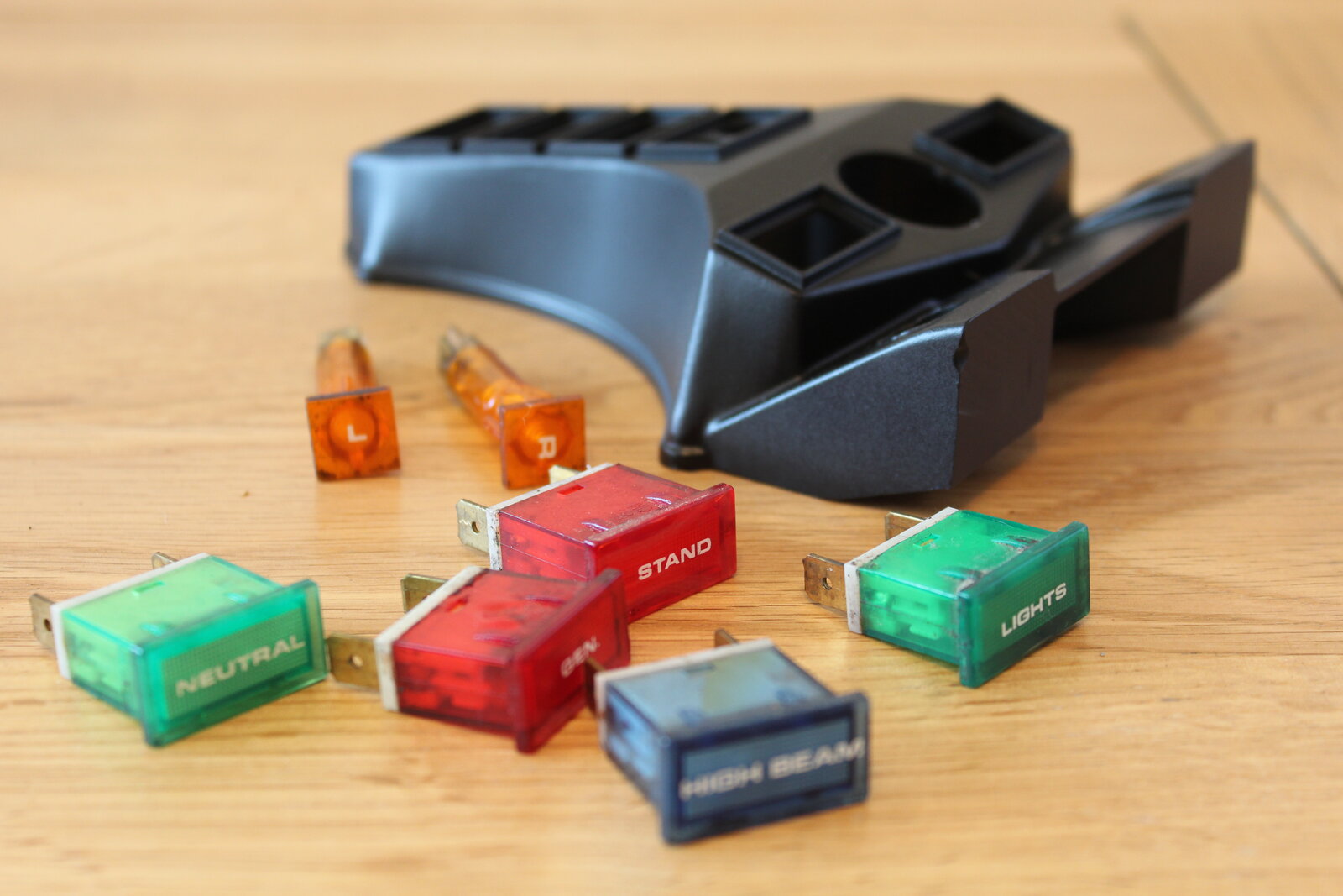

    One of the idiot lights of my 81 MHR has failed, they are easy enough to replace, but I cant find anywhere that sells replacements. Does anyone know where they can be bought? Or are they as rare as hens teeth these days. in which case has anyone tried to repair one?
    Thanks, Lee

  2. If you have a set like in the picture, even not working they are priceless.
    Repair them. drop me an email and i will send you some pictures of what to do

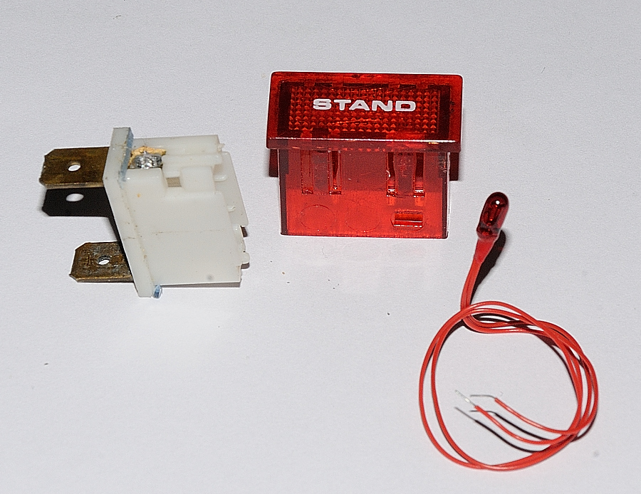

  7. I have reconditioned several of these.
    The bottom part of the block can be levered out (carefully), leaving the coloured lens part empty. My method was to take an old set of Xmas Tree lights and cut it up into bits, then fit a 12 volt miniature bulb into each holder, and crimp a little spade connector on to each wire. The holder was fixed into the rectangular coloured lens part with Araldite (other glues might do).
    The whole job was quite fiddly, but it worked and cost very little. Besides, since these are now unobtainable what alternative is there?

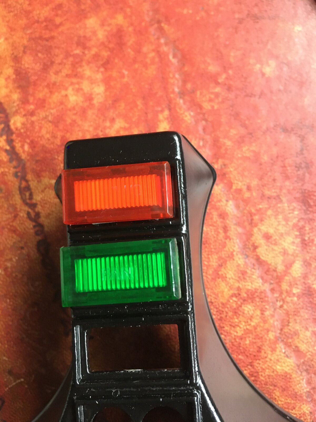

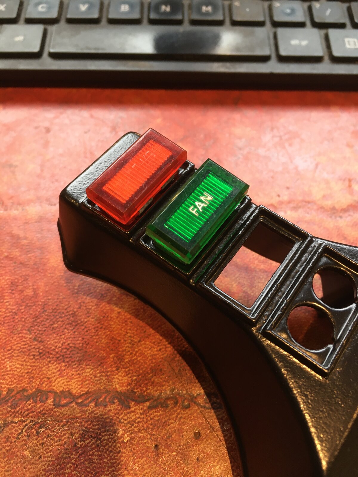

  15. No idea, I just saw this thread and thought I have seen similar lights somewhere. I was searching for Lotus Esprit dash lights as I think that's where I saw them and then stumbled onto the reliant lights.
  16. Good find. I’ve contacted the seller. Thanks!
    N
  17. Well it’s true!
    the Scimitar lights are the same size. I got a few on eBay for £3 each (working). Of course the text is wrong but that comes off easily. The next step is to find a way to put the correct text onto them. (Maybe not tipex) 4EF64560-3CC7-44B5-944D-DC4F3239C4A3.jpeg 04E9BB6E-FEF4-4272-BF6F-C79A26F4A168.jpeg
