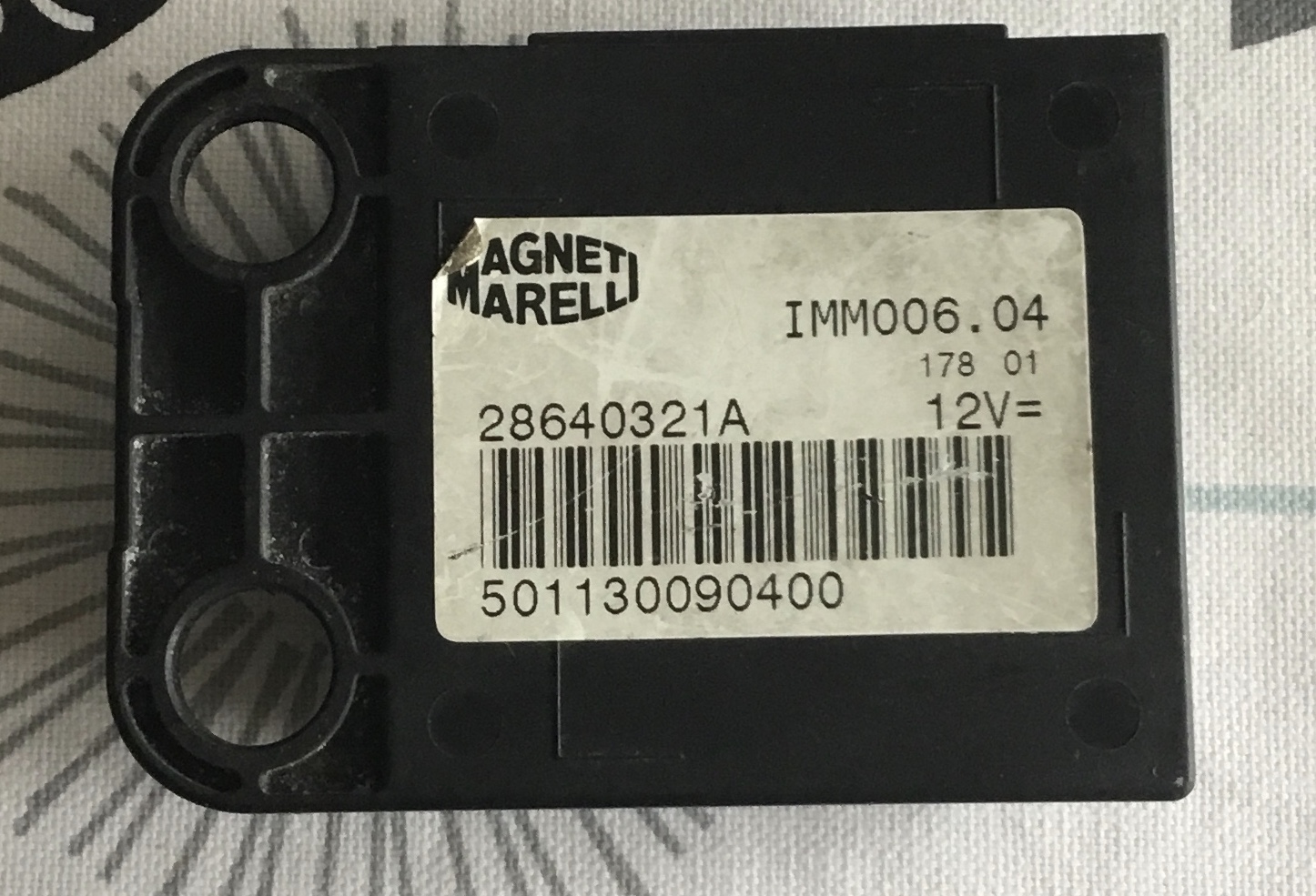

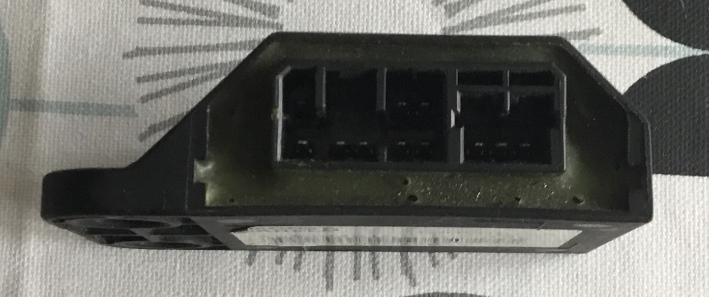

  1. This is a used but virgin IMM006.04 Part number 28640321A
    As fitted to the ST4S and early monsters using the IAW59M ECU
    The Virgin units go for silly money when new
    The red key and two black keys are required for programming
    £40 inc P&P
