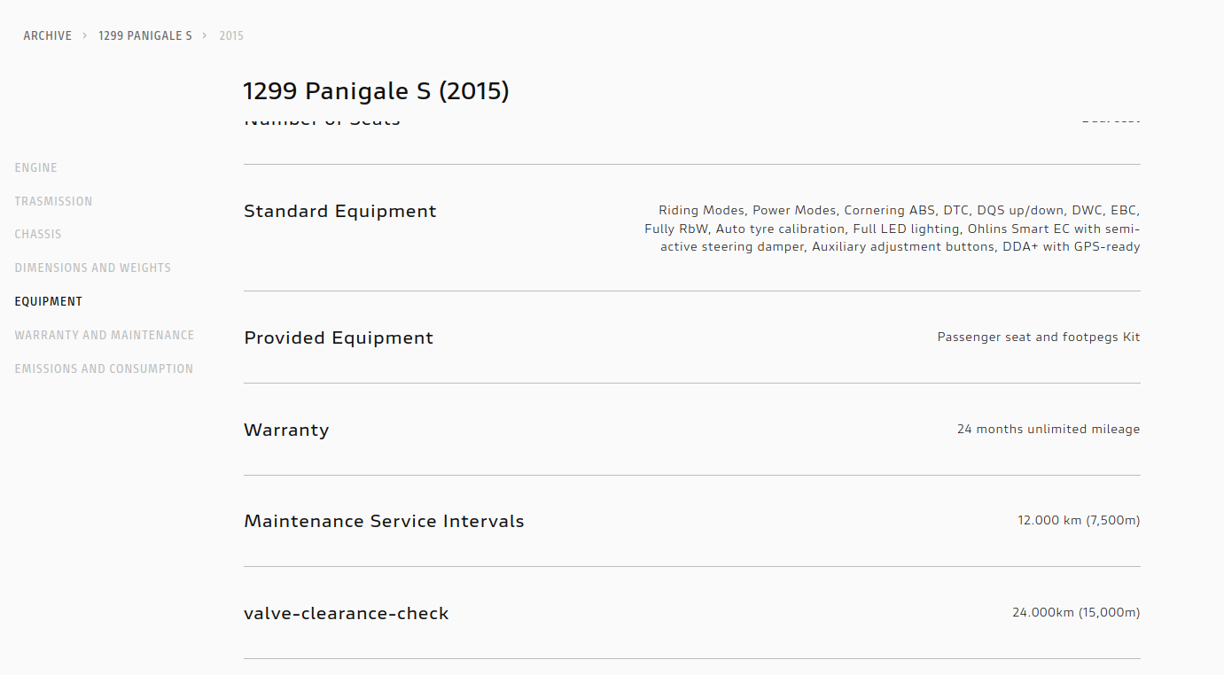

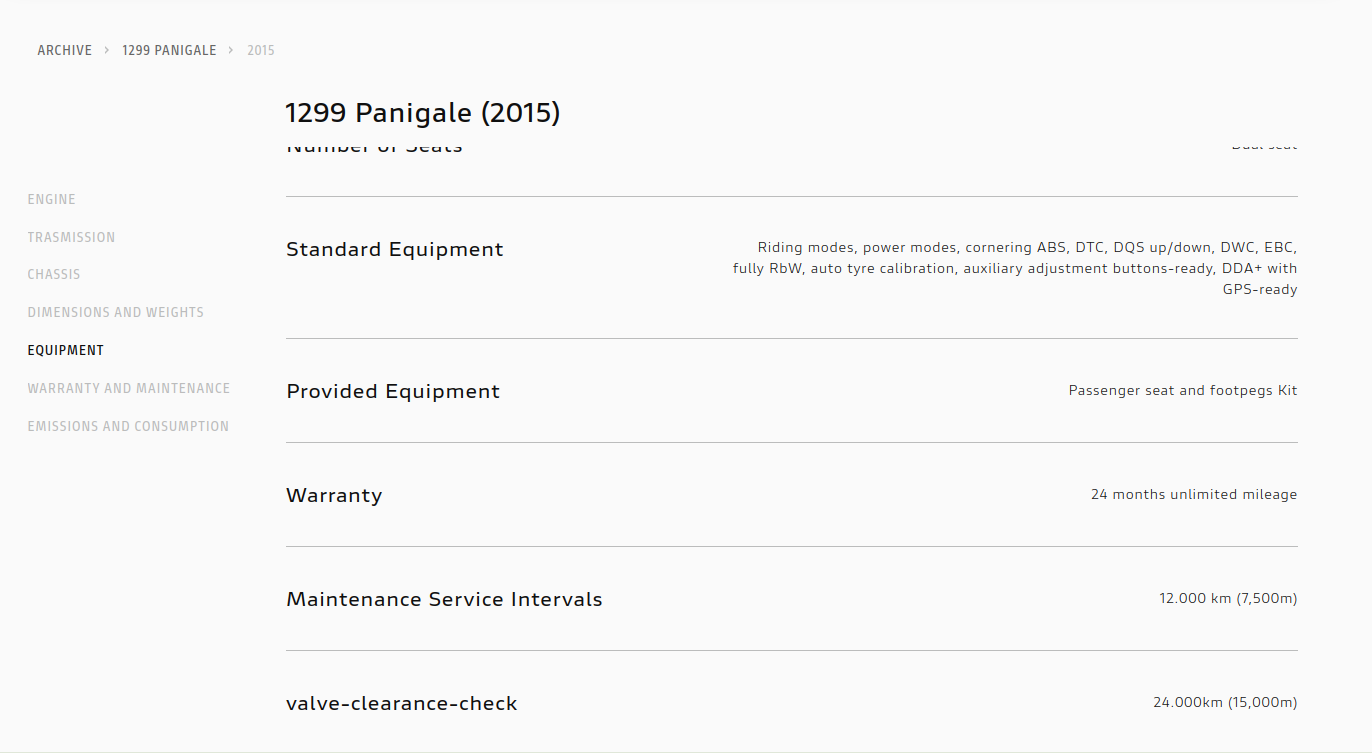

  15. The 2015 1299 "S" version had Full LED but the base 1299 did not.
    LED's make a world of difference.
