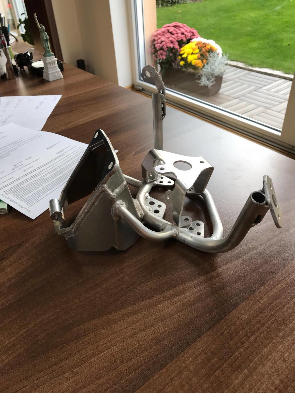

  1. Hi guys i must say that i am almost desperate :-( I am running my bike strictly on the Track.... I put some race fairings and custom DHbolders and now UHR tec dash holder with IMU mount....

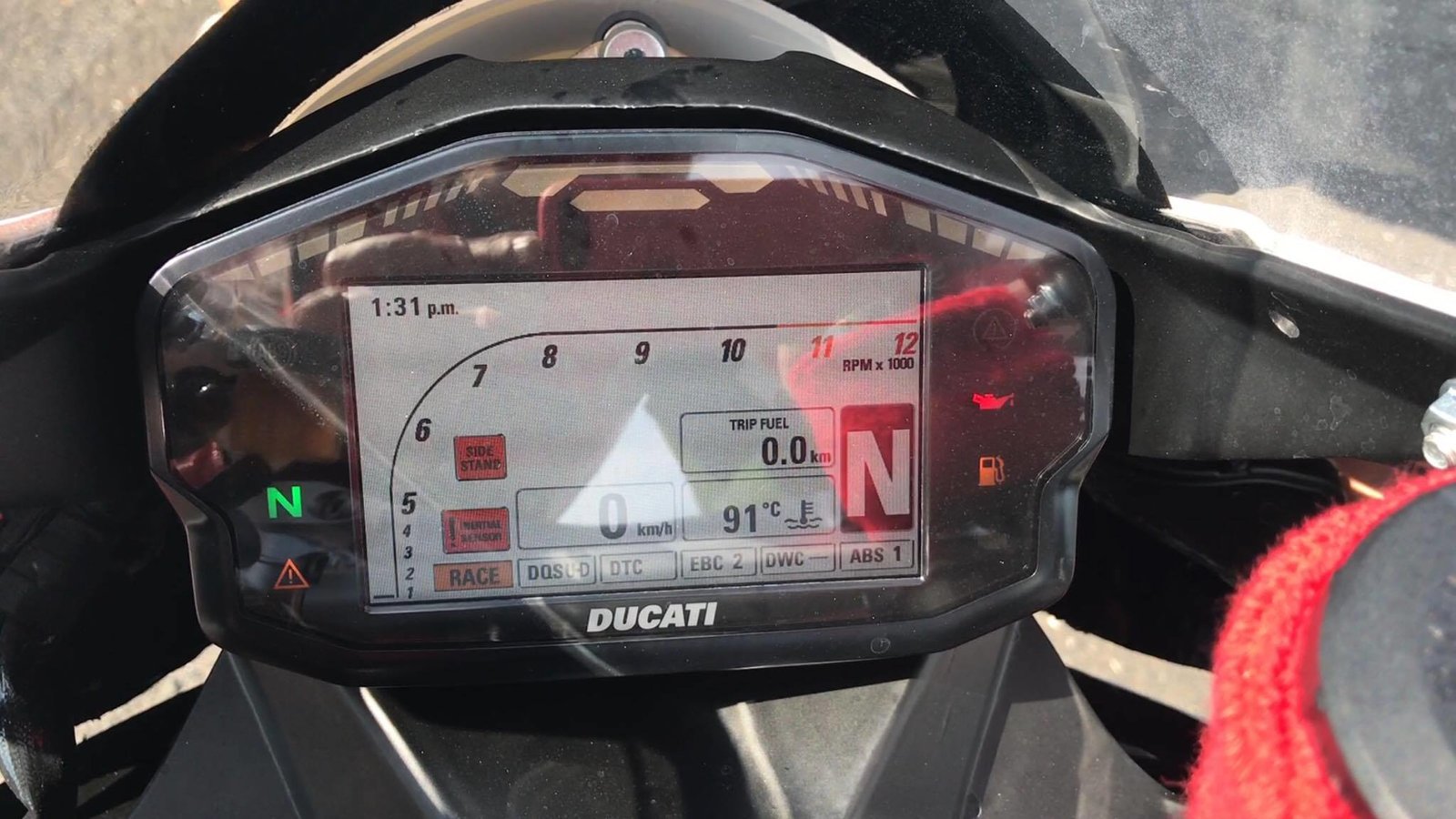

    The problem is... when i start the bike and go on track and when exiting turn or under full gas when the front wheel has the tendency to go up i get RED " Inertial sensor " and LOSE "DWC -". My DTC ten goes blinking that suggest DTC in reduced mode (so i am worried with lower settings under 4 because of slide control).
    I am really desperate because when i put back stock headlight with that plastic holder with stock fairings everything is OK... we tried every position of IMU, we reseted it by TEXA diagnostic, rubber bolts and etc.... but every thing with same result... Inertial sensor error.

  2. Do you have any photos of the mount on and off the bike?
    My bracket runs the width of the headlight unit using those mounting points, never had an issue with mine. I can only assume the angle is wrong, or there’s either too much movement or maybe mounted too tight when running/moving which is causing the issue.

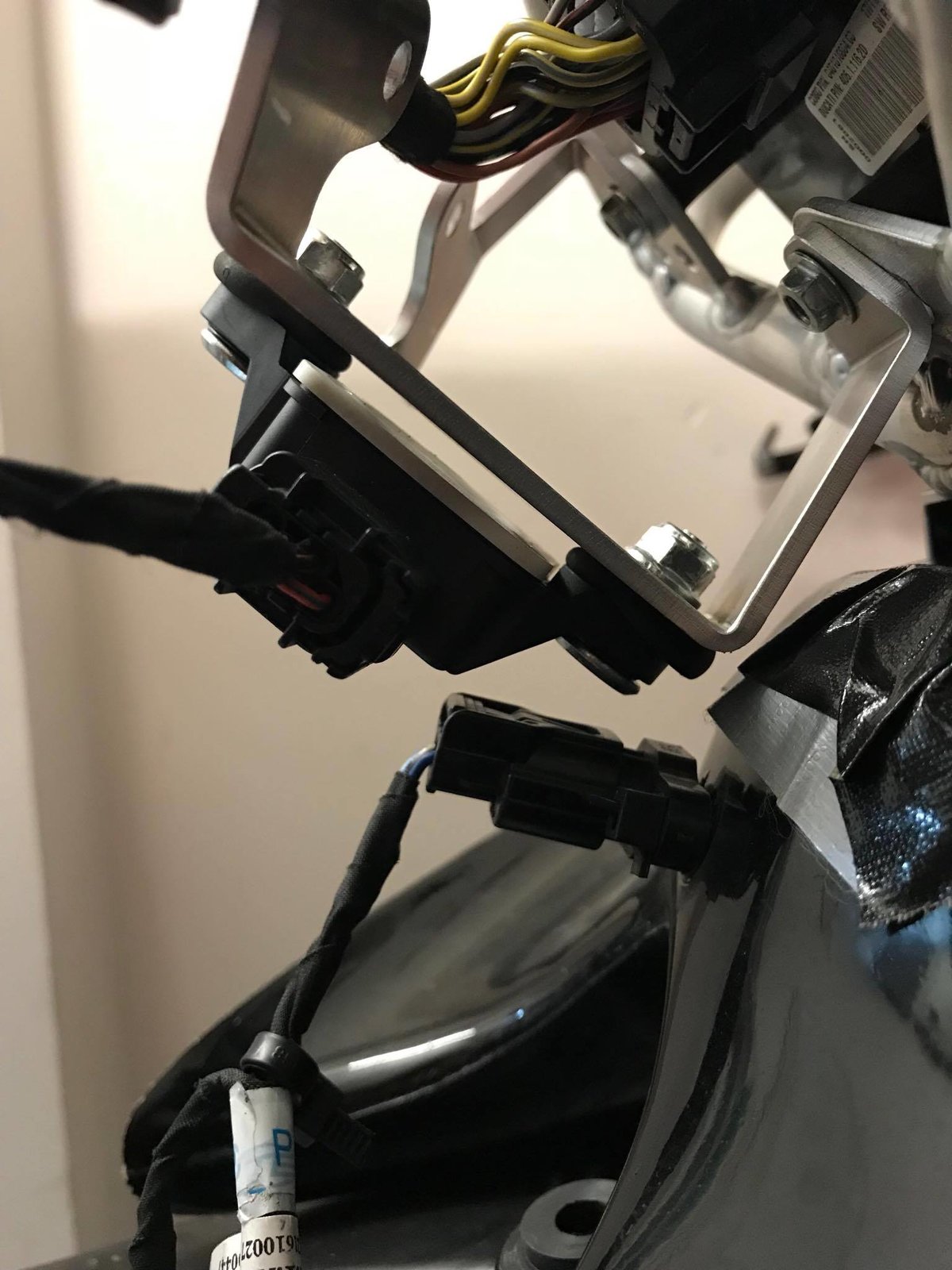

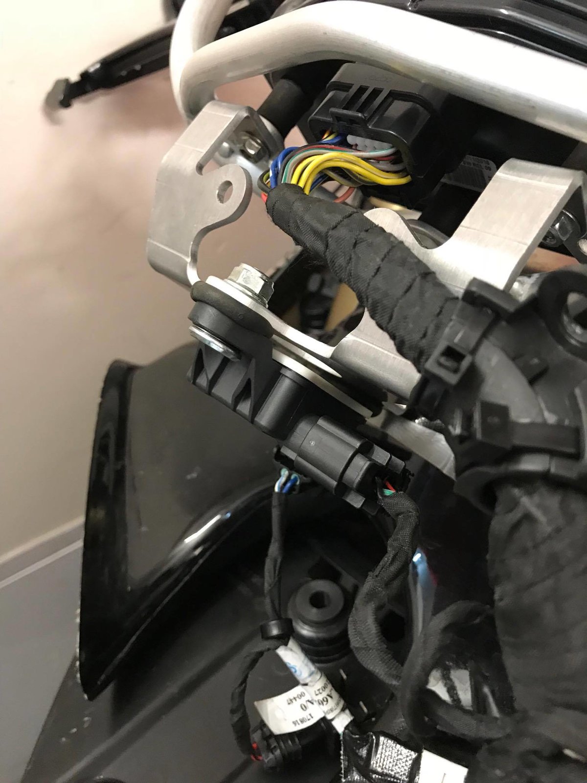

  6. This is mine, probably doesn’t help much, this was when it arrived, screws, rubber mounts were all taped up in the masking tape.
  7. Could you try mounting the IMU inside the bracket, rather than underneath? The IMU is very sensitive to position and to the angle it's mounted. Mounting it inside would turn it over 180 degrees???
  8. Yes try this if that is the same orientation as standard.
