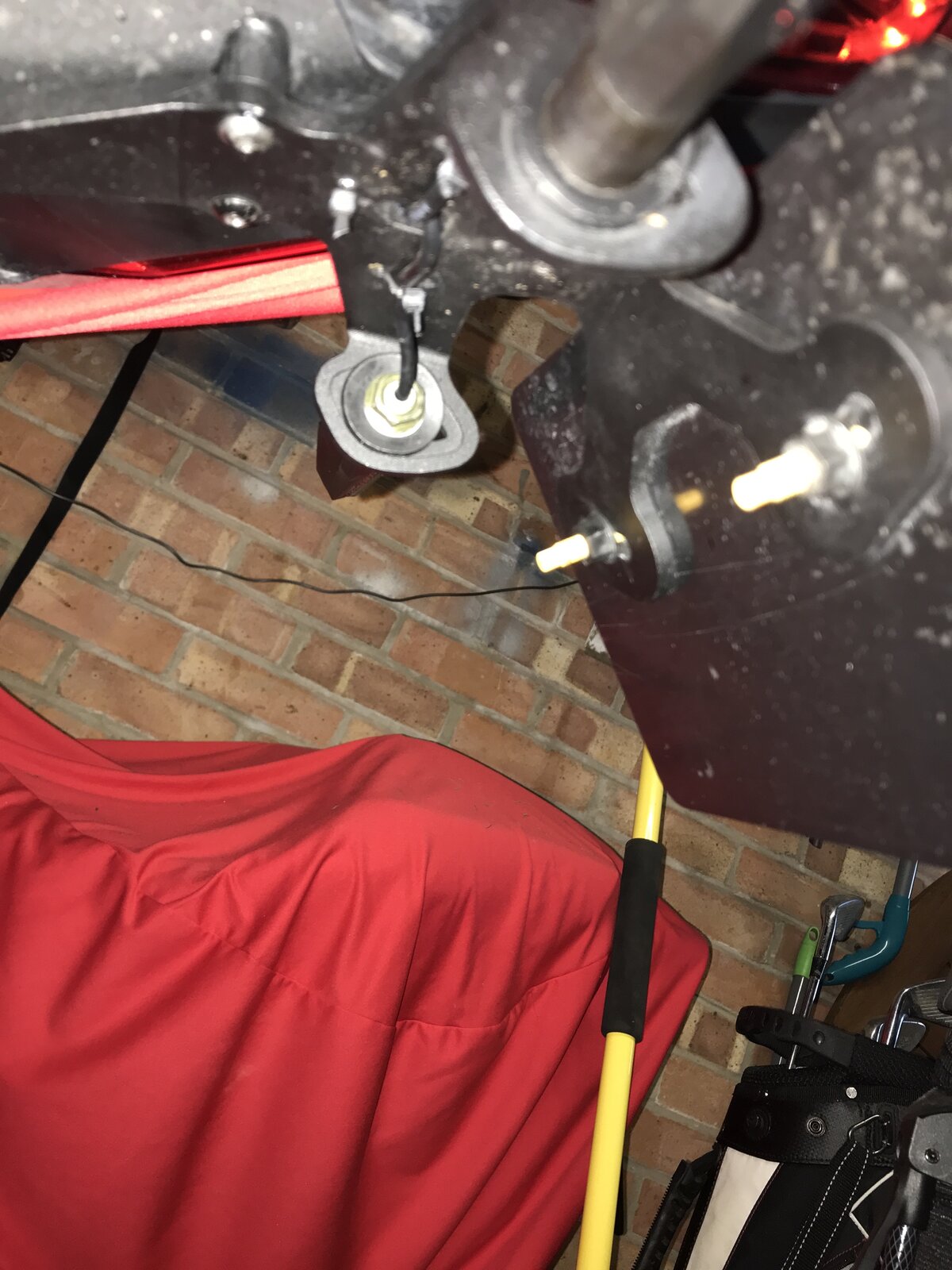

  11. Hi mate I’ve attached a picture. I have the evotech and where the indicators go in the hole was too big so I had to get my mechanic to ‘plug’ the gap. I think they put a rubber filling in. If you need more photos let me know (not the best pic I have to admit)…

    Also I have an Evo tech tail tidy too and the spaces are supposed to be filled with triangle like plastic caps. These must be missing from yours.
