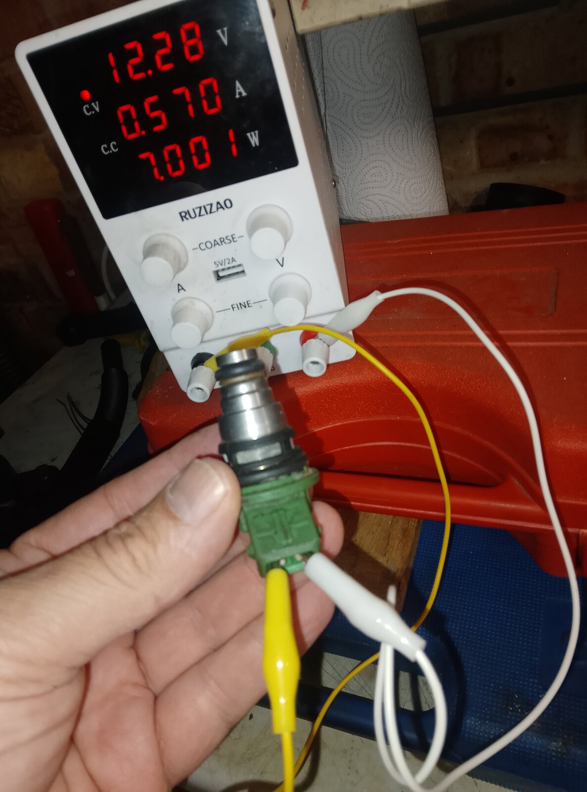

  2. 9V battery to open them, then spray brake cleaner through them. :upyeah:
  3. You can power the injector with a 9V battery or any other source of 9-12V.

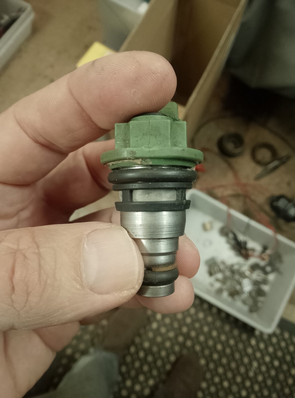

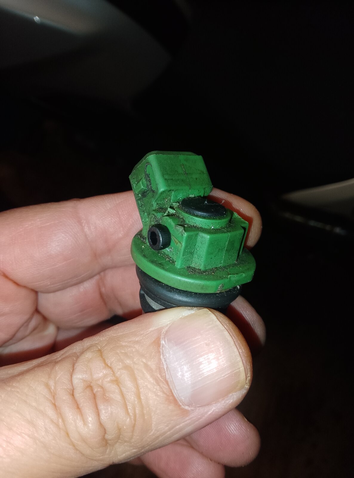

    It opens the path so you can back flush them with a can of brake cleaner for example. The injector itself has a ring of fine mesh screen which should have stopped any larger particles from going into the finer workings. I've had good success with that method although I'm in the process of making a proper tester for injectors so I can see spray patterns as well as sending some cleaner through at pressure. IMG_20241020_203157.jpg IMG_20241020_203208.jpg IMG_20241020_203707.jpg

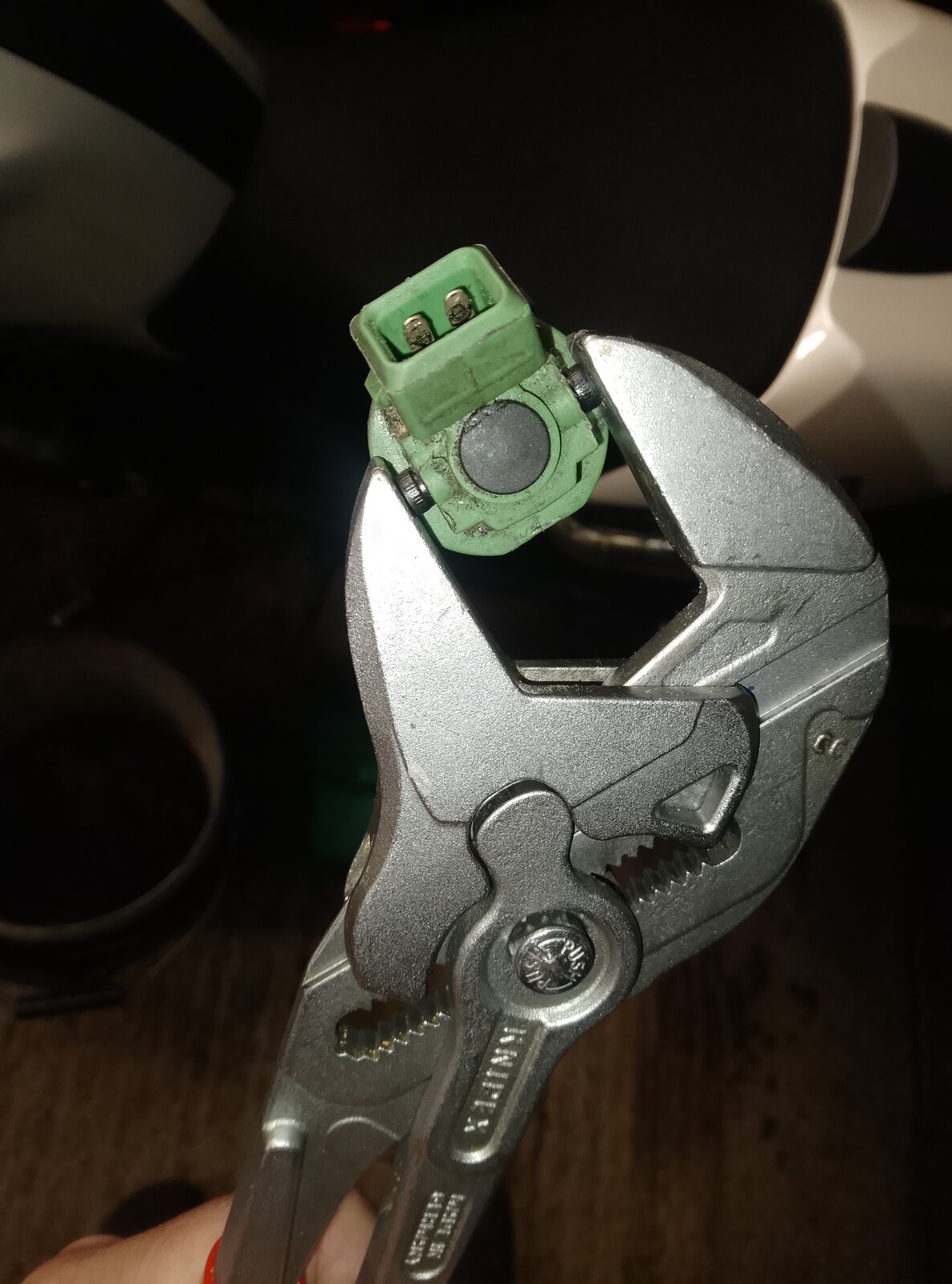

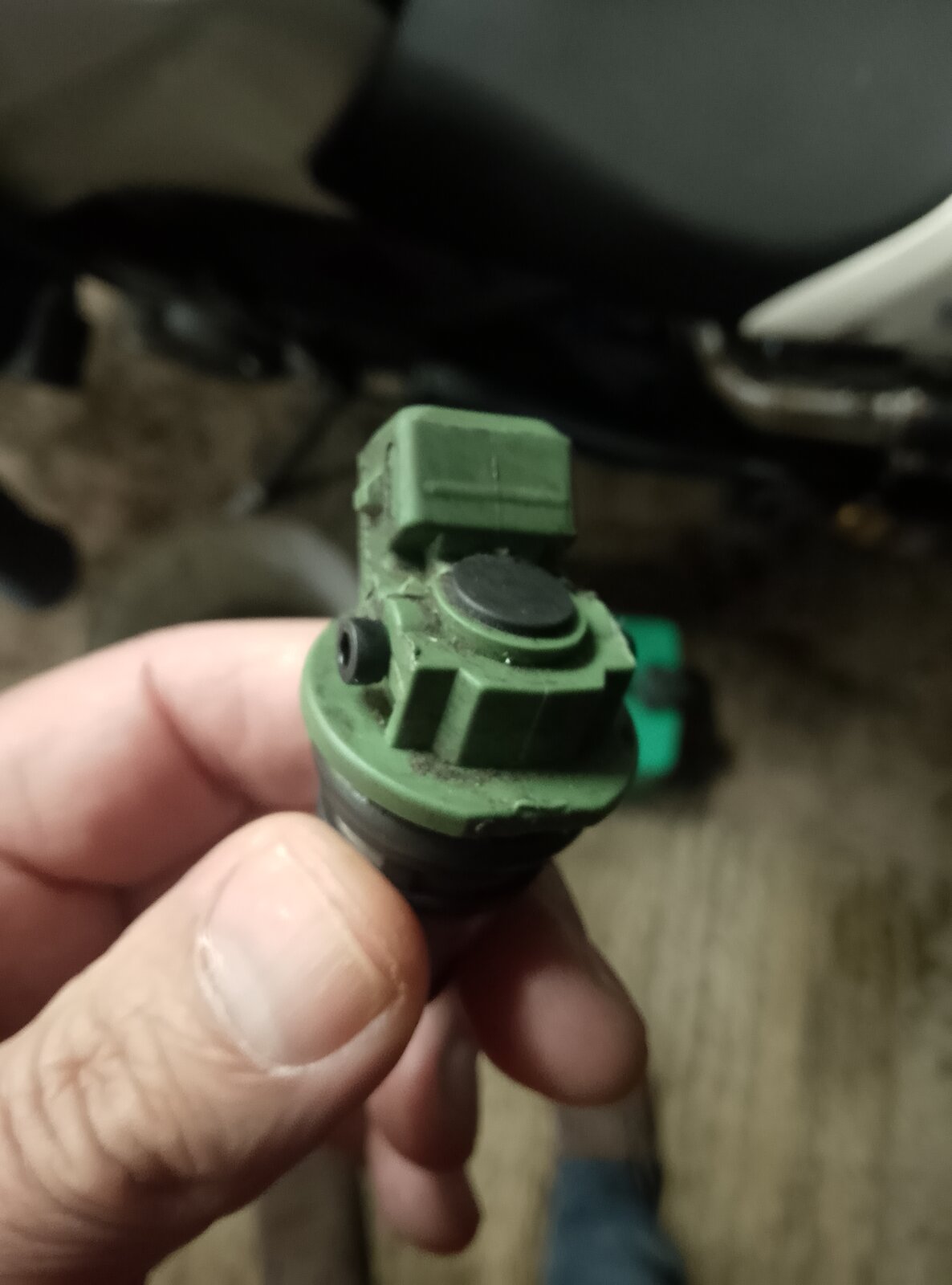

  7. Stick two M3x6 cap heads in the holes either side. That gives you something to grip onto. Lubricate, twist and pull. 17295141834748592919218296548814.jpg 17295142342302806948415571262606.jpg
