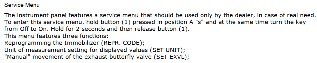

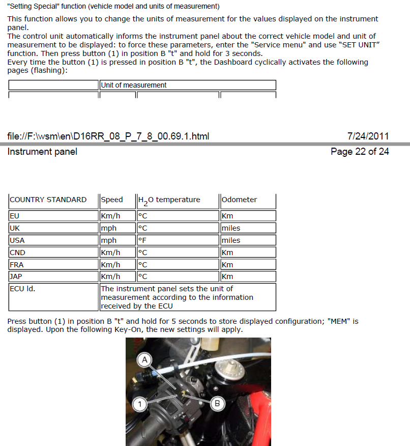

  1. As its so quiet on here, can anybody please tell me how to access "special settings" menu to enable change from fahrenheit to celsius? My handbook mentions a "settings special" [Italians!] menu. Or, simply change regions, [as was possible on the 999 bikes]? USA/UK/EU. Thanks.
  2. Hold the button down as you turn your ignition on. Hold it until the menu appears.
  3. Thanks again Rob.
  4. still struggling. So, button 1 is simply a rocker switch with 2 positions, A & B. I can hold it down in A or B position as I turn on ignition, and it simply keeps scrolling D16RR I can't get to a service menu? Sorry, but can you advise again Rob?
  5. Sorry, silly me.
    Hold the button 'A' whilst turning the ignition on, release after 2 seconds to display the service menu.
    Sorry for the confusion. It's not something I do every day. :blush:
  6. Bingo! Thank you Sir.
