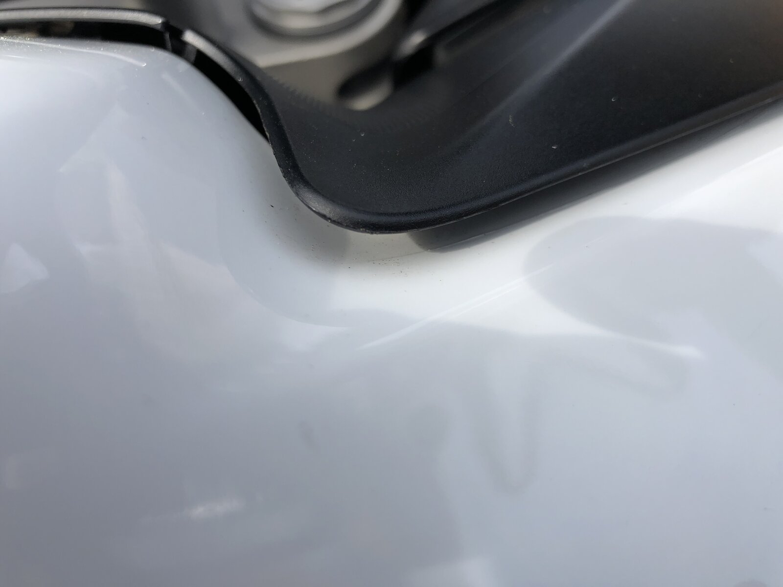

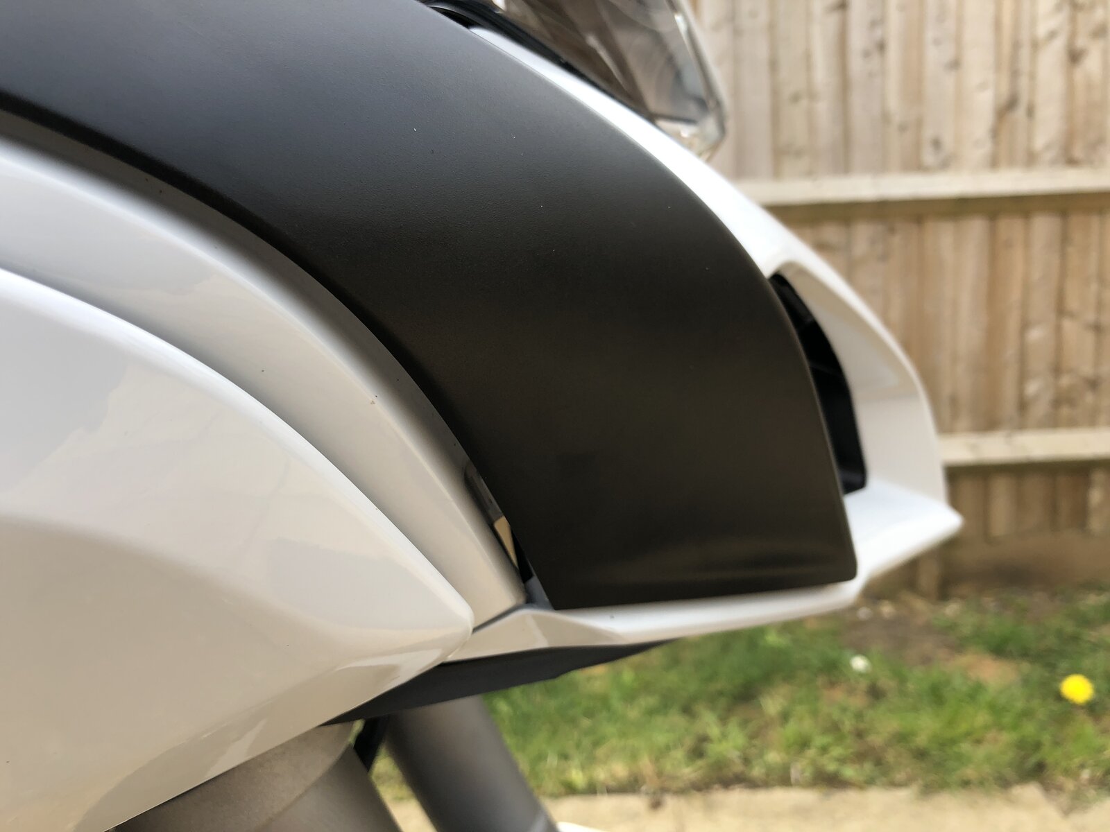

  1. Anyone got a good technique for getting the front clip in the slot on the black plastic side panel before sliding it back one of mine is proving a right b***tard to get in

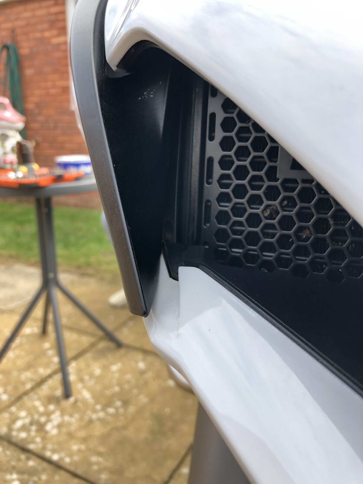

  12. I went through this 2 weeks ago also, spent over 2 hours, very frustrating. Found the issue in the end, however its difficult to describe. Basically the black part you are trying to slot into (inside the nose), it had been pushed back a small amount, you need to compare with the good side. That black plastic inner need to come forward. I will try and take a photo tomorrow if required.
    Anyway try and comapre it with the OK one
  13. Yes that’s exactly same on mine but also as the fairing ur trying to fit always slid to the outside of the slot if you just wedge something in to force to slot out it just slides in
  14. I've had the same issue on both the 1200DVT and the 1260, not always on the same side. I've found that twisting the front end of the panel outwards slightly while pushing it backwards at the same time has helped it slot into place.
