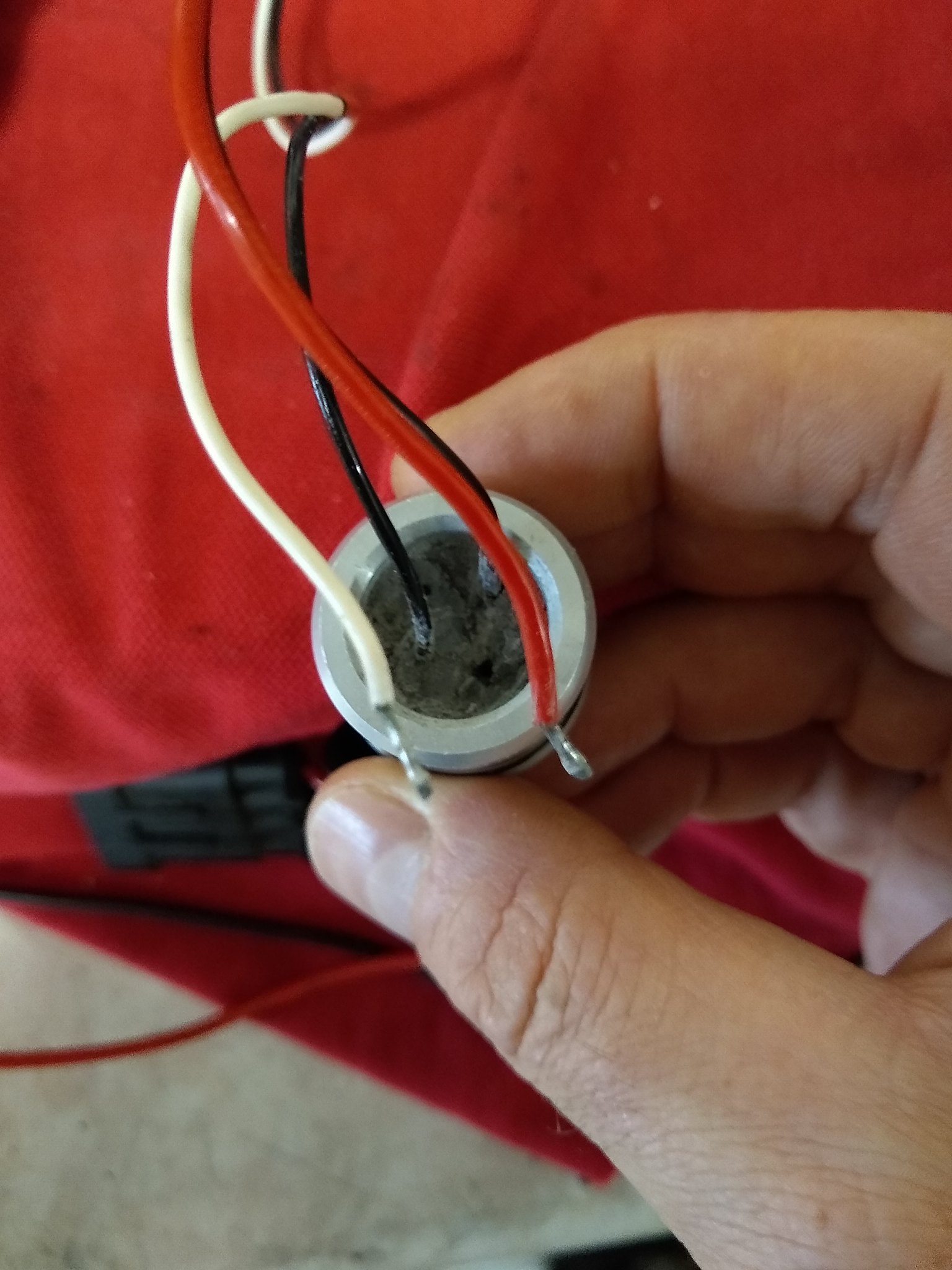

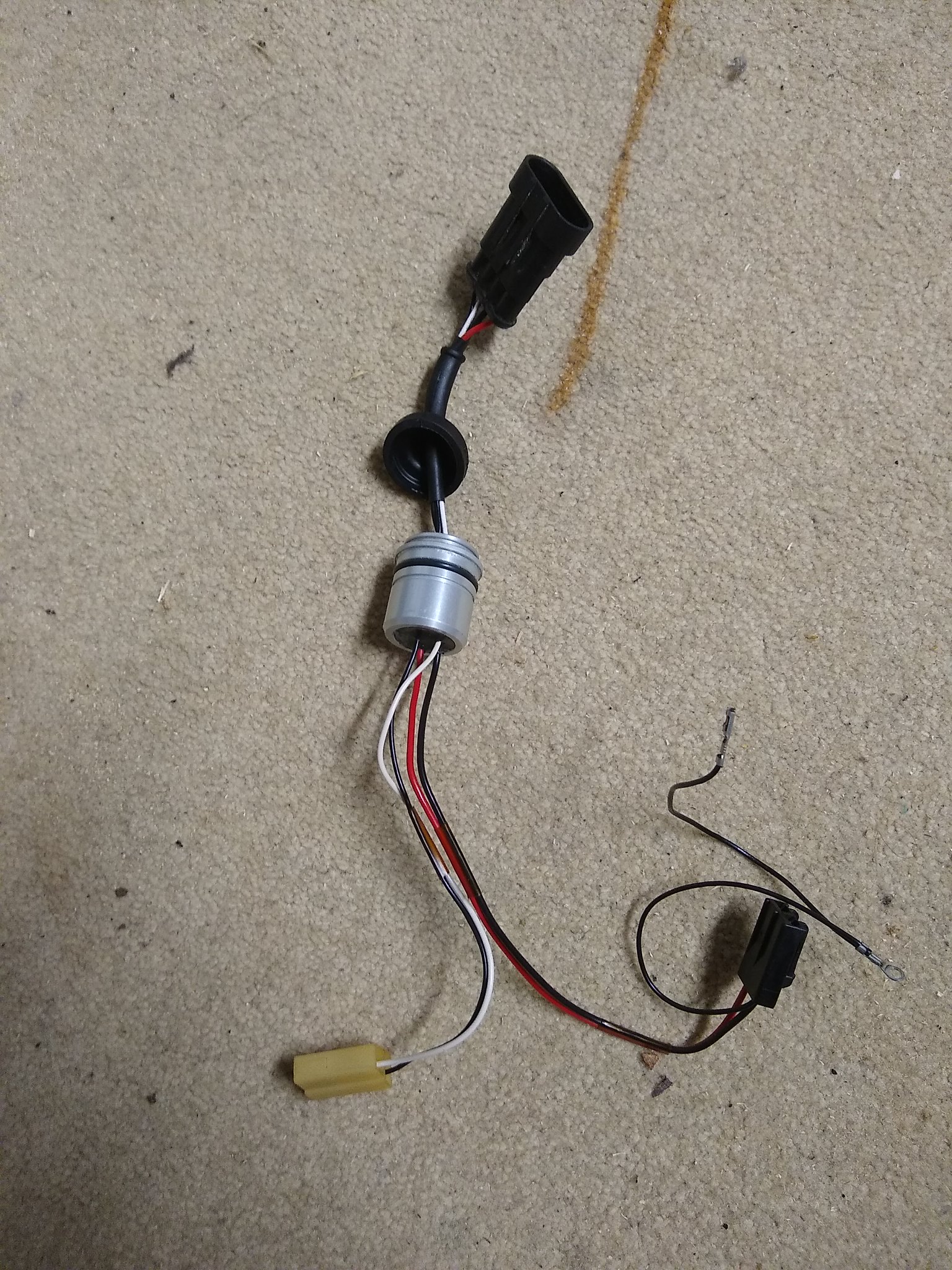

  6. I had something similar on my S2R Thou - the wiring to the fuel pump inside the tank had become damaged with leaning the tank too far back and therefore straining the wiring where it goes into the tank - worth a check. I'm guessing that we have similar fuel systems ?? You can buy new pump harnesses but fitting them is a bit of a faff but do-able
  7. Thanks for that Drax Dave, was fairly sure I had checked that but checked again and all good there.
