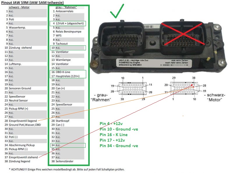

  2. On the 749/999 the dash gets the tacho pulse from the ECU. As it goes away when warm I wonder if you have a dry solder joint or broken cable fault.
    Could it be a faulty Crank Position Sensor?
    You can do some continuity checks on the cable from the ECU to the connector at the back of the dash (sorry don't know which pin it is) using this for reference. The ECU plug you are interested in should be grey. (ignore the cross and tick, that's to do with ECU programming and also the two lines). You're after Pin 9 on the 'grau' grey side of the ECU.

  3. Ok cheers Chris. I've saved the picture & will investigate this.
    Stuart
  4. I've just been looking at the wiring diagram for the bike and can find no output from ECU pin 9 to the dash on it. Does anybody know if the output is sent over CAN? That would be Pin 20 and 29 on the grey side to the dash Pins 8 (white/yellow) Pin 14 (white/red). The Crank Position Sensor feeds Pins 25 and 35 on the ECU black side.
