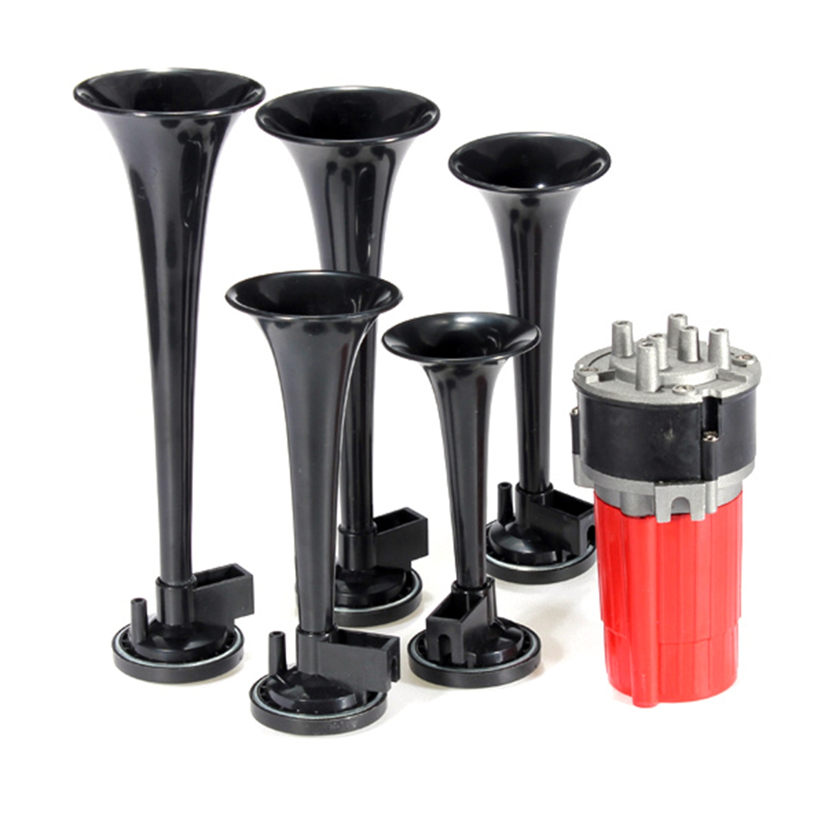

  15. 7709F3E5-14D5-4594-BADC-74A86EA083EC.jpeg Have you got room for one of these
    What a laugh that would be
