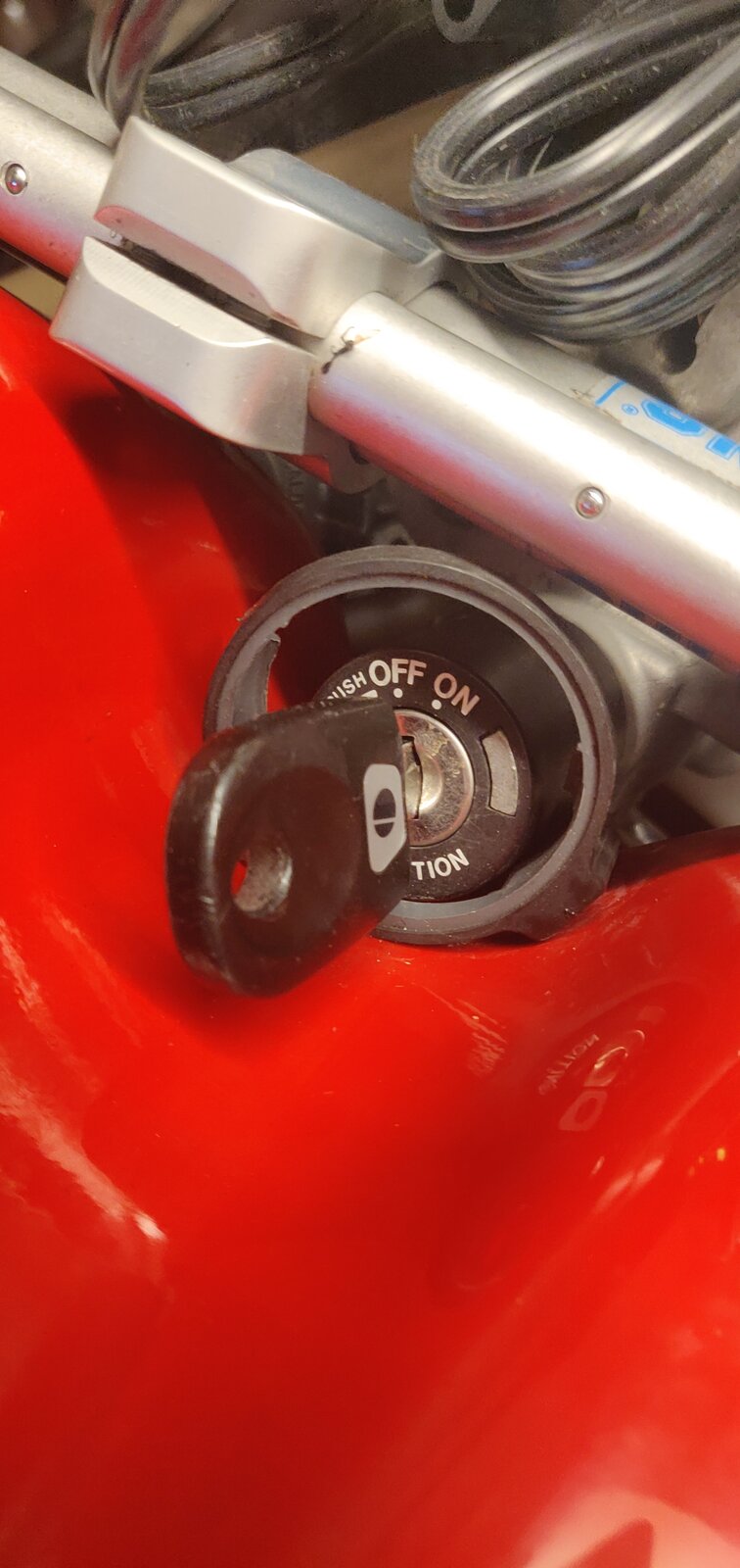

  6. I see your problem. If you can forgo the immo, then tape the transponder securely in the middle of the antenna ring and the hide out of the way on the bike. It is pretty easy to get the transponder out of the key.
  7. CODE only comes up if it’s an immobiliser problem and you can put in the code on your spare key to disable immobiliser.
  8. That's a interesting proposition. Might give this a go as I hate the antenna just hanging around the ignition barrel.
