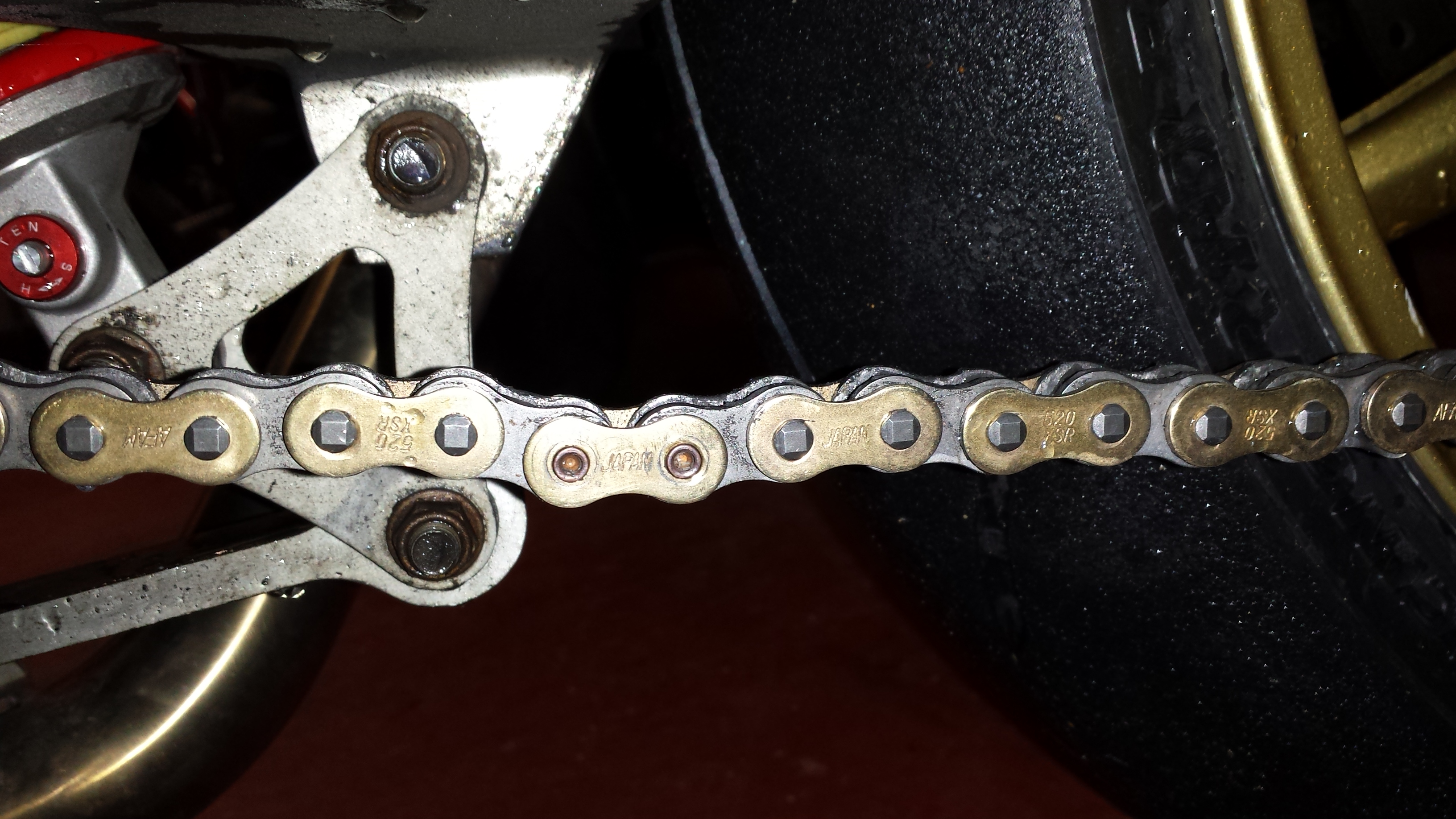

  1. I've just noticed after a clean that the chain on my track bike (Triumph Daytona) is kinked at the point where its joined. It runs smoothly over the sprockets but then comes out kinked like this. I can straighten it buy pushing it back up and theres enough friction there to keep it in line but it kinks again at the next sprocket.
    Any thoughts?
  2. Been crimped too tight. Remove and replace.
  3. Bugger. Thats what I was thinking it might be but didnt want to admit it! Can I just replace the joining section or is it a whole chain job?
  4. He means change the link........
  5. It's got a tight spot at the rivet link. It may have been pressed together to hard when being joined. You might get away with replacing the riveted link with a new one. These days most chains are supplied with small spacers or shims to fit between the plates when riveting the joining link to prevent overtightening

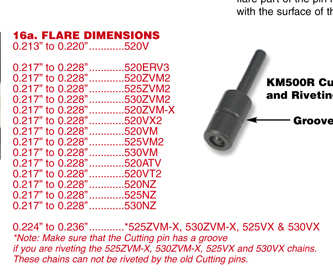

  6. Use this..............(the flare dimensions........they are for DID chains)
  7. Yep, just the link. 30min job. Grind heads off with dremel and use breaker to remove link. As Derek says they come with a wire spacer usually to prevent over crimping the plates.

    What do you mean by flare dimensions? Its got 520 XSR written on the plate. I guess thats the width of the chain (520) but does the XSR mean anything?

  12. When you flare the end of the pin it gets bigger dunnit?
    The dimensions tell you what sort of diameter the flare should be when done.......The list above are generally all 520 chains and the flares are all the same size, so I would start with the smaller dimension first (with a decent riveter, you should be able to go back to them and do them a bit more).
    If yours is DID (can't really see) then you can go nearer to the larger dimension.
