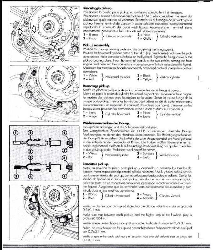

  4. The 97 SS Owners Handbook which seems to cover 900, 750 and 600 has the Auto Advance at from 0-1700 rpm (+/- 200rpm) @ 6 degrees and 1700 - 2600 (+/- 300)...progressive up to 32 degrees (check with strobe light).
    I assume that is 6 BTDC which sounds like a good starting point.
    However, got this from the earlier 900 workshop manual.......Hope it helps....
    AL
  5. Thanks ever so much! That diagram should help loads! I will update my progress as I go along :)
