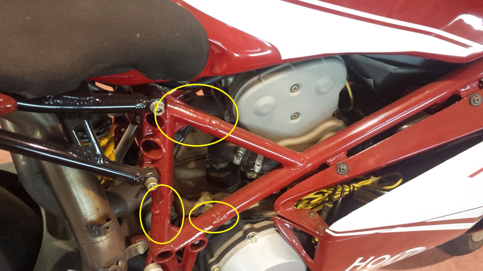

  9. I'm not entirely sure about the life of pre production bikes but looking at the bike itself, but whats caught my eye is the frame I have circled in yellow
  10. The original production had castings here instead of tubes - changed very early due to cost. Some production bikes left with these frames to Australia. You didn't notice the fuel cap then? :)
  11. The VIN history states MOT 09711-996 02 production date 17/07/01

  13. The tyres are slicks and have been well used so clearly not "stored away" as you have been told. This has scam written all over it so my advice would be to walk away. Andy

  18. It's worth considerably less than a regular 999 in my eyes. Why do they think this commands a premium? @Exige 's £4,500 seems far more like the true value. Walk away.
  19. 3 of these sold at Bonham's for circa £5500 each 3 years or so ago: all confirmed by the factory as pre production and purporting to show similar frame numbers which were obscured by added red paint - one was a 5 digit vin prototype :)
