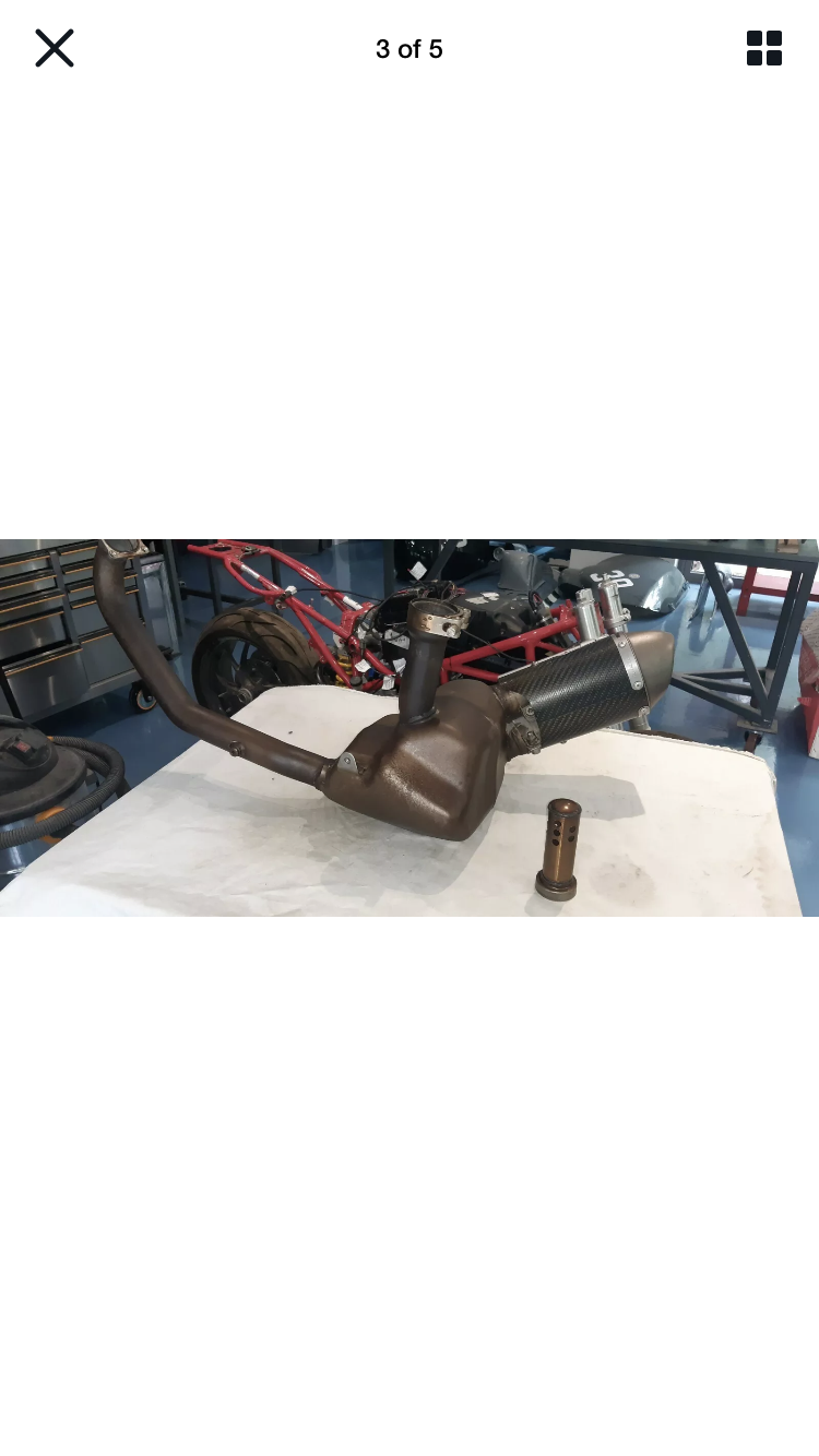

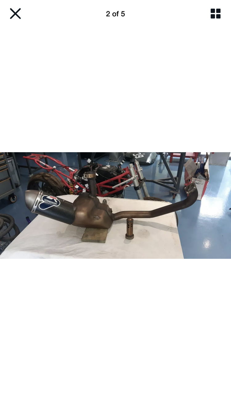

  1. I recently bought a system from a guy on eBay which was advertised as titanium but I am not convinced that it is.
    I was primarily interested in the Termi end can only as it turns out the downpipes are for a testeretta engine not the desmoquattro, but I was going to sell the downpipes on.
    Googling reveals that the only real world way to tell the difference between Ti and SS is by applying a grinder to see if it sparks white (Ti) or yellow (steel), but I can't do that without damaging it and I can't do that if I want to return it for a refund (the buyer is an utter tosser so there is little point in asking him if he agrees to me doing that).
    Applying a magnet is a bit hit and miss because some SS alloys are non-magnetic. The downpipes I was sold are either non or only very weakly magnetic but SS parts I have fitted to other bikes and hanging around my workshop are all magnetic to some extent, so this is not definitive.
    I have googled the part numbers but this only throws up links to eBay ads for OE S4R downpipes, which obviously leans in favour of the part I was sold being made from SS.
    This guy is an absolute a*se so if it isn't Ti, saying "it looks like steel to me" isn't going to cut it with him (or Paypal, if I need to make a claim).
    The part numbers are:
    572 1 142 1C
    DUCATI E3
    ZDM E10
    41R 0358018 (or maybe L41R 0358016 as the "L" might be a "4" and the final "8" might be a "6"). Please see pics (to follow).
    Thanks.

  8. Surely you just touch the inside of the header with a Dremel and then at least you know. Pictures are deceptive but doesn't look like any Ti I have ever seen.
  9. Email Ducati at [email protected] and give them the part number and ask - you will then have the definitive answer on an email from Ducati as evidence.
  10. Looking at the colour of it I would say it's steel. Titanium tends to keep more grey/blue colour. Also, as the stainless used on these exhausts is not of the highest grade then unless polished it will usually have spots of rust, a titanium exhaust will not rust in my experience.Usually have a much better and neater quality of welding as well.

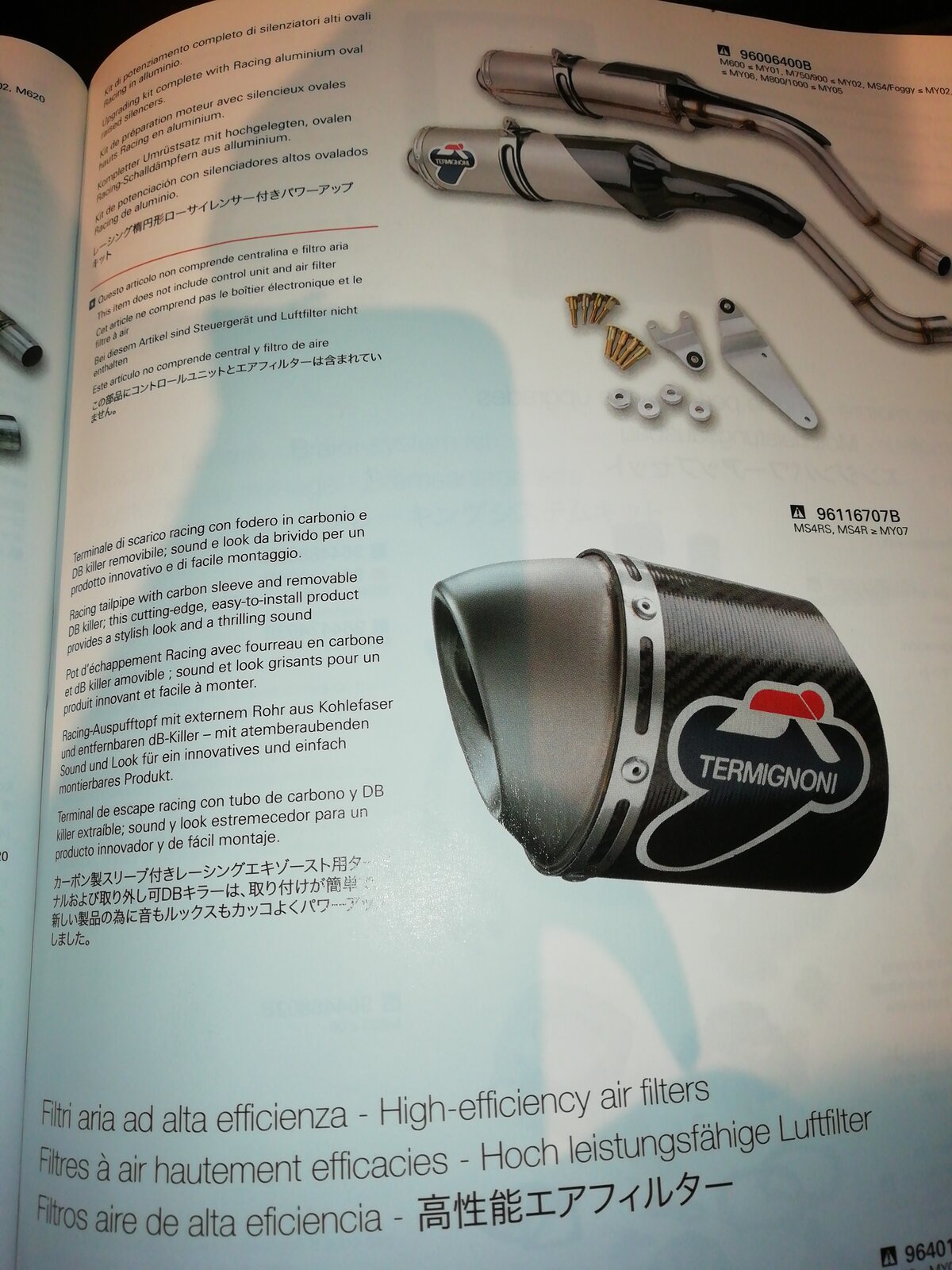

  12. Just had a look through the Ducati accessories book for 2007. There are no systems shown which are listed as titanium for the S4R or any other model of monster. Your photos show what looks like the "racing tailpipe with carbon sleeve and removable DB killer" part no. 96116707B.
    15928613088727630626448268895773.jpg It may possibly have a titanium end cap but no mention of it.

  14. Surely a ti system wouldn’t have a cat?
    Looks factory standard to me, with Temi slip on. ( not that it helps your dilemma)
