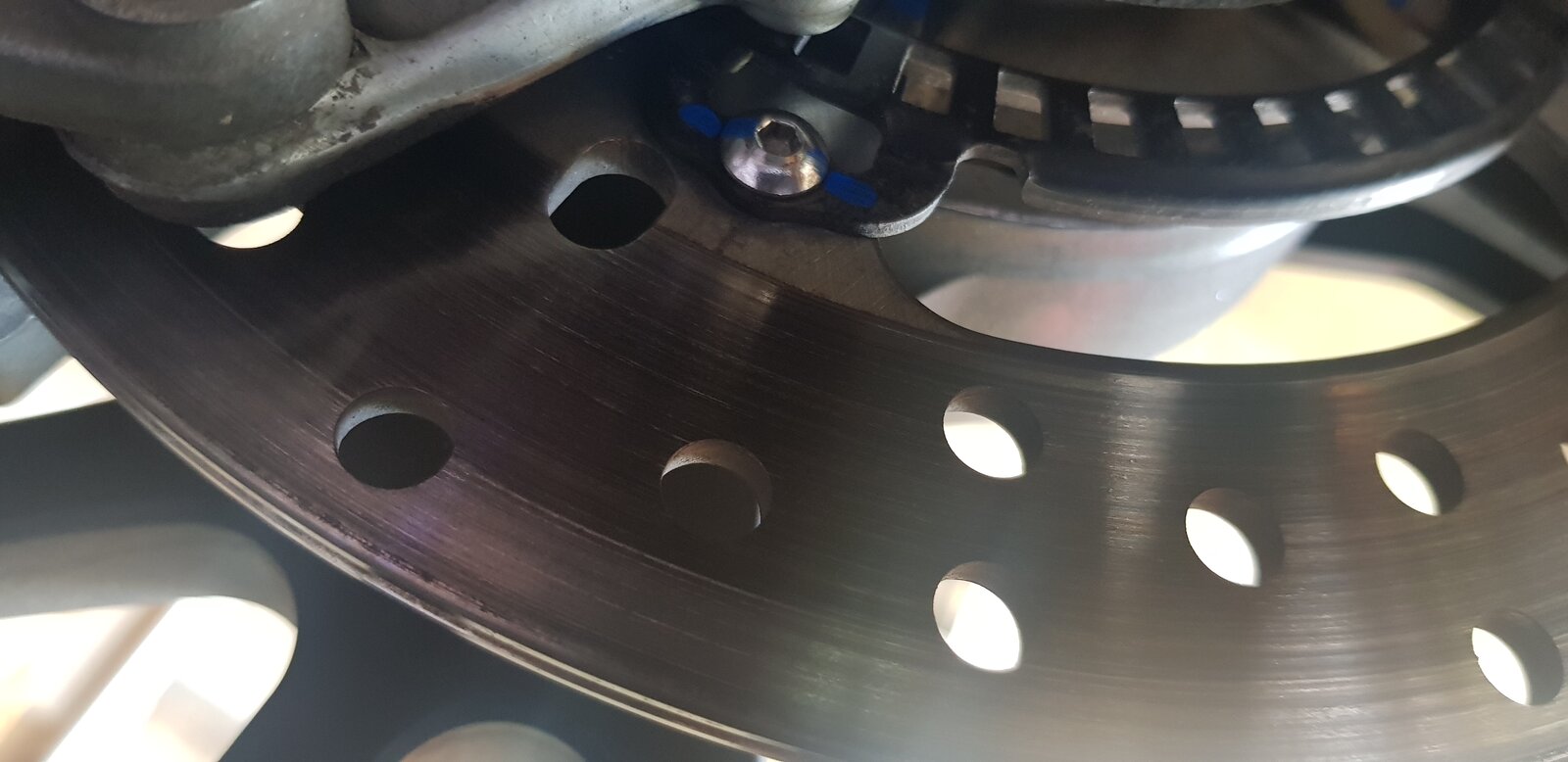

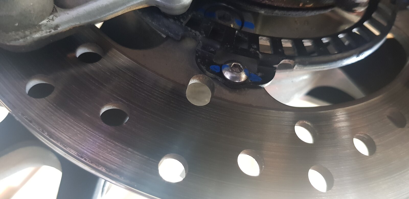

  4. On inspection, it is apparent that MR have at some time in the past, already addressed the tie wrapped loop in the cable. Mmmm, going to check the phonic ring gaps now. Andy
  5. So to close this out, 2 of the 4 rear phonic ring securing bolts were not just loose but nearly completely undone. Problem resolved but advised to look at the rear disc and rear phonic ring bolts routinely. Usually part of the 15,000 mile service but will now mark the bolt heads with yellow paint to aid a quick visual every time I change tyres. Andy
  6. Can you throw a image or two up about these phonic ring bolts?
  7. The bike is currently getting the Ohlins fork cartridges shimmed but happy to crawl around and get a picture or 2 when I get home :upyeah: Andy
  8. Pictures are taken from the left hand side. Andy
  9. Good that you got to the bottom of and an easy fix. Interesting that the loose phonic ring upset the ABS and hence the traction control but the speedo still worked.
  10. Cheers @Android853sp my rear was dinged from a mechanic changing the tyre a while back. Had to carefully ding/peen it back into a spherical shape now that I know that part's actual name!
  11. I guess the ABS/DTC is looking for minor differences between what the two sensors are reading but the speedo just wants a signal. Pleased it is a simple fix and caught just in time before a bolt head struck a bracket. Disappointed in myself because I checked the sensor/phonic ring air gap and failed to notice the loose bolts. Where is the face palm emoji when you need it ? Andy
