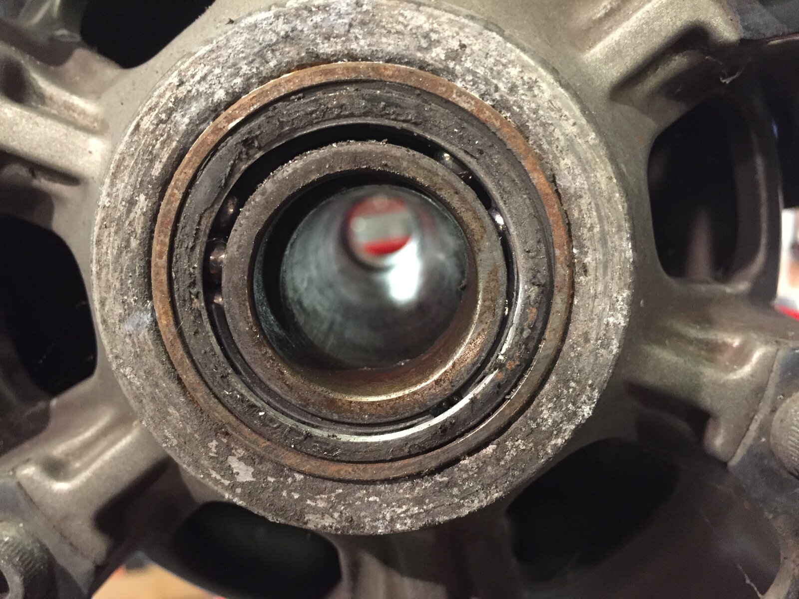

  4. Happened a while back, but according to shop, the previous owner had replaced the bearing, but as the wheel/hub was worn, it wore out again.
    MOT centre said it was fine!
    I felt it unstable so had Marcus at Rosse Corse take a look.
    Ball bearings literally fell out.
    With a new back wheel and new bearings, it is like having a whole new bike!
