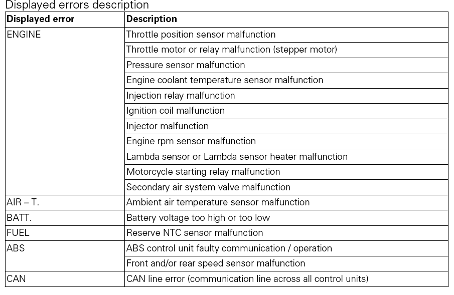

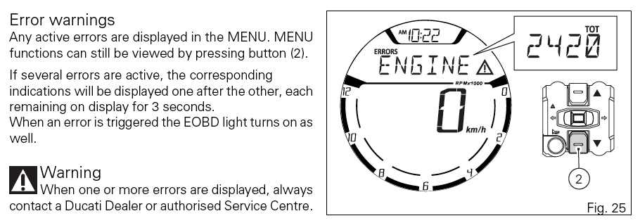

  1. ...a big 'ENGINE !' warning sign appeared right across the speedo this morning, alongside various warning lights. As soon as I let the clutch out, she died. Simple as that. I know nothing about engines (knowing where the fuel goes is just about my limit!) so any help would be gratefully received. It's a 15 plate, bought used from Metropolis in August. We all know they've gone belly up so I'm assuming my warranty with them is dust now as well. Is an 'ENGINE !' warning sign serious, or am I just being a pin head about the whole thing?
  2. 'ENGINE' doesn't mean the engine has gone tits up but one of it's components or sensors isn't working properly.
    These pages from the manual might help you determine what's wrong and you can take it from there.

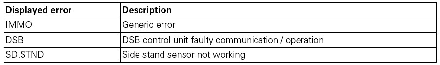

  6. Although it could conceivably be something serious, I’ll bet it’s something simple, so don’t panic.
    Dials usually light up with all the warning lights on as part of the start up procedure but don’t stay lit, so you barely notice it.
    I wonder if the dash threw you to the degree that you still had the stand down when you let the clutch out?
  7. I had something similar with my Multistrada. It turned out the sidestand sensor was knackered hence the engine cutting out when you release the clutch. The engine warning light as mentioned above is a generic warning.

  12. If the side stand is down or the switch isn't working it displays 'SD.STND'
    I missed this page:
  13. I'll look for that especially tomorrow.
