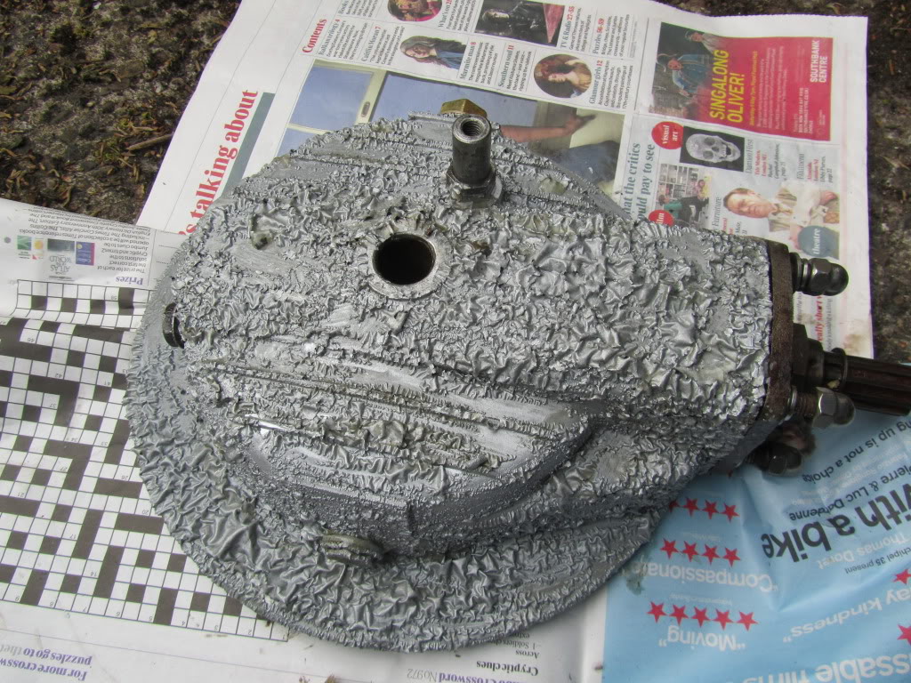

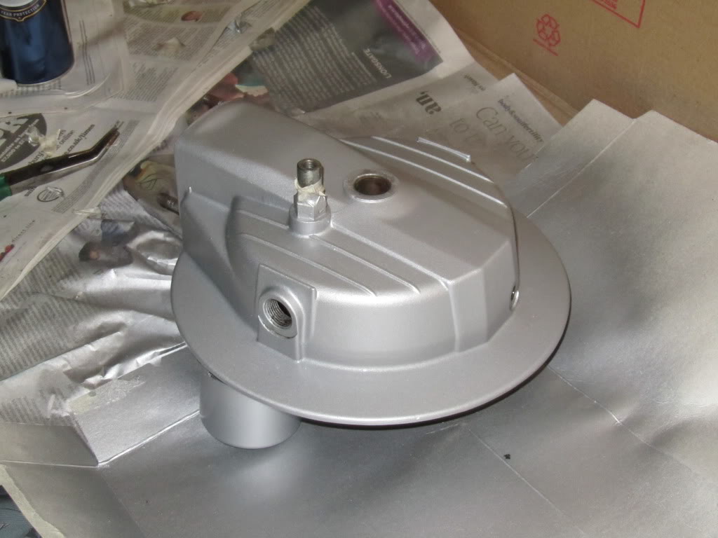

    I removed the rear bevel box and cleaned it up, then used that as a test to see how the engine/box would look if painted. First I used a tin of Smooth hammerite for non-ferrous metals as an'undercoat' (as normal Hammerite doesnt tend to work on alloys). That didnt look too bad, but having to use a brush meant the finish wasnt as good as I wanted. So then I sprayed on a few light coats of 'normal' smooth Hammerite which ended up looking not too different from bare alloy. Hopefully I can use the same process on the rest of the motor and gearbox

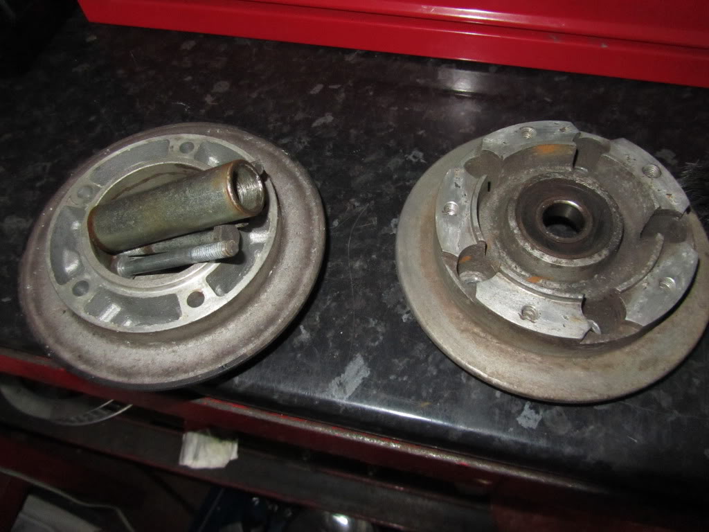

    For example, here are the front wheel disc mounts, which hold the discs to the wheel hub, they were badly corroded, but were easy enough to clean up. I could've kept going and polished them to a bright finish, but thats not what I'm aiming for, I dont want to 'over finish' it, and end up with a bike that I'll never use, for fear of getting it dirty.

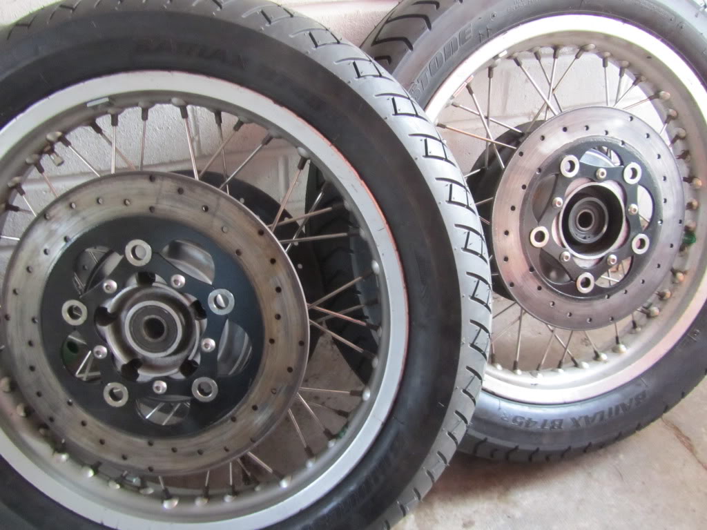

    The wheels and brake discs have been cleaned up too, with new Bridgestone tyres (BTW the tyres have been the most expensive part of the whole build to date...)

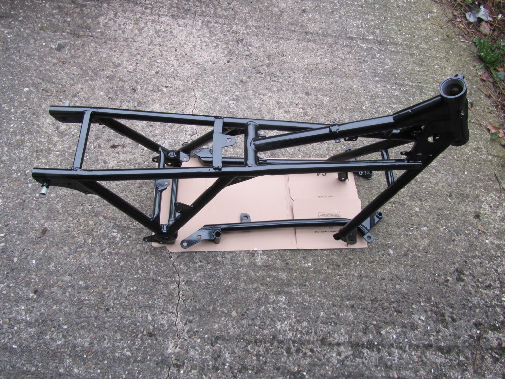

  12. When I collected the frame from Vanden nr Bolton, I was happy with the quality and the price (£80), though it wasnt as good as Triple S. They also gave me three extra problems to sort out.. .
    First they forgot to mask off the swingarm thread, so now I've got to find a suitable tap to clean it up. Second they haddnt protected the original chasis number plate on the headstock, ( I should've ground off the rivets and removed it before powdercoating). You live and learn, the frame number is still just legible, but the plate had curled in the heat of the oven. I ended up removing it, leaving a patch of headstock bare. The third problem was that they hadnt bothered to protect the headstock bearing seats from the bead blaster, so they would need to be replaced.

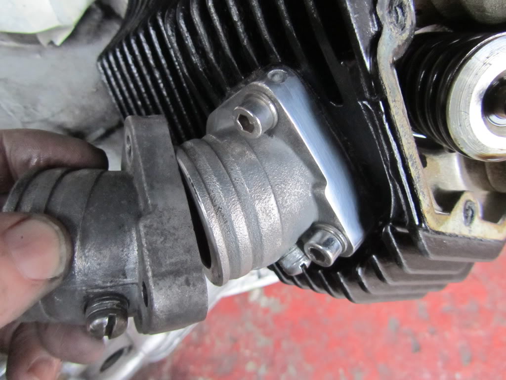

  14. I painted the barrels with hi temp satin black from Halfords, which went on ok, but it needed a few coats so far. I then decided to polish a few of the cast parts (displacement activity lol).. such as the manifolds, before starting on the valve covers. These were a pain to remove as a couple of the socket headed bolts were rounded off, and I had to drill them out, but luckily got them out without damaging the threads in the head. The manifolds look ok, but still need to be finished on a polishing mop, but that will be done when all the alloy parts have been cleaned up, I bolted them back onto the heads, just so I dont lose them in the meantime.

  18. The next task was to fit the swingarm and bevel box, which went ok, until I stepped back to admire my work and realised that the bevel box that I'd painted in Hammerite smooth silver looked out of place, now that I'd decided to leave the motor unpainted.. Despite the extra work it would create, I couldnt live with it, so I stripped back the paint on the bevel box, and will clean up the alloy as best I can.

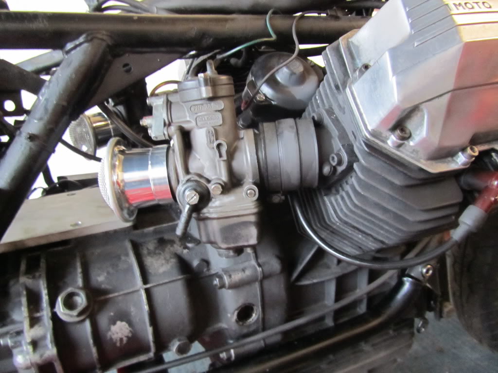

    That done, I cleaned up the carbs, though may use an untrasonic cleaner if I can get the use of one as a favour. Just to see how it looked, I fitted the velocity stacks and mounted the carbs to the motor.. Quite pleased with the result..

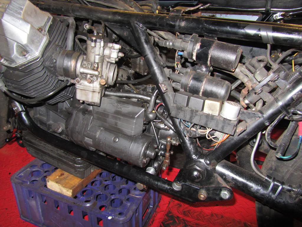

    I was pondering what to do about the gearbox tray, and annoyed it had been so badly made that the mounting holes were way out. Then I had one of those 'duh' moments, when I turned it upside down and tried again.. it fitted much better, still not perfect, but usable. So I popped over to see my mate Jeff with yet another 'can you just...' and between drinking tea, scoffing biscuits and sorting out his laptop for him, Jeff machining out a slot in one end of the tray, so it would sit nicely against the frame cross brace and countersunk the holes for me. Now all I needed to do was to widen a couple of holes in the frame mounts slightly and it fit fine.

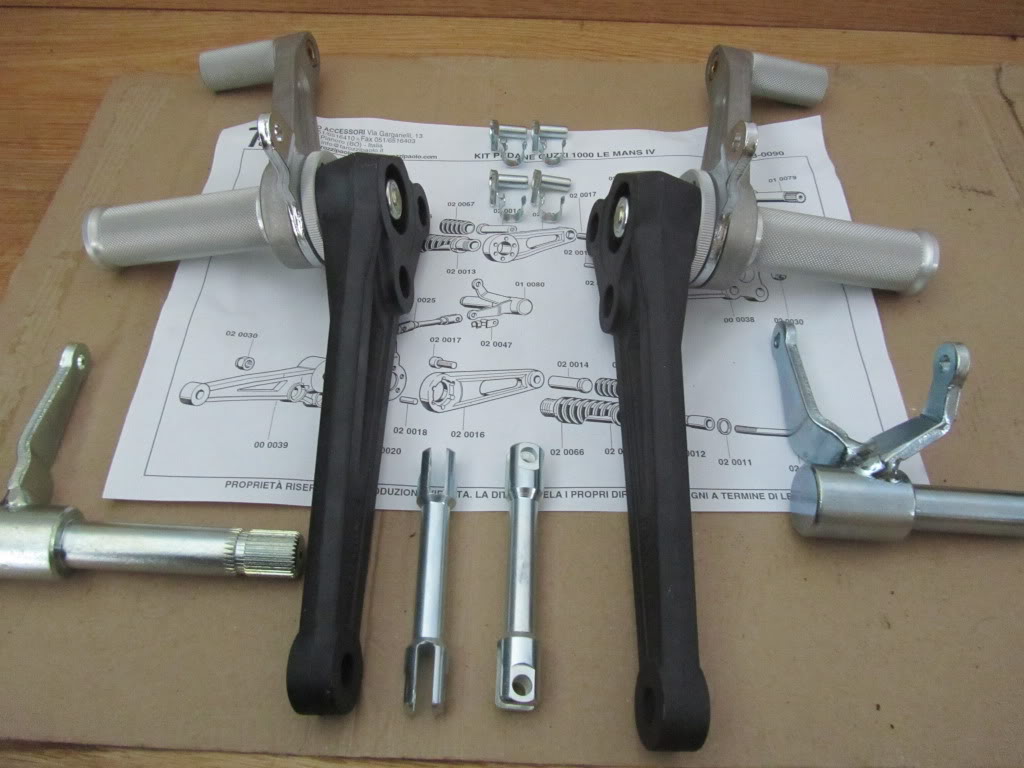

  20. After finally sorting out the alloy battery tray and fitting the starter, I decided to test fit the Tarrozi rearsets that I bought months ago. I laid out the parts, seemed like there should be more, but we''ll see..
    It soon became clear that I was short of a couple of key parts, I compared what I had with Ian's racebike (where I got the bike from) as he had Tarozzi rearset too. First a link rod on the brake side, and a splined link arm on the gearbox side... red arrows..
    I guess that's what happens when you mix and match parts from different models.. The link rod wont be a big problem, I can make one, but the splined link arm will need to be found from somewhere..
