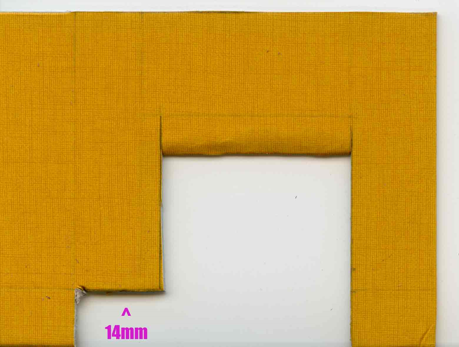

    Setting the float height can be tricky to do accurately, so make yourself one of these.
    According to Al, the 14mm dimension that everyone said to use at the time is wrong but the principle is the same and I'm sure he'll give you the correct dimension
  4. I don't know why it got attached twice... :/
  5. Unfortunately there isn't a specified dimension to set them at - just one that is right - 14mm IMO is wrong because it makes the fuel level too low and thus the pilot circuit doesn't work well. I would start at 12.5mm. But the only way to get them spot-on is to get it on a dyno.

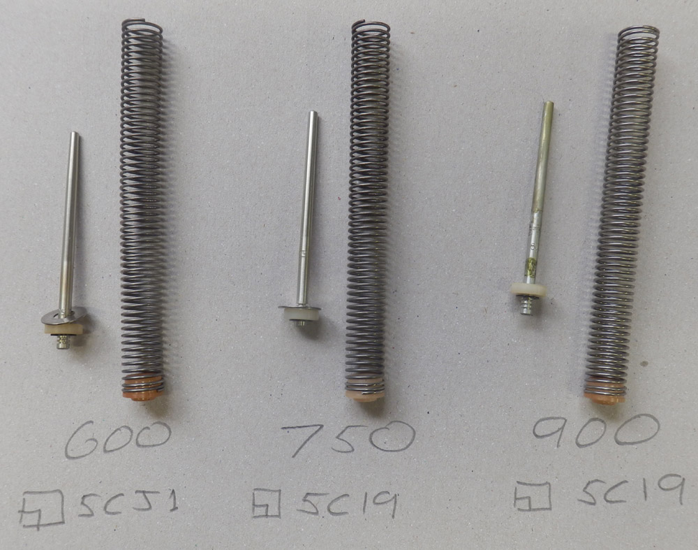

  15. Couldn't wait, so popped back out to the garage and took an image of the three different needles and springs.
    Perhaps none of them are Dynojet, as all three needles have the Mikuni Square within a Square logo stamped on them.
    They also taper quite uniformly, and I seem to remember Dynojet needles having a bit of a curve to the taper.
    What do you think Arquebus?
    The 600 ones markings were difficult to read, I think it's 5CJ1
    Both the 750 and 900 read 5C19, but are in different circlip positions.
  16. None of those items are Dynojet - and the square logo is the OEM Mikuni mark.

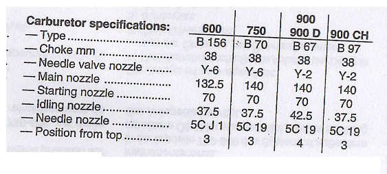

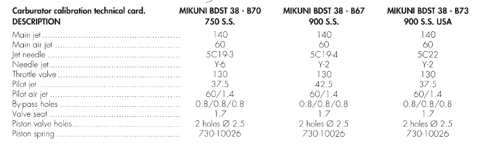

    Here is another extract - this one from the early-ish workshop manual.
    Don't take my word for it, but IMO all the BDST38 carb bodies are the same - I think the different carb types Ducati refer to is actually a simple form of part number for each engine capacity etc.
    It may relate to the emulsion tube type and/or the pilot jet type - some have a single hole all the way through; but others have cross drilling as well which pre-atomises the fuel (and they make the engine run richer).........but they are respectively the same in overall dimensions and shouldn't be mixed ie one of one type and one of the other.
    I know that both the 750 and 900 ones I had, were the 'solid' type.
