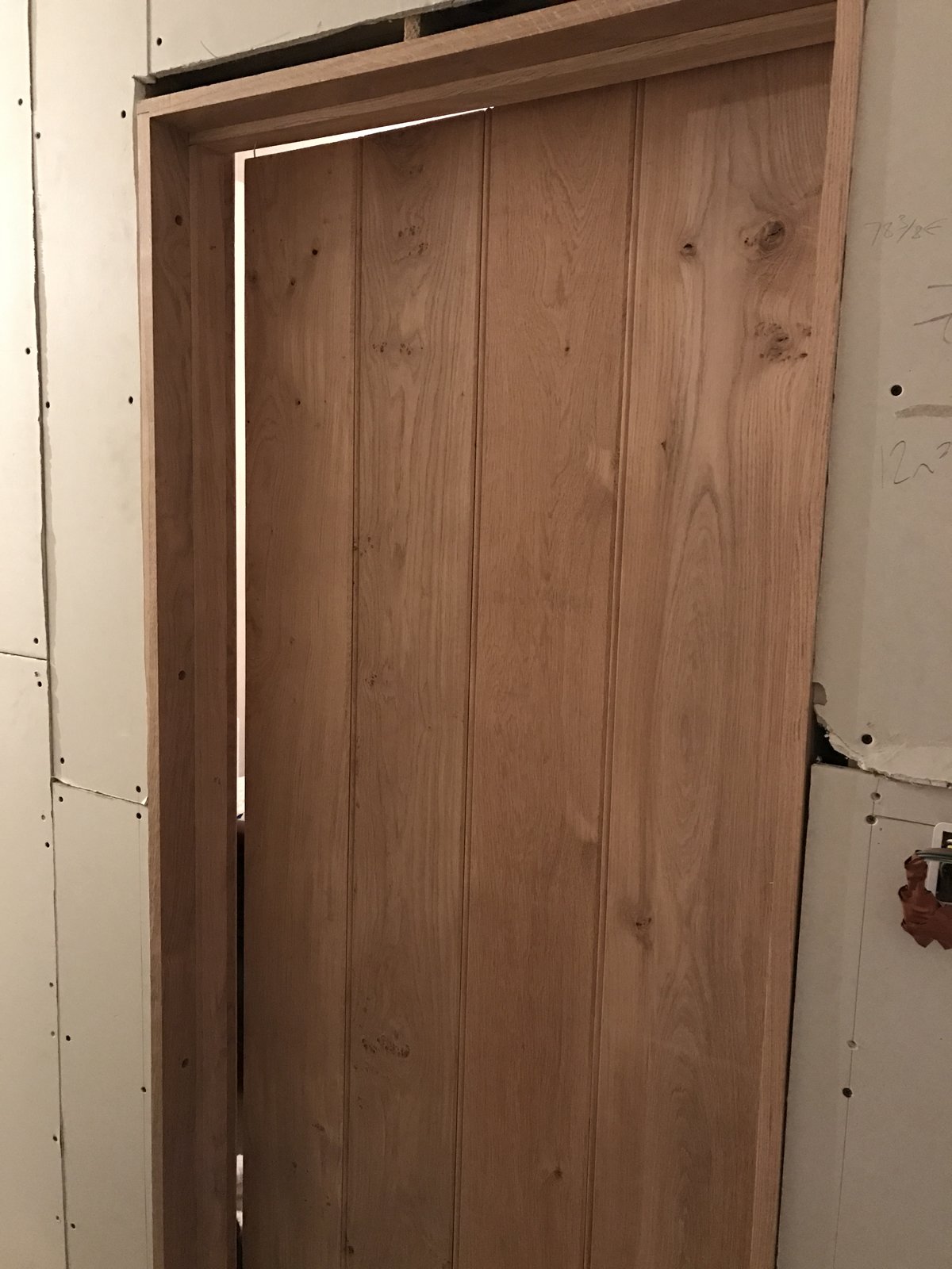

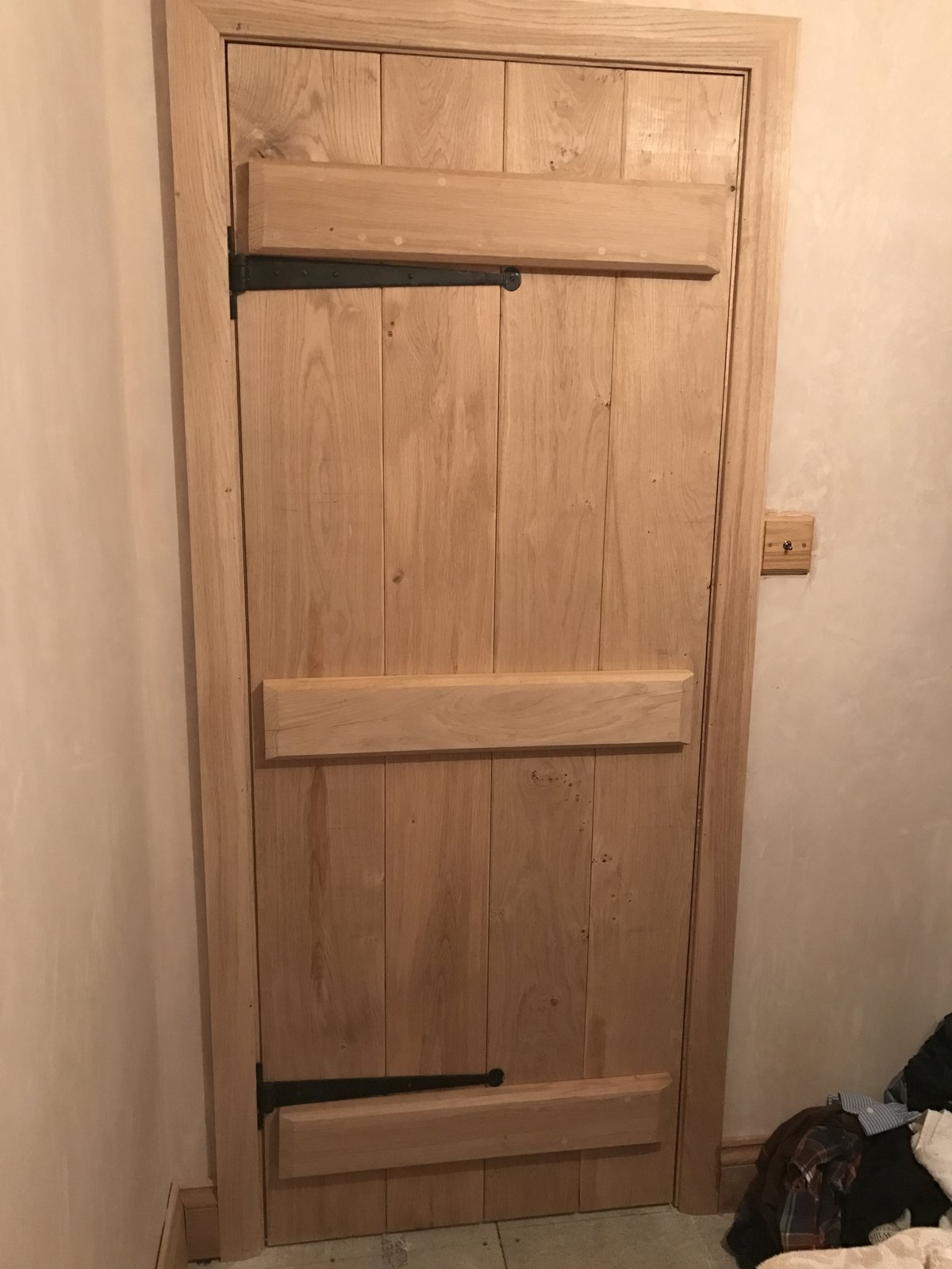

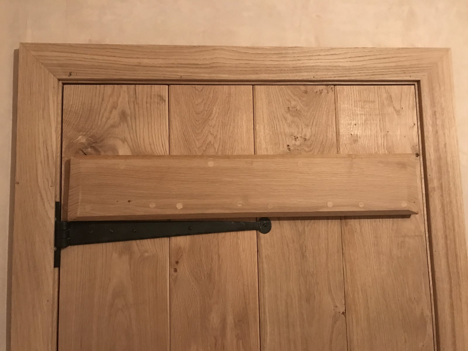

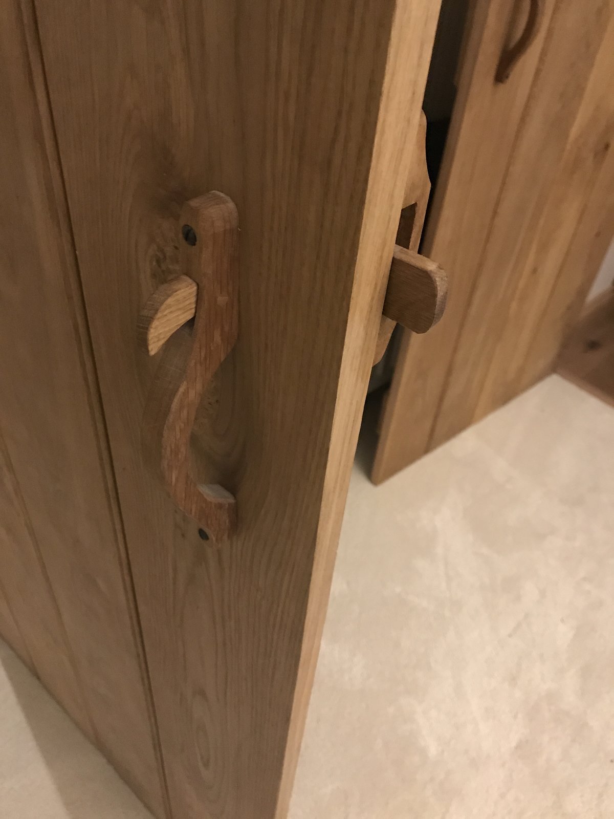

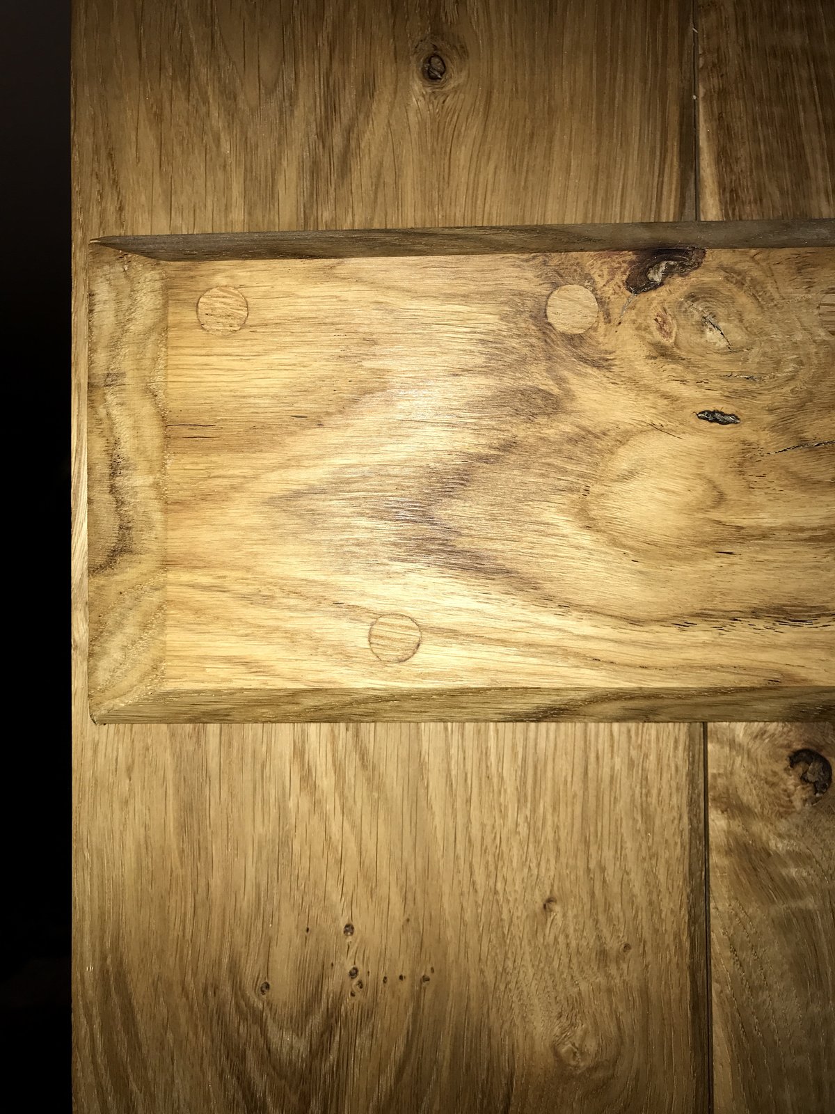

  9. Not close enough to you and not sure what style you’ve got planned but... here’s ours made by a local guy (Kent).
    All oak and we’ve had oak latches on them too. Beautiful work and probably my favourite part of our entire extension.
    CECEBBF1-FFB4-4E4C-879A-2682F3087A9A.jpeg BCF5A153-9465-47A4-8455-5632685D24D6.jpeg 3956F273-2FD1-4697-90D7-E1247A41F4D7.jpeg 1D0A36E8-88CB-4C67-BD86-B92C21D35D2E.jpeg 38C6735C-558F-4242-BF31-56677A7B0444.jpeg
  10. @JH_1986 Nice doors but I think you need braces on them or they will sag in time.

    How would they help? :thinkingface:
  12. Come on now, don't tell me you need an explanation. It's obvious inn't : unamused:
  13. I know... we have 3 horizontal braces and each brace has numerous screws (covered nicely with pegs).
  14. It stops the door having an overbite :)
  15. No JH, those horizontal timbers are known as ledges, the brace is a piece of timber going diagonally from the lower hinge side ledge to the upper clapper side ledge, this is what stops the door dropping.
    Did he fit the doors JH ?
  16. No, we went supply only as builder was doing the extension and had quoted to fit all new doors. His joiner that did the work was very good and he said the doors were good. Our garage doors have braces due to the size, but from what we were told/looked up, not entirely necessary on doors that size.
    I suppose time will tell.

    Latches are a nice touch :upyeah:
  18. 3 ledges, each with 3 screws and plugs on each panel.
    Latches are lovely and he did the WC & bathroom doors with sliding oak locks too.
