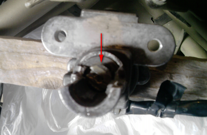

  4. I have some experience of the insides of a Ducati ignition lock ....
    .... I got it the hard way !
    This is from the ST4 and has the lock cylinder removed ....
    the " precision engineering " was done with a large screwdriver and hammer ,
    during a failed theft attempt .
    The switch can be operated with a screwdriver in that slot ( shown with an arrow ) but there is still no access to the electrical contacts .
    They are in a metal box , along with the steering lock mechanism , underneath the lock body.
    There are two rivets with pointed heads , and these would have to be drilled to get at the contacts directly .
    Other than that , I think you would have to flood the contacts with
    switch cleaner while constantly rotating the key , to have any chance of getting things working properly .
    And if the contacts are damaged or worn , I reckon you are out of luck ....
    .... sorry to be the bearer of bad news !

  5. That's a bit of a shame. I'd seen an article on Japanese lock barrels and that seemed easy to get to the contacts and had hoped the Dukes were the same. How did you get your lock barrel off the bike? Did you drill out the bolts?
    As I'm not looking to sell the bike if I can't get the lock barrel to work I'll probably just fit a switch to turn ignition on and keep key for the steering lock.
  6. Yep bolt head smooth & threaded in side. I'll try bolt & nut then if that fails go for the pliers.
    Sounds like I'm going to have issues getting to the contacts anyway but at least I can replace bolts with proper allen head ones.
