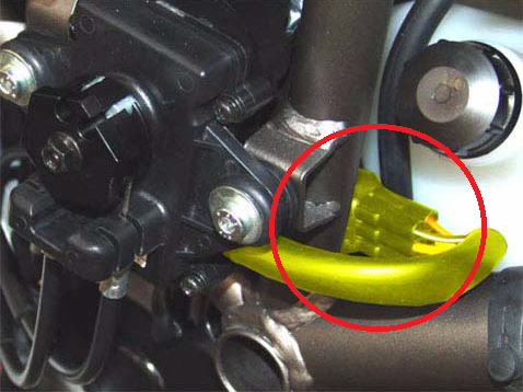

  8. Brill ta, saves me a big search! Do the sensors go into there too? The wires just seem to disappear into the motor area somewhere...
  9. The 4 way superseal connector for the Lambdas hides themselves away in the void behind the EXBV motor (Where D is pointing to)
    Don't forget to put some insulating tape or shrink wrap over the connectors to protect them

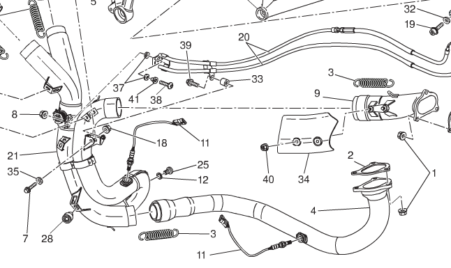

  11. Just checked the parts catalogue and the EVO does have 2 lambdas
  12. Yep, the the back one is in a ridiculous place.
    assume 18x1.5mm bolt? Ebay seems full of those
  13. I see you've got them off the bike. An ideal time to get rid. Yes the blanks are 18mm x 1.5
