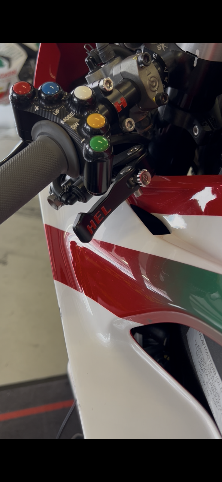

Yup, you need the module, but cheaper versions are also available. My switch gear is a bit “race”, but data is the same I think. Go to the track, start a lap, in my case pull the “start lap’ button, then every time you cross that point a lap time will end and another starts. At the end of the session you can see all your laps, best lap, top speed, but not sectors. I think there are also some track layouts stored somewhere in the menu.

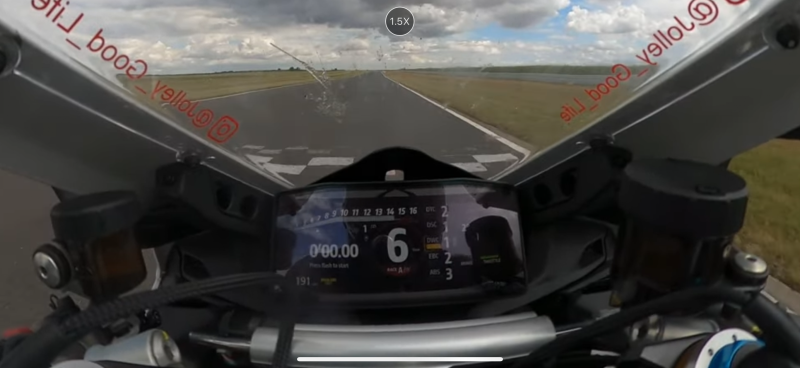

I have the AIM EVO data logger installed, but need to obtain a Windows PC to run it….. I do like the way the V4 dash speedo goes blank above 185mph
The V4 dash did go blank after 186mph on my 2023 (until I installed the Evo software), however the 2025 definitely reads a little higher. I have seen at least 188mph on the 2025 (I will look for a screenshot - found one showing 191mph, though I am sure I have seen 193/4ish before it flicks to ---).
