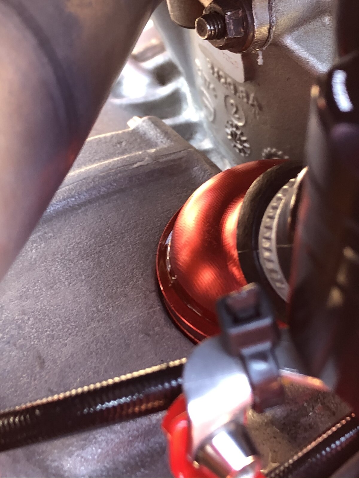

  3. Just the oem carter ventilation and that is a one way valve
    It is because i have high pressure pistons
  4. i have exactly the same pistons and dont have the problem, and in any case they are high comp above the piston crown not below.....is there any gubbins inside that crank valve..i know some engine builders will take it out to elevate crankcase pressure and or resistance, though it has to go somewhere........

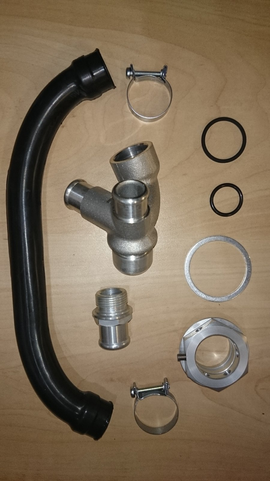

  5. if the engine is ok i would come from that valve to a catch tank some where mounted to the side of the bike ( like the 999RS one, and the 998RS one which is under the seat) and then route back up to the airbox with a one way valve somewhere further away from the engine Effectively increasing the size of the crankcase area...
  6. @DjCalix had a 999rs breather for sale a while ago.
  7. There you go .. see if there’s a video about it?

    Have you got a picture of the inside of the valve?
    How much oil in the airbox are you getting?
  9. what do you mean with gubbins?
  10. yeah I think the engine is ok because it is completly rebuild so that must be fine I think. If want the rs solution then I need a monoframe I thought so?
  11. yeah I had this before but it was complete gone when I replaced the breather on the crankcase but now the valve is not broken so it must be something else
  12. #13 Boukekoppejan, Apr 26, 2020
  13. The bits inside are they still there or been removed
