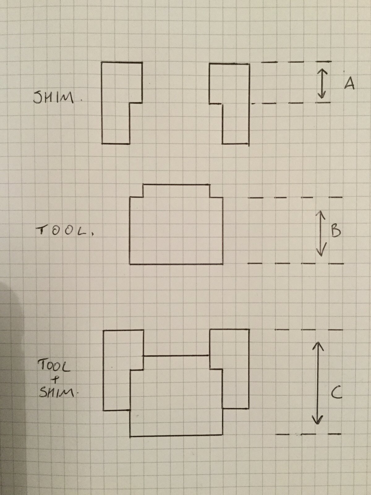

    See attached pic, if the shim measurement is “A” then what would be the point in measuring the whole of the tool including the raised part above the shoulder? To work out the shim thickness “A” should it not be:
    C-B=A?
  4. I think you are visualising this wrong. I haven't got time now but will get back to you in the morning. Although someone else will probably chime in.

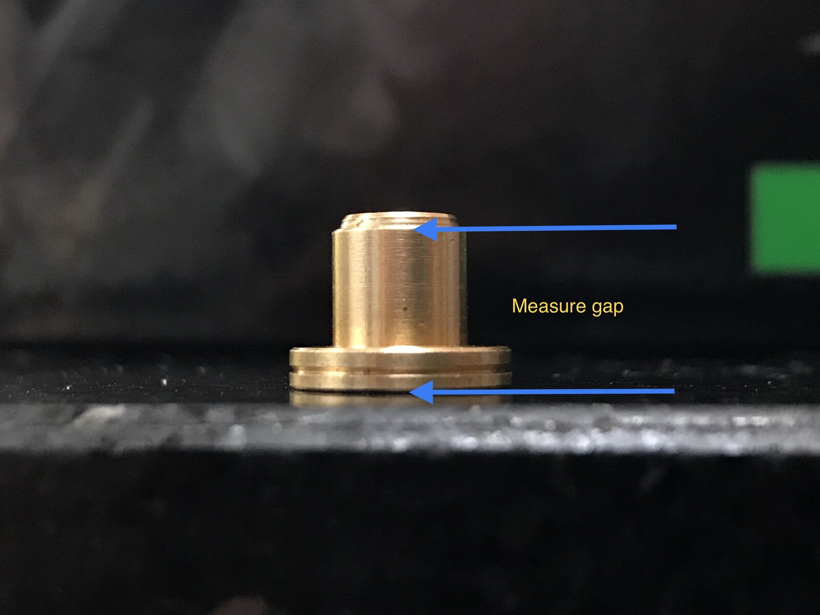

  10. Just to clarify what you should be measuring.
    This diagram that I drew a few years ago is of a 2V closer but the principal is exactly the same.
    You will see that the inside of the shim has a radius at the bottom which the half rings sit against. The measurement should be from the bottom of that radius to the base of the shim, as shown.
    I'm not familiar with the Lazer tool as mine is one that I bought from Tony Brancatto about 15 years ago. It has a 7mm boss projecting about 1mm at the top which fits into the hole where the valve goes through and centralises the tool in the shim. Below the boss is a radiused section that matches the radius in the shim. The distance from the bottom of the boss / top of the radius to the base of the too is 10mm. So you simply subtract 10mm from the micromter measurement.

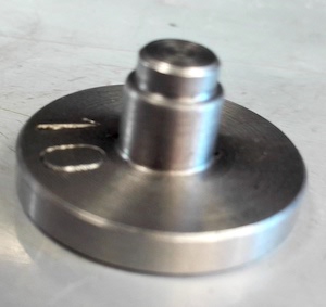

  16. This is the Brancato one that I've been using for the last 15 years or so. (sorry the image isn't quite sharp)
    I've had no problem with it.

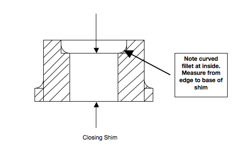

  20. FWIW the factory manual process to obtain the dimension Derek refers to is attached, their diagram may be helpful
