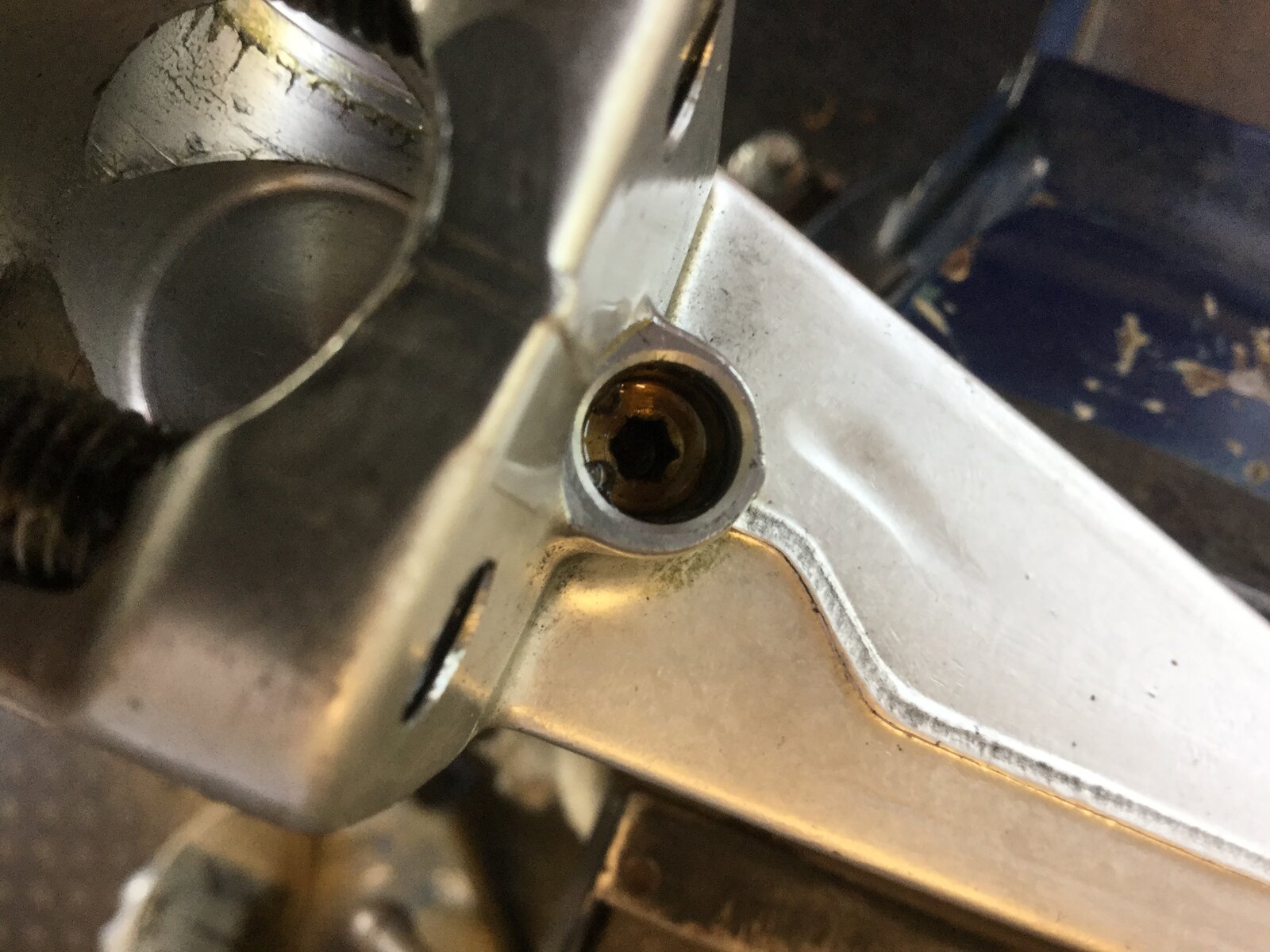

  10. Mine not like that!
    Pic to follow.

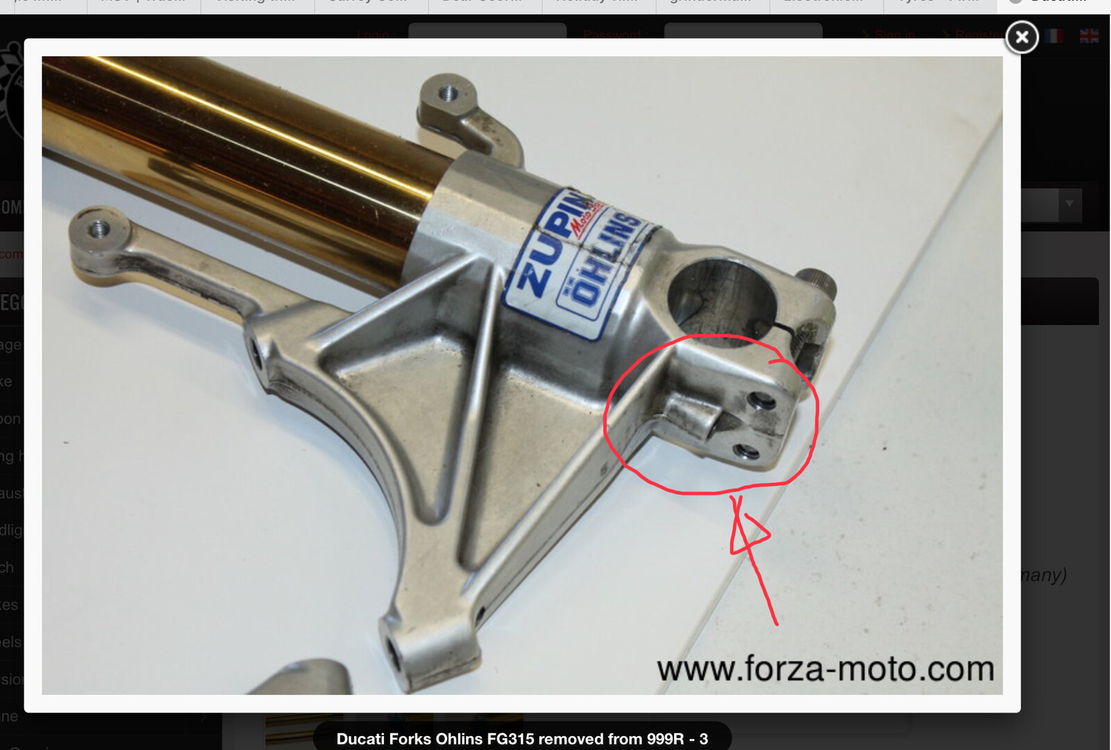

  11. 749/999R have FG315 forks as in below “library picture”
  12. Ok so it's going to be the same principle, either it's held in with a circlip as you can either see or not, or it's held in withg a threaded collar as per picture I put up.

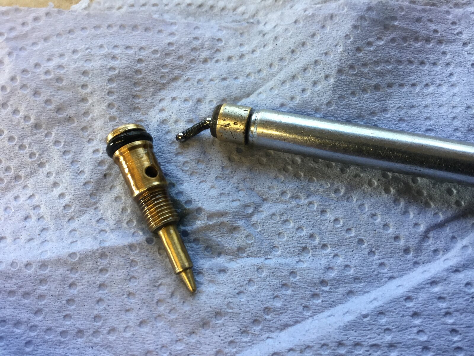

  14. I can confirm that it is possible to remove the compression adjuster screw from the bottom of 749/999R FG315 forks without losing any fork oil if the fork is removed and put upside down.
    Points to note:
    The circlip is teeny and the eye ends are easily broken (did this)
    The trickiest operation is removing the valve once it is fully unscrewed as the seal creates a suction and the valve needs to be carefully eased out with suitable tools - pick, Swiss Army knife tweezers.
    Watch out for the teeny weeny spring and balls as they may go “boing” never to be seen again (didn’t do this, had my magnet at the ready!)
    Otherwise, piece of piss.
    Just hope P&H have an o ring and circlip.
