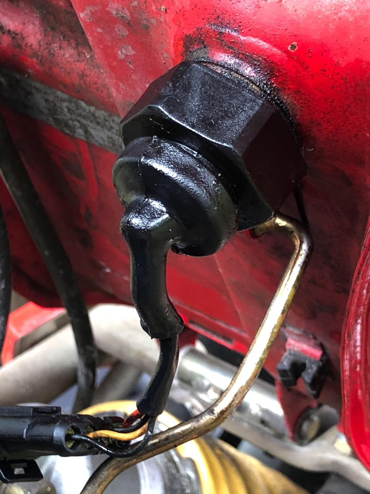

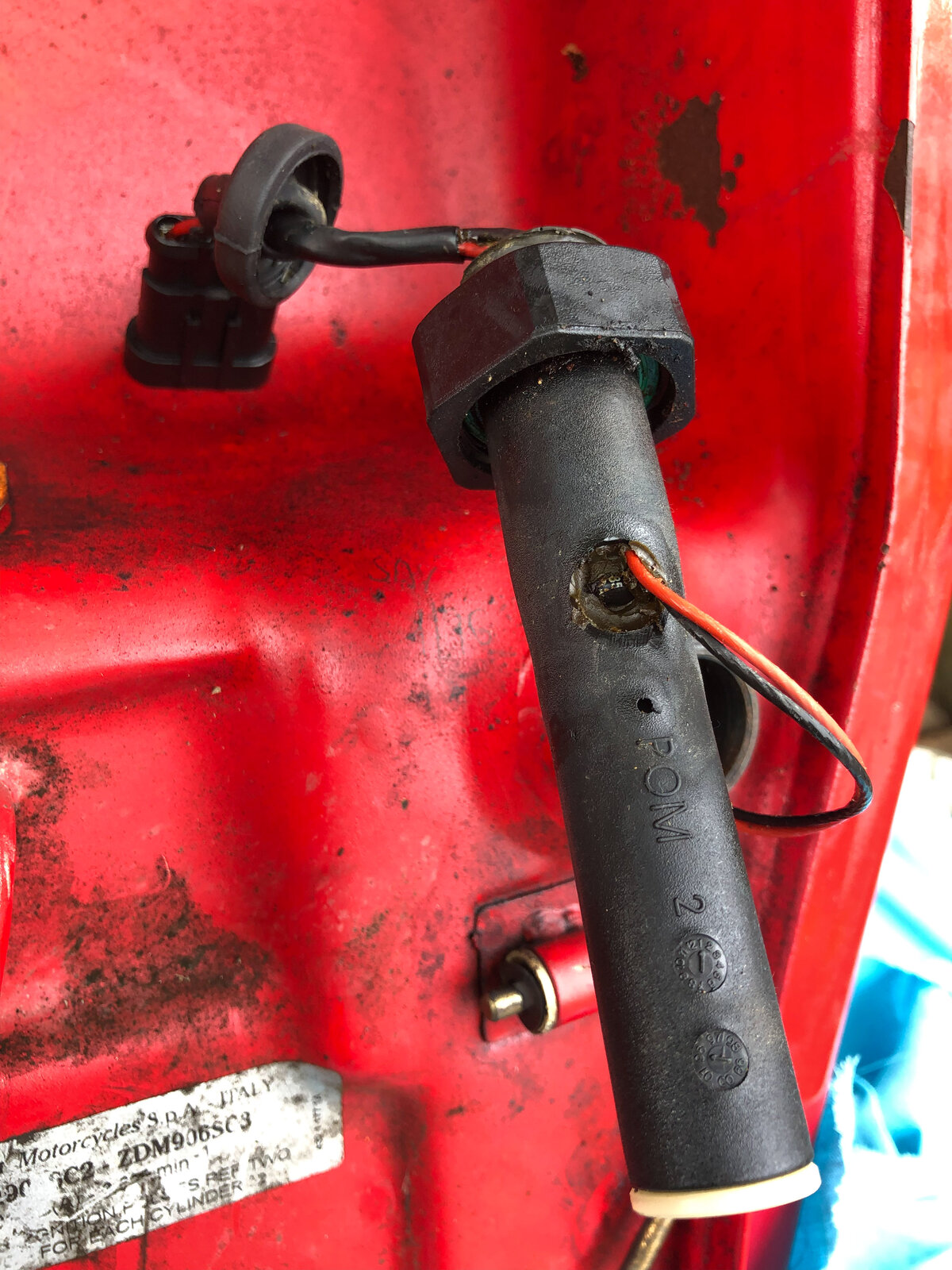

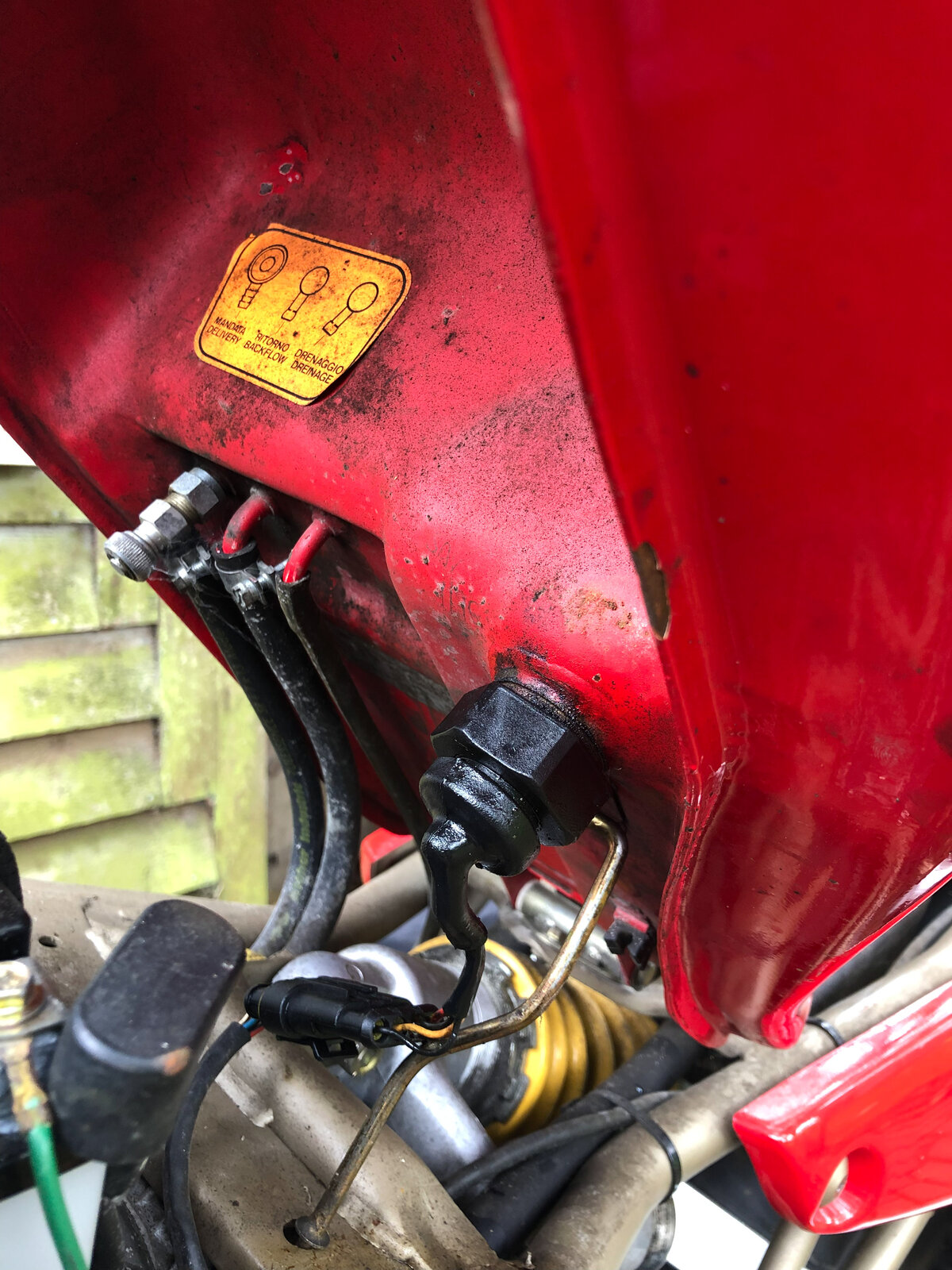

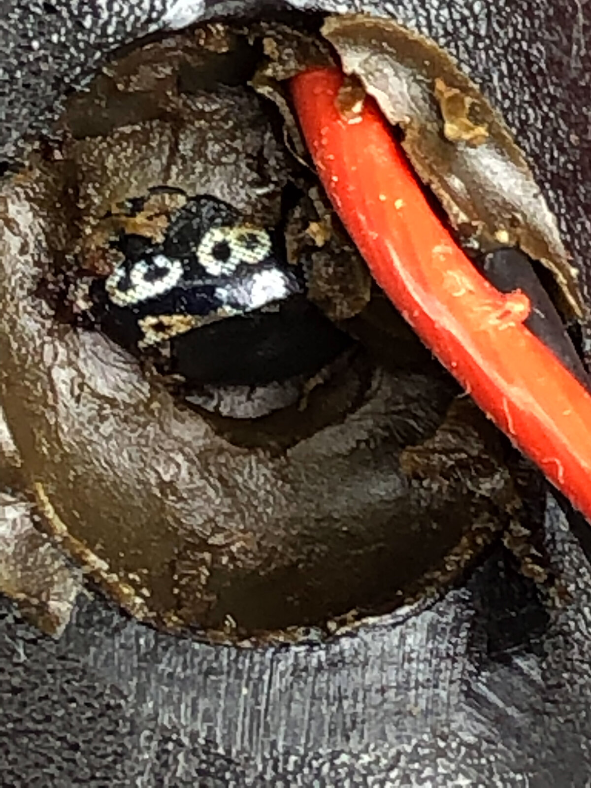

    I have just noticed that I have fuel leak from where the power cables to the pump enter the underside of the tank. I have checked and its not leaking from the nut and I assume it is leaking halfway along the black tube. Does anyone have advice on this and where I can get a petrol resistant putty to pack and seal that hole.
    Thanks
  2. My old 900ss did the same, something to do with water ingress and it being heavier that petrol. it’s quite a common fault, which I had repaired at the dealers.
    Riding the 20 odd miles with petrol dripping on the hot cylinder head was an experience!
  3. JB weld (water) about £6 on E Bay but will set like concrete but is petrol and ethanol resistant (allegedly).
  4. Thanks
  5. Something you don't need!!! Thanks
  6. POR Patch is the real deal. I wouldn't use JB weld unless I was stopping a leak just to get home. Its not cheap at £20 a tube, but it works. I have used myself and throughly recommend it.
    Tank repair people use it and offer three year warranty...
  7. Thanks, it looks like it will sort my problem.
  8. A few quick tips:,
    Avoid getting it on your hands as its hard to get off!
    It takes a few days to fully harden and ends up tough as steel.
    Smooth the surfaces of the filler to avoid extra hardwork sanding. You can also smooth it out after a few hours, once a thick surface skin has hardened.
    Goodluck.
  9. Thanks for the advice. Have a great day.
  10. @Carr01 I like the cavalier approach don't you....:thinkingface:
  11. I had the same problem with my ss wasn't sure what would be a good repair that I would be confident with ended up buying a new sender ouch around £130 if I remember
    but no more leak though
