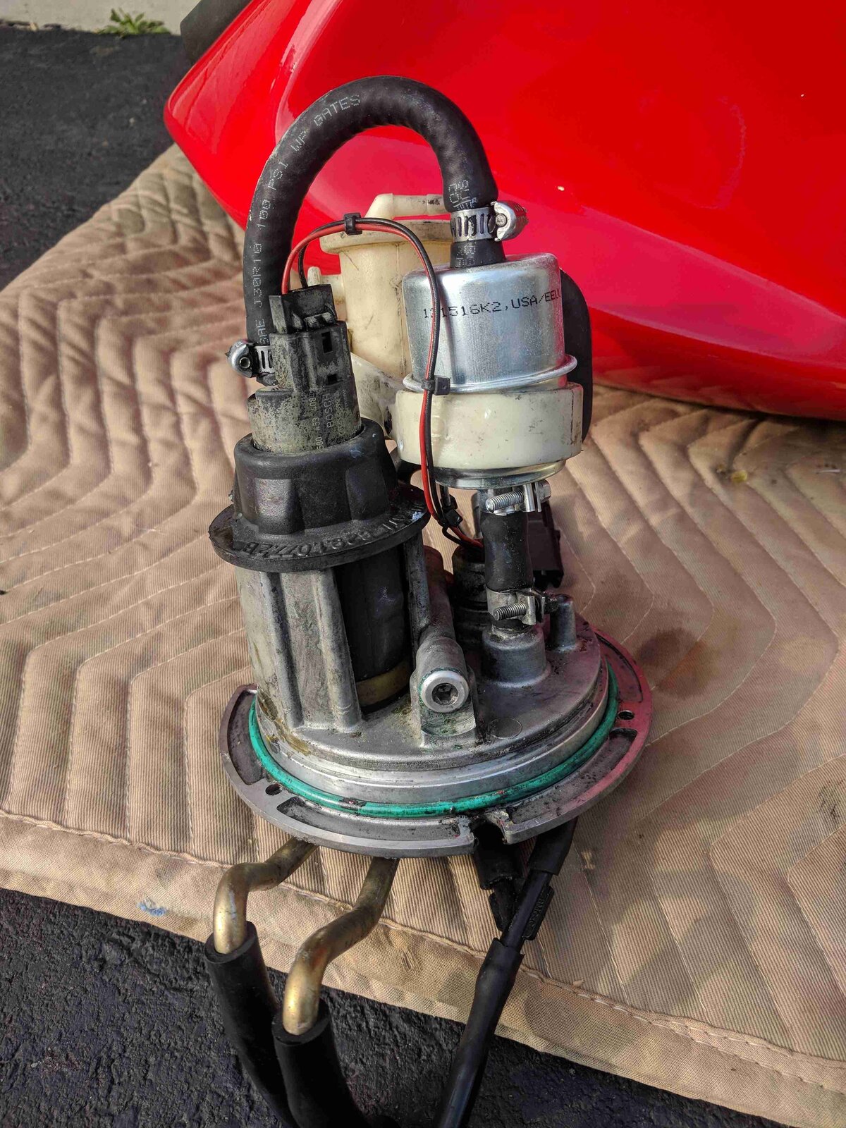

  4. Sometimes people position this green O ring in the incorrect place like this one in the photograph, it should sit slightly higher on the lip / step.

  6. Get a new o-ring, in fact get 2 or 3 in the same order, saves p&p snd you always have a spare. Make sure it’s sitting on the correct lip on the pump assembly. Grease the opening in the tank, not the rubber ring, red rubber grease or Vaseline will do. Get 3 bolts that are 10mm longer than the pump assembly bolts you took out and use them, a turn at a time, to slowly pull the assembly back into place evenly. When they bottom out swap them out for the correct length ones and tighten them up. Dont try and push the pump assembly home by hand it will only go in crooked and either dislodge the o-ring or nick it.
