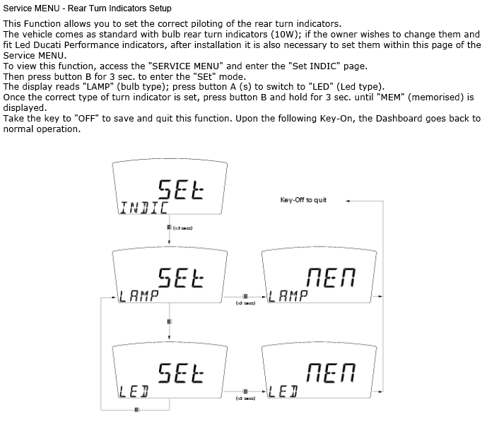

  4. The change in flash function with the engine running is almost certainly because the voltage is higher with the engine running, usually going from approx 12.5V to approx 14.5V. The Hyper has an unusual flasher arrangement where the indicator switch provides 12v to either RH or LH as selected and the ground is made by the dash which provides the flash function.
    I believe that the dash can enable LED rear flashers without the need for resistors. The pictures below show how to access the menu to enable them. Easier for me than trying to describe how. Hopefully that will give you the right flash rate.
    Screen Shot 2017-10-11 at 13.33.55.png Screen Shot 2017-10-11 at 13.35.12.png
  5. hi derek
    looking in the owners & workshop manual 2010-2012hyper 1100 evo i dont see this page, are you reffering to the pre-evo model?
  6. Sorry, you are correct. I was looking a 2008 manual. The 2010-12 one which cover the evo shows the Service menu but it doesn't include a setting for the indicators.
    I suggest then that your resistors are not the correct value to emulate the bulbs. The bulbs are rated at 10W so, using Resistance = Volts squared / Watts we get R= 14 x 14 / 10 = 19.6Ω. So a 20Ω resistor across each LED should give the correct flash rate.
