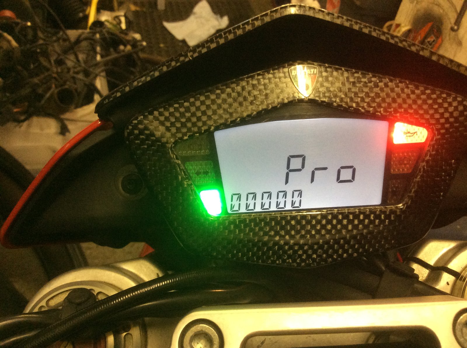

  14. Just read this thread as I’ve got working indicators on my 1100s, but no dashboard warning light? On turning on ignition the green indicator light illuminates, so I know it works, but when indicating I get nothing?
    It has Rizoma rear indicators and mirror mounted led fronts.
    Is the dash issue likely to be due to the aforementioned switch?
    If not, any ideas how to fix it?
    Goose
  15. Yep - find the hidden setting in the menu....switch it on - that should do the trick.
  16. Read the thread, found the menu' but no alternative on lamp setting and still no dash light?
  17. You have to go into the hidden service menu...
  18. I held down A and turned on the ignition, scrolled through the settings to SET indic and then held down B for 3 secs, but no other options appeared?
