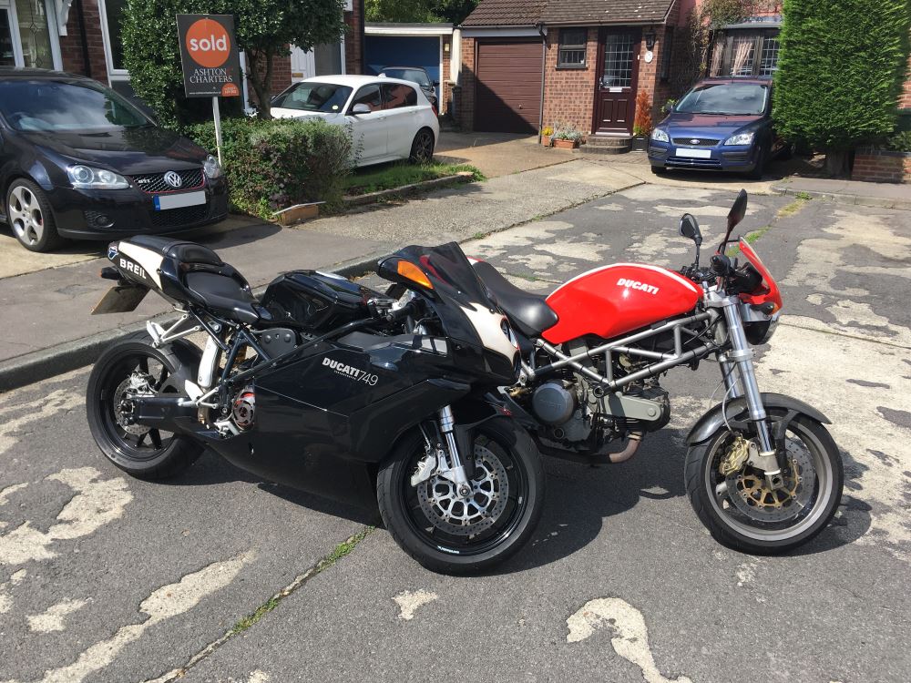

  1. Hi All. I recently purchased a beautiful 749 (shameless photo below). I'm trying to install a this tail tidy and am struggling to do a neat job with with the wiring. It's all so open so there is no hiding it, in particular the huge LED resistors to slow the flash rate. So...
    1, Is there an option to change a relay instead of resistors? My searching says no.
    2, Can anyone recommend some LED indicators with resistors built-in. Preferable not £60 :)
    Thanks All.
