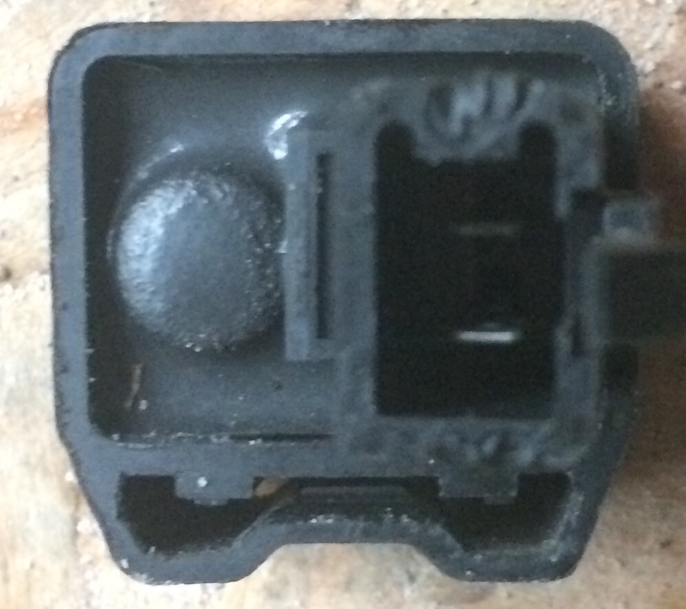

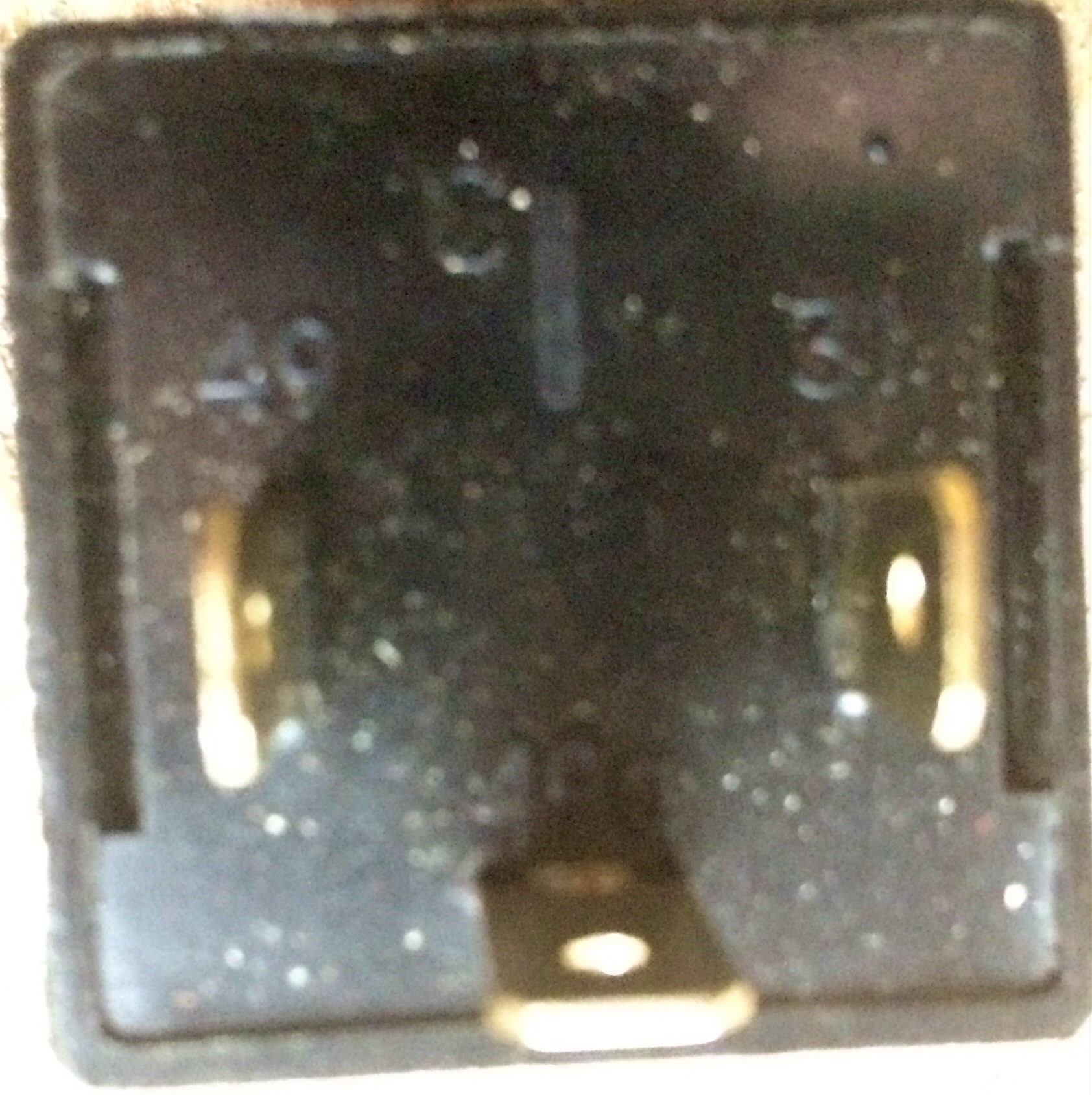

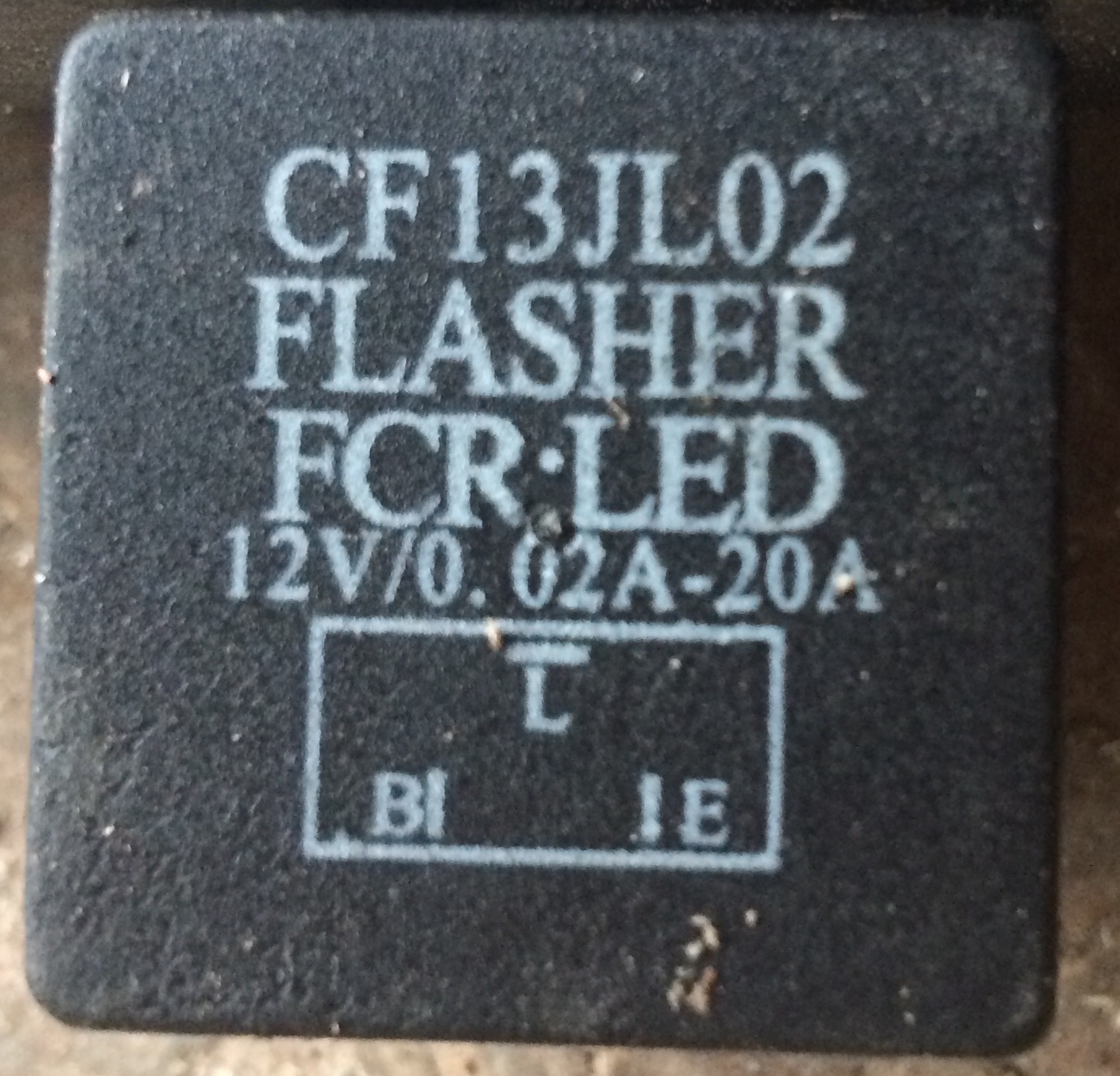

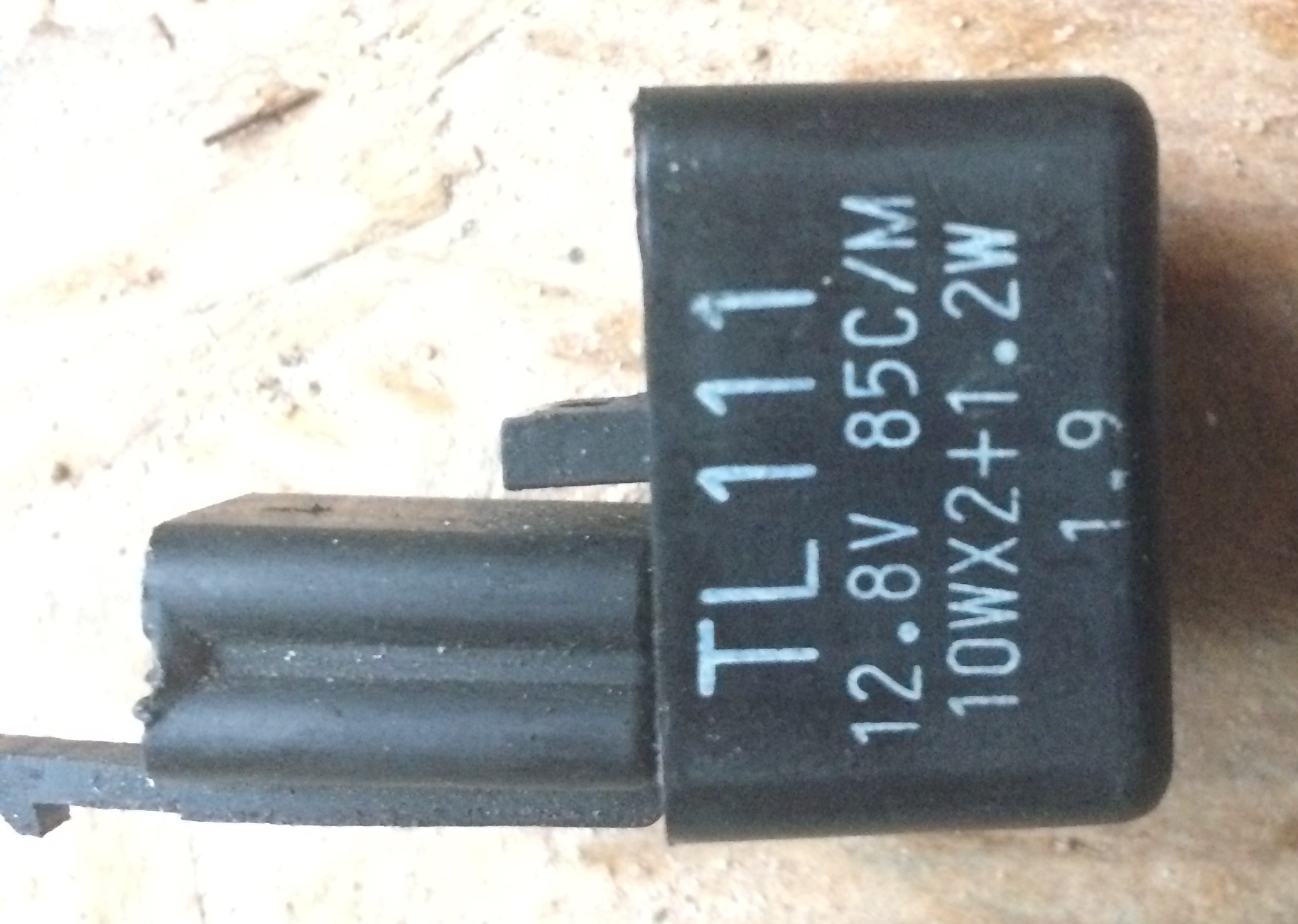

  4. Got the relay at last (from somewhere in the Far East), and now faced with 2 pin to 3 pin conversion.
    My simple view is that the third pin is just for ground connection (shown on the new relay as pin 31), with 49 connecting to incoming live and 49a out to indicator switch.
    Will upload photos once I figure how to get photos from iPhone to ipad.
    If anybody has come across this on the 748/916/996/998, and the had to do same/similar, can you confirm or correct, please (struggling to find my workshop manual, only seem to find owners manuals).

  5. Old relay
    New relay

  6. Cannot say for certain but in my experience the third wire is always a ground in all the relays I've come across.
    Its funny as usually the 3 wire type are the ones supplied now and its older bikes that had the 2 wire.
    But bollocks who cares as long as it works
    John
  7. On Japanese units the 3rd wire is usually to ground but on the European units the 3rd wire is to the warning light.
