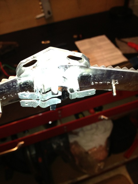

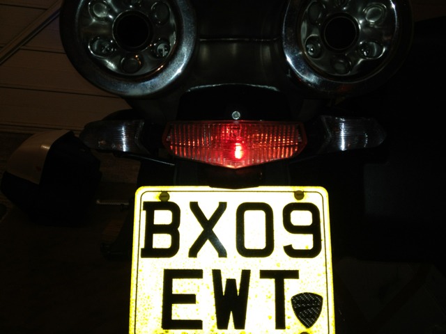

    1, the light as it was after I fitted the clear lens and red bulb. Android commented that it wasn't very bright, on our recent ride out.

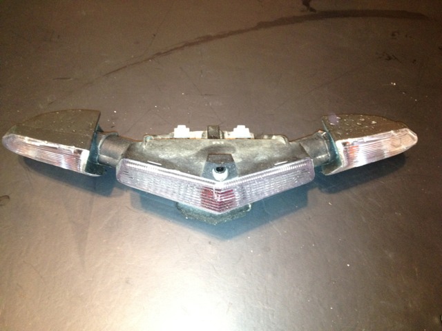

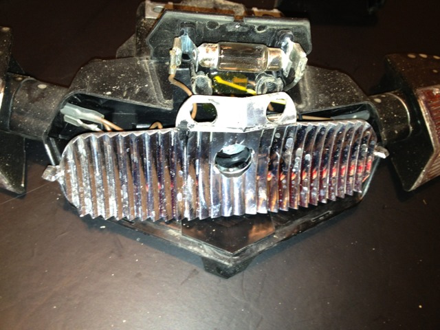

    So, I removed the rear light unit. One screw above the light and 2 under the mudguard.
    2 screws on the back and the cover comes off. I then slid off the reflector, after removing the bulb and unplugged the wires from behind.
    ImageUploadedByTapatalk1336653776.664951.jpg ImageUploadedByTapatalk1336653793.290210.jpg
    More to follow.........

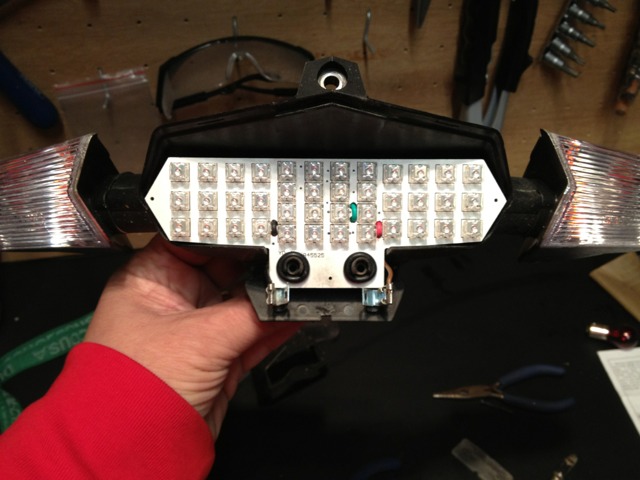

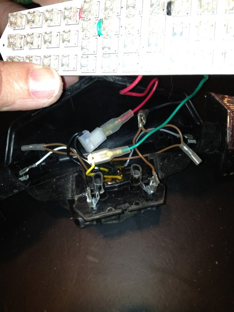

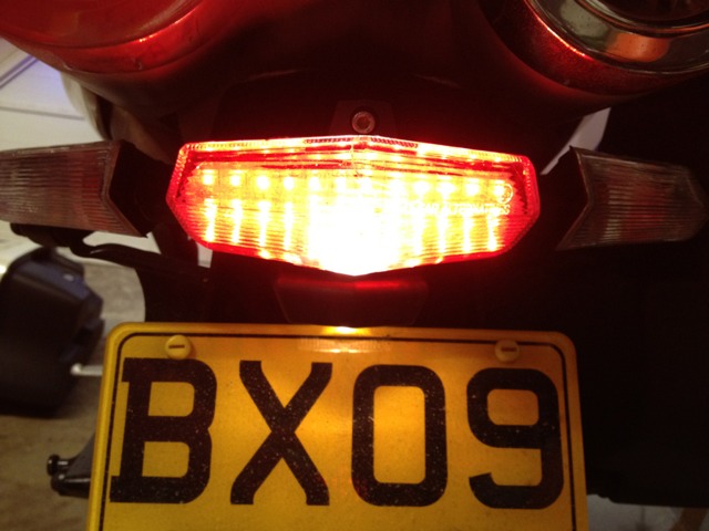

  2. I connected the wires as per the instructions
    Slid the light board onto the post where the reflector sat

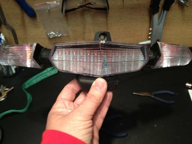

    Refitted the clear lens
    Refitted the unit to the bike and gave it a try
    The light is bright but the brake light is REALLY bright!
    Just looking for LED bulbs to replace the filament ones in the indicators now.
    Thanks for reasons and comments welcome.
