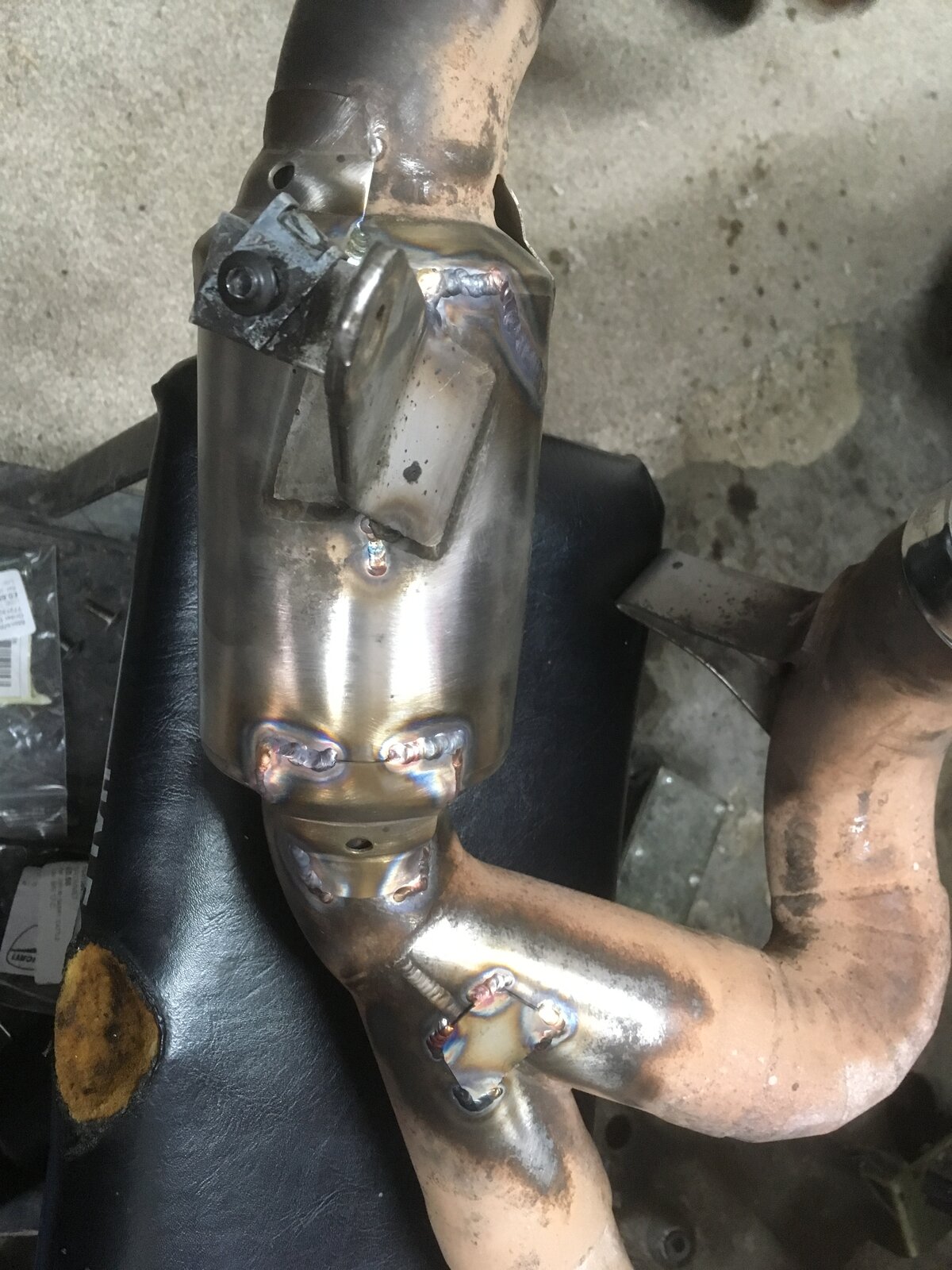

  1. Well, after the chore of cutting out the rear shock bolt out, changing all the fluids, refitting the forks after spring change & service, I started the bike up only to find the weld around the small silencer on the Leo Vince decat pipe has a cracked weld. Anyone else had this happen?

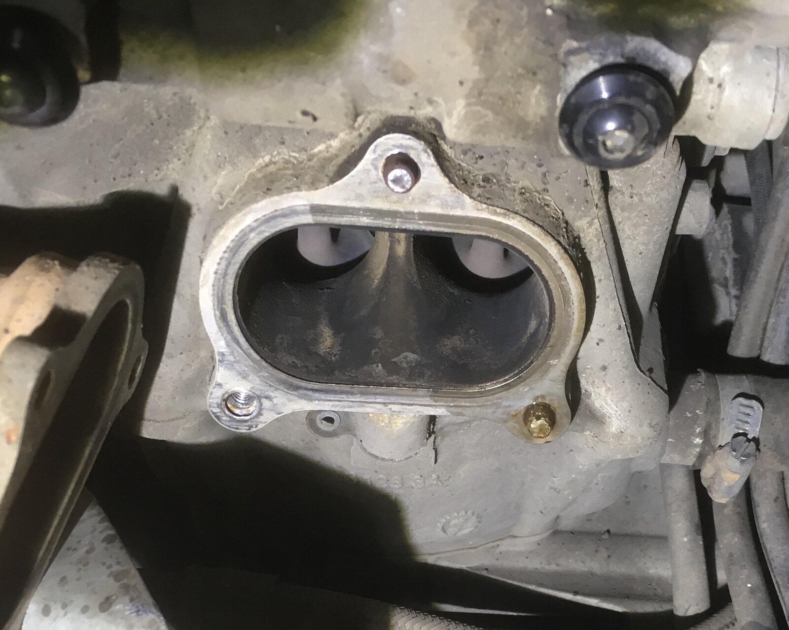

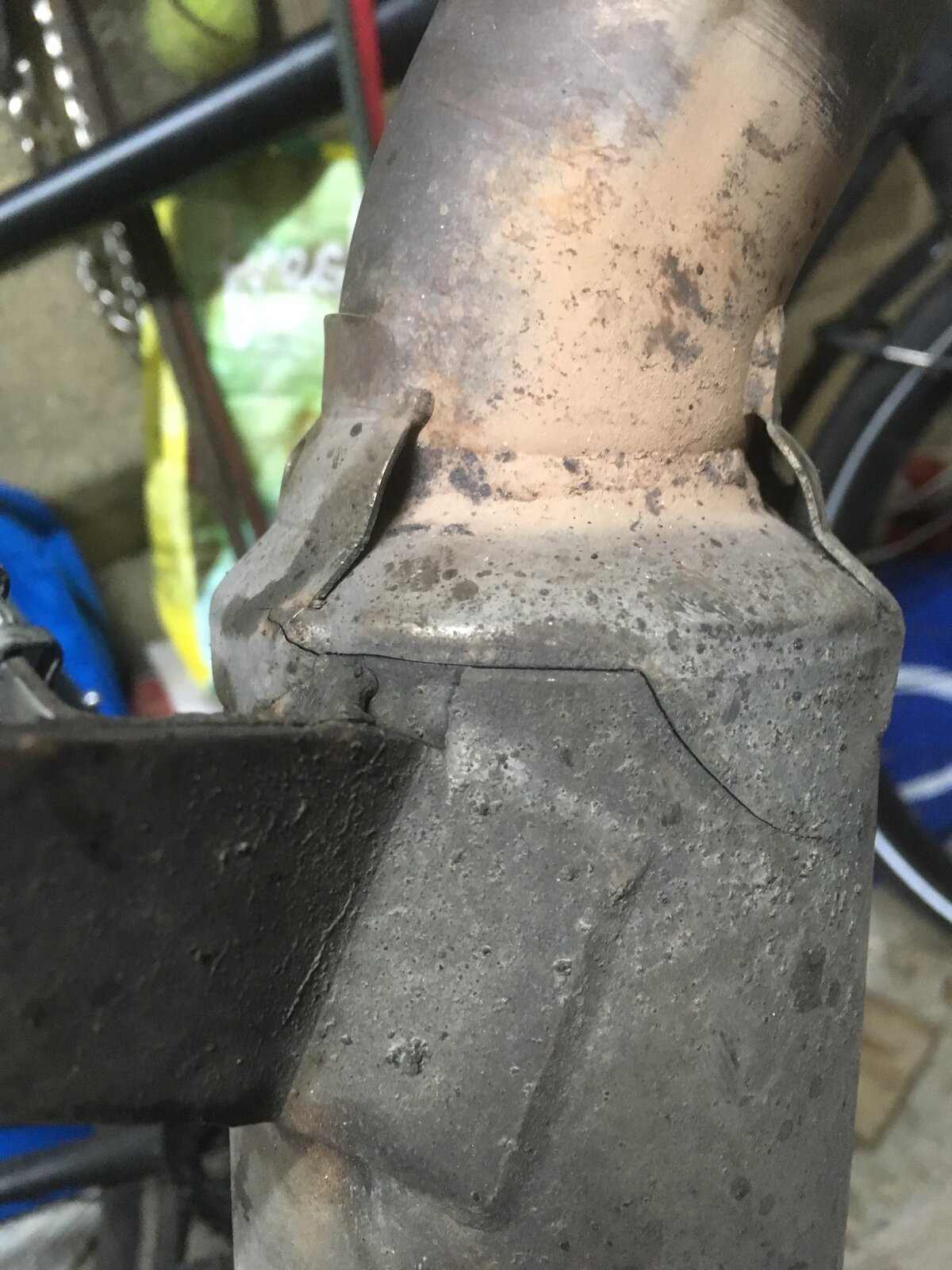

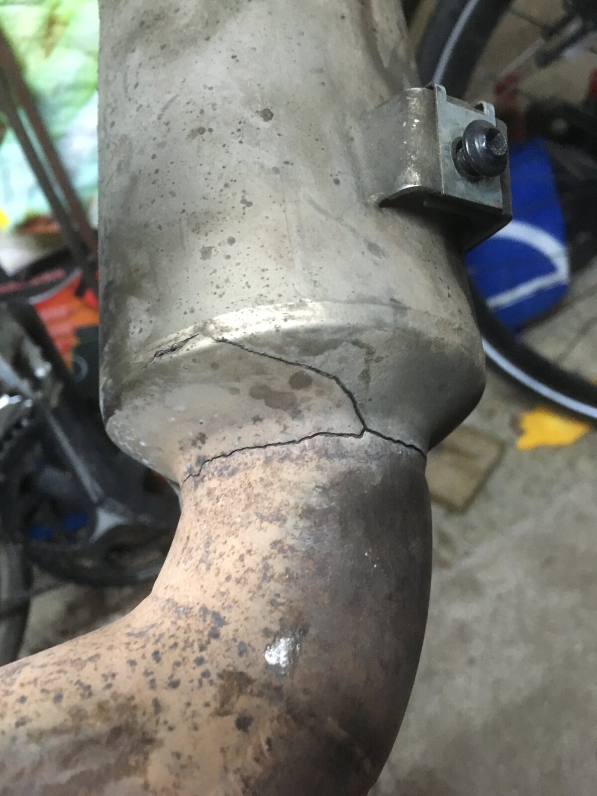

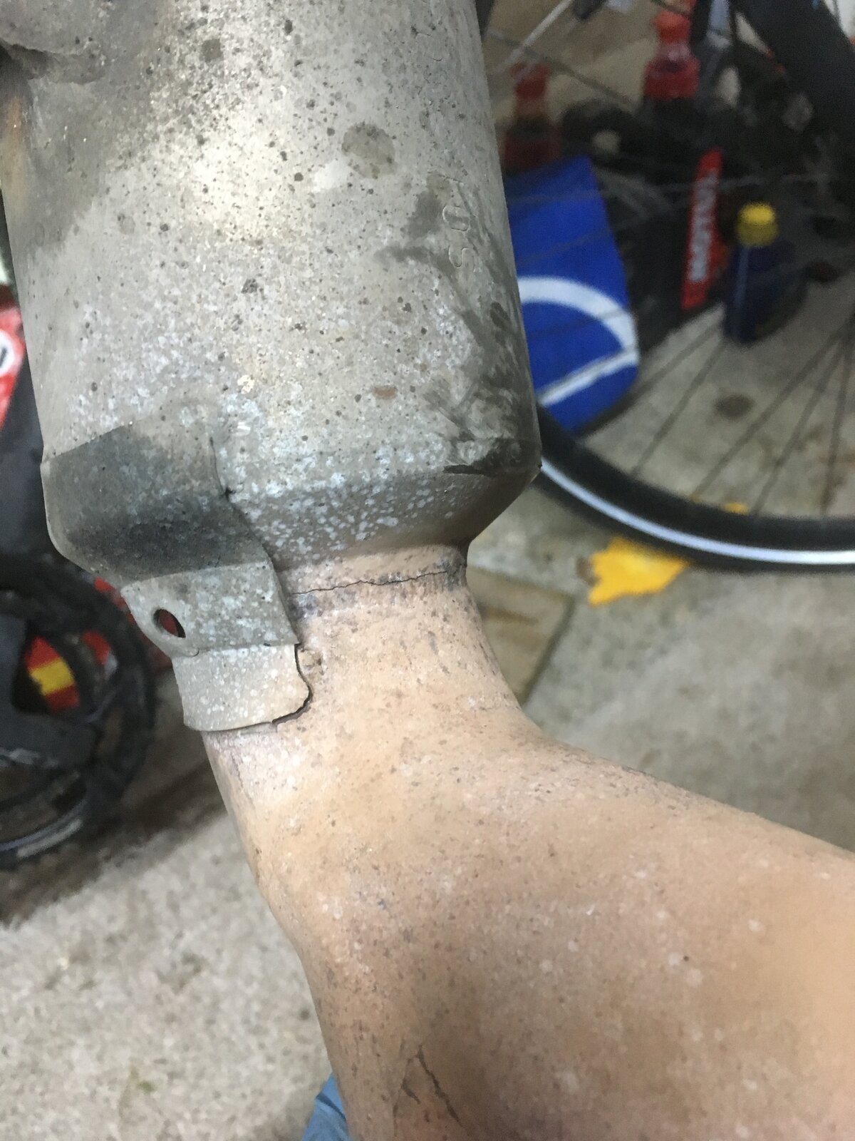

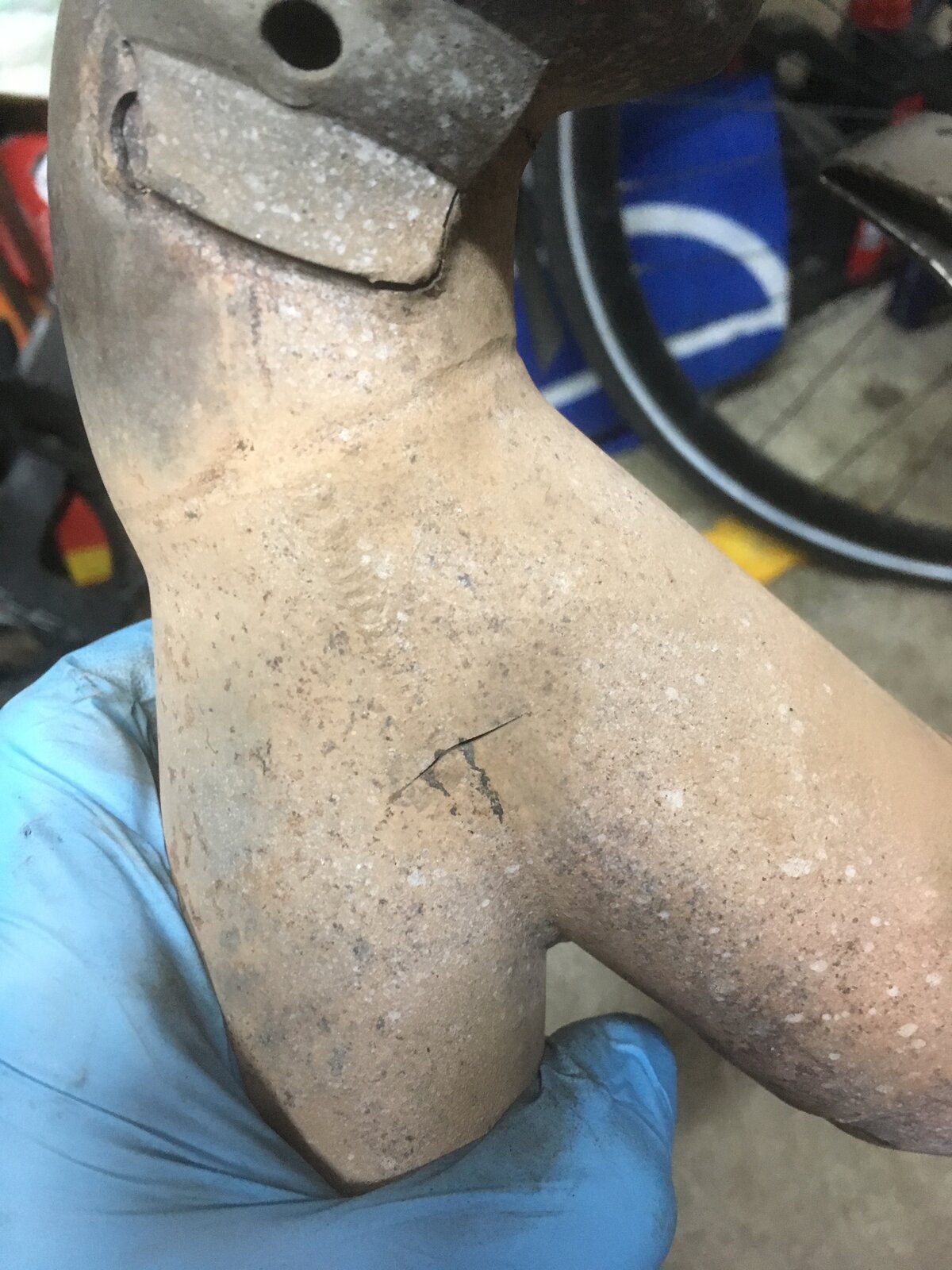

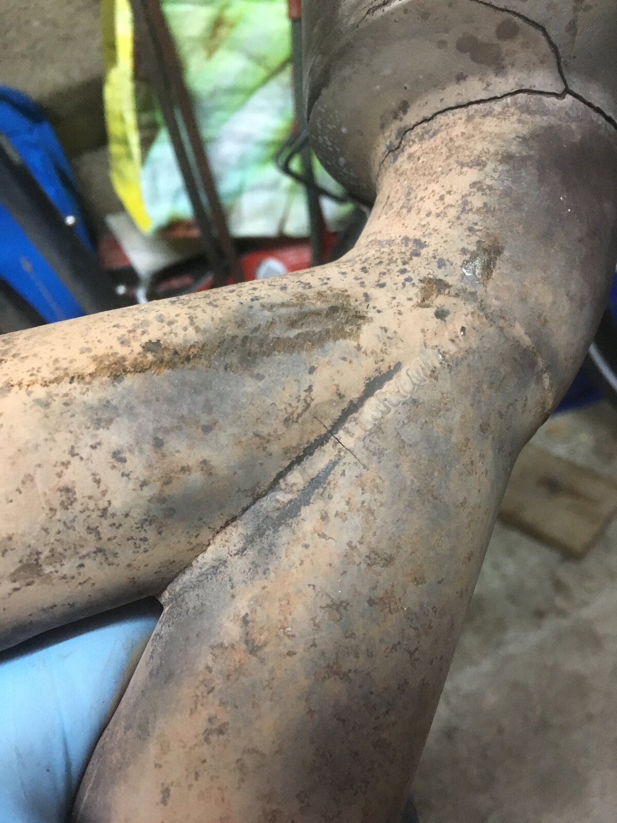

  9. 5DEB3CDE-EBFD-4D4E-87C0-ED31B88C676C.jpeg F862A001-E617-48E6-BB7E-3D40F84FE713.jpeg 72EC7209-2A2C-434D-A3DA-26D436EBE51A.jpeg C620EF38-910F-410B-9FB2-EB8325433EAE.jpeg F11FD0D1-4C84-4DF8-9D25-A347323056B4.jpeg Got the decat off to take to my mate to weld up tomorrow, more of a mess than first expected.

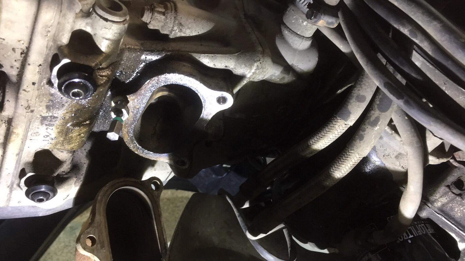

  10. But if that wasn’t enough.....
    FFS
  11. wow that exhaust is really cracked...……………………..all over!!! it must be very thin, shall have to keep an eye on mine now. Good pictures and hope you sort out your studs ok.
  12. That's a bummer mate, hope you get them out ok
  13. Potentially the stock end can whilst not that heavy , will put more pressure on the joints than the LV can that also mounts to the frame
    Had the same issue with studs - mig welded a nut on (disco the battery!) and the heat from welding helped to get it out easy peasy - good luck

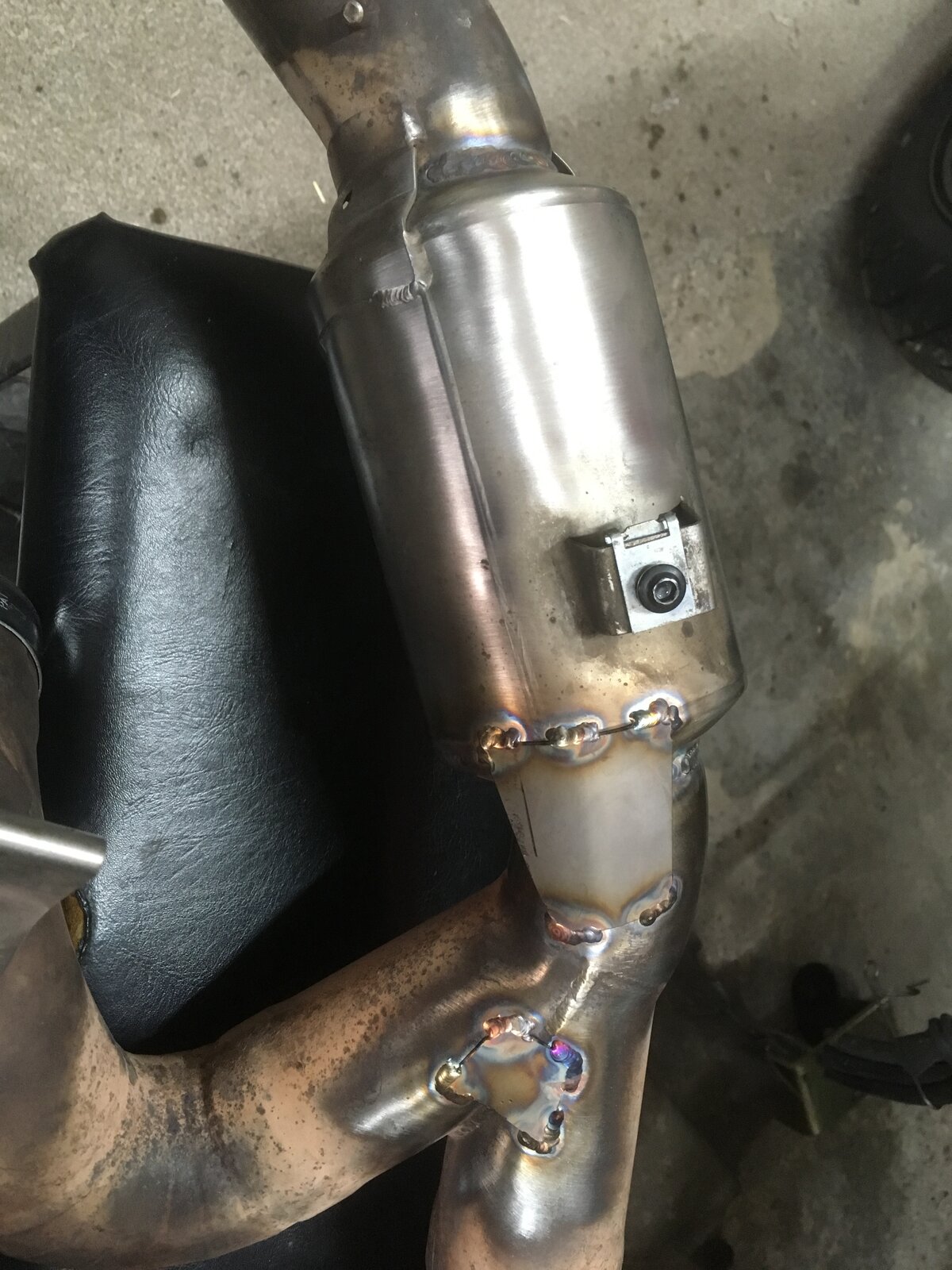

  14. 76EF7A53-D278-4C0B-AA6E-394150BD8A92.jpeg A10EDC81-E102-48C0-9583-02153A532F60.jpeg
    Mate sorted it right out. The S.S is pretty thin. I am off to Brittany beginning of next month, he is making me a new decat and and can out of something a little thicker......just need to get the studs out! :confounded:
    Got both the studs out today, drilled them and tapped a torx bit into them. Put a nut on the studs so that the torx wouldn’t break out the stud.
    Reassembly next!
  16. Don’t suppose anyone knows what the torque is for the studs themselves? I can only find the nut torque! @Derek
  17. It’s OK - found it!! 10Nm same as nuts!

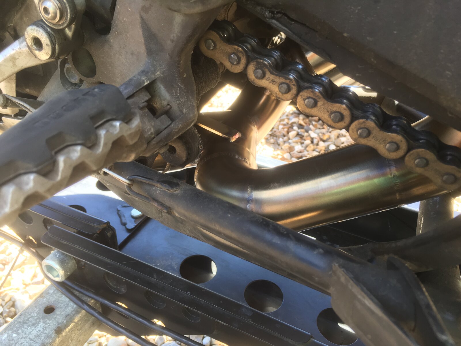

  19. Exhaust has been done, Al went with making a new decat but keeping the standard end can.
    When I dropped the bike off, it was 102dB on idle (with my phone at approx. position of track day noise test)
    With Al's phone in same place - 97dB on idle, that is quite some drop. He has said if I want it quieter, I will have to have a can change. He's now buggered off on holiday so will post pics when I visit to pick the bike up.....or have a new can made!!
  20. Best pics I can do until I take belly pans off next! Very pleased with the work.
