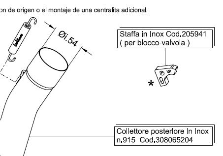

    - The LV exhaust springs were so strong I couldn't get them on. I used the stock items instead.
    The most daunting part was removal of the exhaust valve motor to fit the LV cam provided. I almost considered not touching it and doing the spring and washer trick instead. However, accessing the motor was almost the easiest part of the whole project. It really was easy peasy when you loosen the sub frame and tilt it up to allow access. The 'how to' guide was spot on.

    I'm surprised that the system didn't come with the little cam that's fitted to the exhaust valve motor. That does away with the need for the spring and washer arrangement.

    Mine came with the cam thingy, but not the supporting bracket for the exhaust can. I didn't even notice it was missing until I saw another system fitted.
