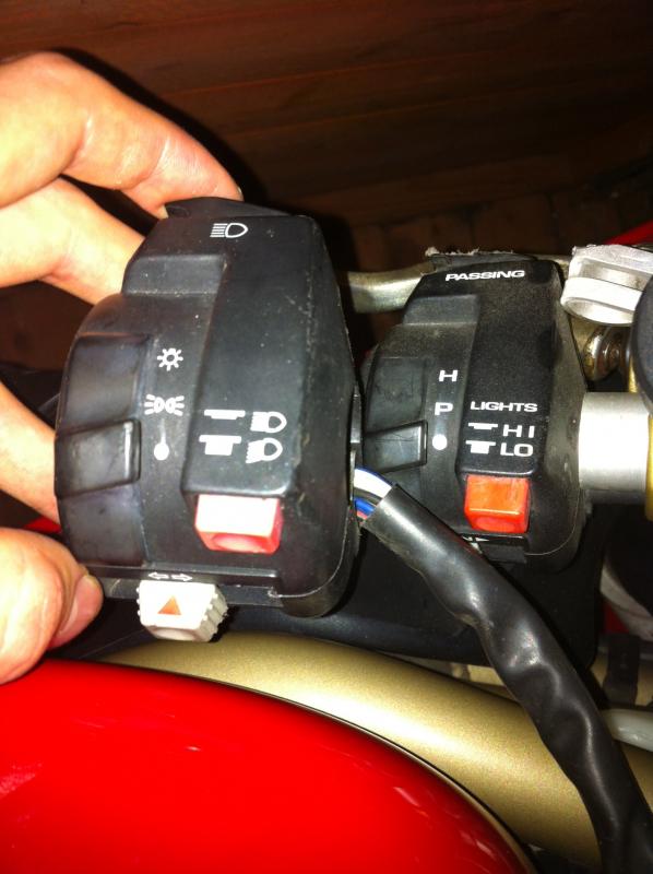

    I have the LHS switchgear on the right, as below, which is damaged. Although trying to find a replacement is proving difficult. I accidently bought the one on the left.
    Ive vey seen the one on the right only one in 6 months. Have you seen many? Is yours the same as left or right?
    A couple of Ducati dealers said the same thing, they can order it but can't guarantee which one will arrive as there is only one part number.
    Anyone ne know where I can try and get hold of one?
    (not to be mistaken with the cheap universal ones on eBay)
    Cheers
    Jeff

  2. Look American or Japanese style with the Hi and Lo
  3. ^ they are Japanese based yes, with subtle changes.
  4. Should the wiring not be the same, will I be able to transfer over my existing wiring from the damaged switch?
  5. you can definitely convert wires to suit as the quantity of wires will be the same and with luck the colours will be the same or close. If you use a meter set to resistance and some probes or paper clips on end of croc clips etc you can compare old switch with new as you switch each feature (indicators/lights/horn)
